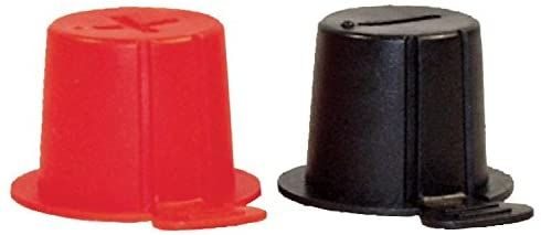

If car works with jump starter but doesn't with battery, and battery is brand new and charged, then somehow juice from the battery doesn't flow to the car. Where exactly you connect the jump pack?
You did take those things off the new battery right?

Yeah of course haha. I connected my portable charger directly on the terminals and show full voltage but have no power. When the battery jumper is on the terminals I get all power back inside and out of the vehicle and the key fob works and the car starts right up. I even took the battery charger off while the car was running and it stays running with no problems. But when I turn it off and try to start it back up all power is lost again.
