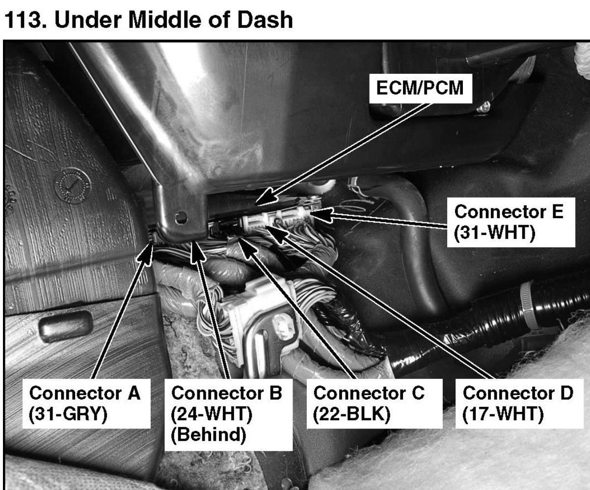

Now the interesting part is that oxygen sensor connections related to P2628 and P2631, and app sensor code P2138, all connect to ECM using the same "Connector D (17P)".
Baro code also points to something being wrong with ECM itself.

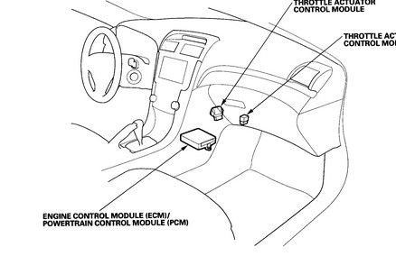

ECM is our car is located under middle of the dash. Under the HVAC unit. And since you mentioned that it's hot in the area, AC is probably running a lot. That means water, and if the tube that is supposed to route the water outside of the car gets plugged it might be possible for ECM to get wet.
Actually, on this photo, you can see a black hose on the right. Without doing any research I'm guessing that it's the hose that is supposed to route water from AC system to the outside.
Are carpets around the front of the car wet by any chance? I would start by getting to the ECM and checking for signs of water ingress. Unplug that connector D and see if it's nice and shiny. When "clearing" codes preferably use a scan tool.
