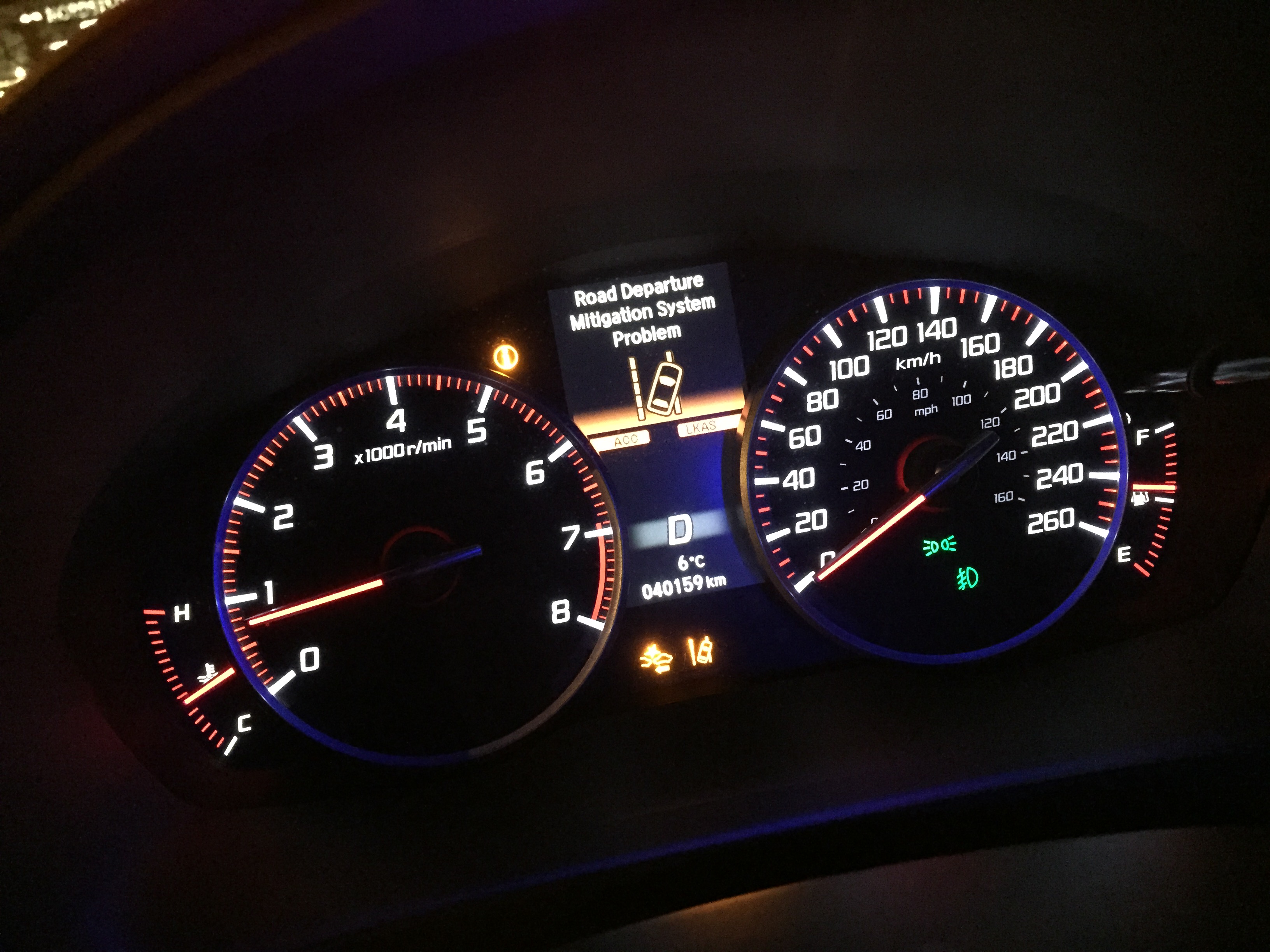

I'm having some issue's, here's the email I have sent Camco Acura in Ottawa, after several appointments.
Electrical;
On top of what's attached, I’m also getting a key fob error that I showed you at my last visit, and also a transmission failure error a few months ago that was cleared by your tech’s.
I have noticed when washing car, water runs down the doors it will unlock then relock, happens more then once!?! My 2014 Civic Si never has any of these issue’s and it uses the same tech.
-Key Fob
-Radio
-Trans
-Lane keep
-Adap. control radar
-Elec. P/S
-coll. mitigation
-road depart.
Mechanical;
-Hood loose
-Loose sunroof air deflector
-Rattle at 1,900 rpm
-Driver left side vent not clipping in
-Driver dash molding left side not clipping in.
-Valve cover fumes come in cabin when sitting at red light. (My 2012, 2013 Civic Si did the same thing. My 2014 Civic Si doesn’t do it. No smell coming in)
-Pass seat plastic cover; separating, and it is the more expensive piece that needs replacing, I have looked. molded clips deformed on that side so replacing other piece will not help, waste of time.
-HVAC blower; squeaking under 0C temps. I replaced, could not wait/fight with Dave any longer, noise was bothering me too much.
-Small pass. rear window; was getting salt creep around inside rubber seal. Will need to wait till winder again to rep.
All these issue’s I have went through with Egor on a road test last summer, so these are not new. Whether is was documented I don’t know but should have.
All in all James I’m very disappointed with Honda’s Acura division QC depart. when building this ILX. If these problems keep coming back or can’t get resolved I’ll be looking to trade this in. I have a lot of people ask me about this car, I’m now saying stay away from this ILX at least the first year of the refresh.

screenshots

I would look at your battery. It's been well known with Acuras that if your battery is running low, your electronics will start acting very strange.
There is no guarantee that is the issue, but it's cheap enough to find out (personally, I would just replace it rather than test it, as I have seen erroneous test outputs before for whatever reason, and it is cheap enough to do.)
It is fairly possible there was a defect with your battery or it was switched for some reason, or used for boosting several other cars, or whatever.

yeah I've since switched it out for a yellow top, and since then no more issues with the sensors going off. Only one electrical issue i notice at times is when washing the car it keeps locking and unlocking it's self thinking the water is my hand with a pressure washer when the keyfob is in my pocket. Odd cuz I have never seen my 2014 civic do this and it uses the same setup.
The radio on the satellite input sometimes gets stuck where it's won't load for 5-10 mins, just blank, and or all the input are blank but the station sound is coming throw, or repeats the same station title resets twice but the sound is the correct station. Before I had the turner replaced it was worse were it would have all my resets copied the same and would show ^&%$^(&*) as a name till i rebooted the radio.
I still find there to be major lag when on blutooth changing songs. My civic is crisp and fast. I see there is a new firmware update and navi update avail.

Here's the same issue returning again when there is snow/ice on the ground. Seems that when the front wheels spin too much it throws a transmission error then immediately the blind spot detection follows and turns off, they must be tired together some how. Only way to clear this is turn the car off then back on again.
