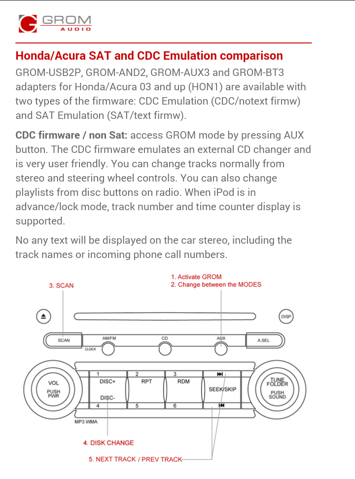

Sorry, what I meant to say is if there was a CD changer as an option then you can use that as an aux port.
Anyways, it appeares for the later acuras Grom is using the SAT port as a way to connect the Phone/Blurtooth to the radio.
Anyways, it appeares for the later acuras Grom is using the SAT port as a way to connect the Phone/Bluetooth to the radio.

Yeah this will be picky since I really don't want to give up satellite radio. Hoping I can get CDC firmware to work. I'll sacrifice Album/Track names on my screen for that.
