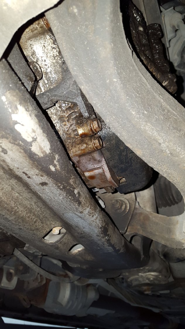

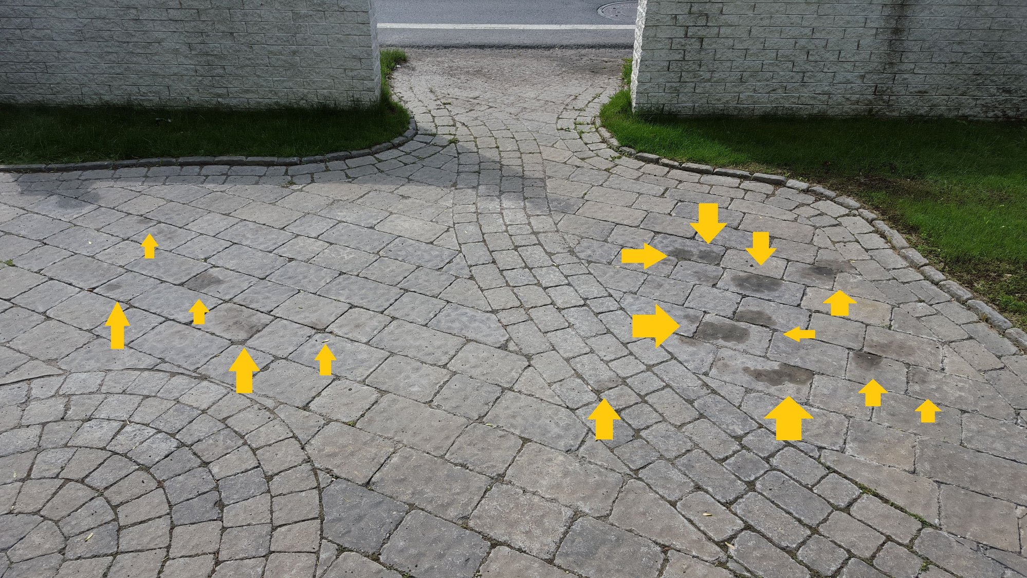

Hey Acurazine, so ever since purchasing my TL 2004 5.5 months ago, I've found that it leaks from the engine, the power steering and the transmission. Needless to say, I've been driving it for this long ever since I found out about the leak. Every day when I check my drive way, I see that it drips one toonie sized drop from the power steering, a slightly bigger drip spot for the engine and a loonie sized drop from the transmission.
I've tried ATP stop leak, I've tried STP stop leak and I've tried Lucas stop leak for all the leaks and nothing helps it. It always just keeps dripping when it sits on my drive way.

Keep in mind, I check my fluid levels for everything like 1-2 bi weekly and so far the rate of the drops haven't been bad to the point that I have to fill it up like every week. I probably have to add a little fluid for my engine and transmission like once a month or so. The power steering I have to add like every two weeks or so.

It wont last 2 years with those leaks, they will keep getting worse until properly fixed. If you can swap the engine/tranny yourself or have a mechanic that will do it for you for cheap that may be your best bet. And 250xxx kms on this car is nothing if maintained properly. I have 215xxx kms on mine and it drives perfect but I'm also very anal when it comes to my TL.

Agreed. I also bought a 2005 TL 3 years ago. At first, it was perfect, then it started leaking all over. Power steering, engine, transmission mainly. But like Sickest, i'm very protective of my car and want to last it a long time. At some point this summer, my leaks were so bad, they were not toonie size but more bank note size if not more. You can see the pictures below, it was quite aweful and my parents were going berzerk with all those oil spots all over the stone paving and not knowing how to get rid of the oil spots.
If you have the motivation and want to save a lot of money, check it yourself. In my case, the power steering leak was air bubbles forming in the reservoir and making my fluid overflow a tiny bit. The fix was a new O-Ring. The engine was in fact my oil pan, because a stupid mechanic used an air gun to tighten the drain plug, I fixed it myself, bought a new oil pan and installed in at those car lift rental places, in total, cost me about 200$. My transmission was a bad shifter seal, that was the only thing i didnt fix because it was still under warranty by the shop that rebuilt my transmission.
Whether you keep the car or not for the next few years, you should fix all that. And also if you sell the car, they will see all those leaks and you might lose buyers or a lot of value in the car, if you think of it, if you don't bother fixing 3 obvious leaks, what assures your buyer you took good care of the rest of the car?

The actual seal is a couple bucks...not expensive, but to replace it, you have to drain transmission, so add an ATF refill as well.

I have no idea what they quoted you for but its not a shifter seal. Its actually quite easy to do, just remove driver wheel and there are a few bolts to remove, then pierce seal, let tranny drain, clean, install new seal, fill tranny and re-install everything else. 45 minutes max, about 50$ for the seal and oil.

They quoted him the rear main seal. You have to pull the tranny for that and it is quite labor intensive.
