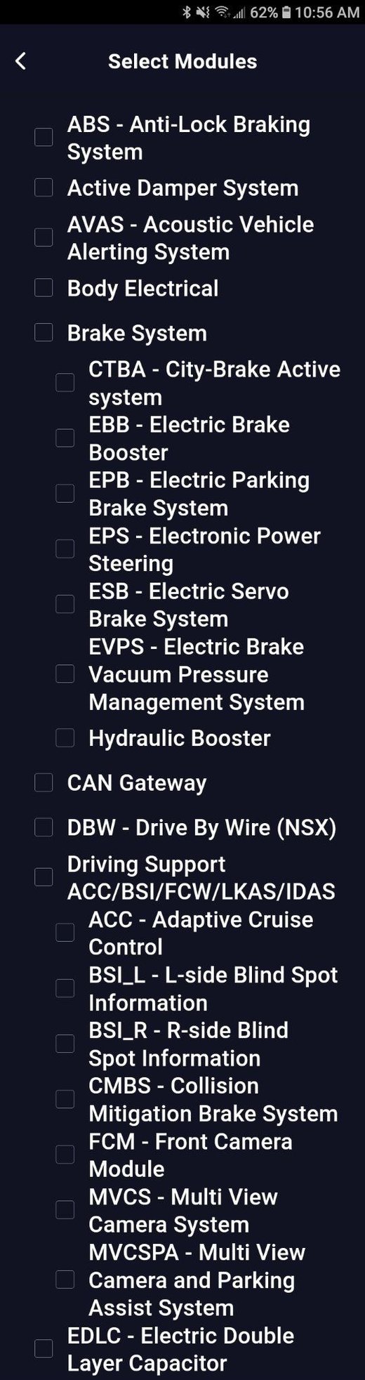

I bought one of these at Wally World. Not bad for $50.. How much deep intrinsic troubleshooting do you need to do on a Acura TL anyway? haha
It does live data, all troublecodes, SRS and tire pressure guages and a lot more.

The question is does it read all systems in Acura (what I doubt). Otherwise there are BT, Wifi scanners available per 5$.

If you want something that does "everything" you will not find it for $50. But I would think you are lucky to get ANY live data for only $50. The famous BLUE Scan tool is like $100

But this Little BT scanner is OBD2 and is also good for ALL cars.. Like my moms Lexus. And no cables!! and connects to phone or tablet. So easy a caveman can do it.
There are more screens than this.. Did you say you want custom scans and live data??? For only $50 it will be hard to beat this..
HOME SCREEN
HOME SCREEN 2
QUICK ENGINE SCAN
CUSTOM SCAN OPTIONS
LIVE DATA SCAN OPTIONS
LIVE DATA EXAMPLE
SAME LIVE DATA but GRAPHED OUT

I would divide the scan tools to those 4 groups:
1. https://www.ebay.com/itm/25254723200...Bk9SR9KlgLyBYg
$5 with free shipping. It will be more limited than your dongle, but will still read engine codes and engine live data. No additional modules tho, just PCM/ECM.
2. Dongles capable of scanning multiple modules, like yours, or bluedriver.
3. Bi-directional scan tools - those not only scan all available modules but also allow to control certain things - like for example actuate the purge valve. Cheapest way to get them used or the ~$700-800 tablet scanner from harbor freight etc. Sometimes they do as much as the HDS can. Sometimes they might struggle with programming keys. Usually they don't work that well with European cars.
4. Actual OEM scan tools, like HDS.

Most recent purchase - I needed wi-fi one. Use it with Torque Pro.
1$=~4,2 zł
It does not give info about TPMS, SRS - that is why I asked about it
Almost all of those are the same - just the label and price is changing.
