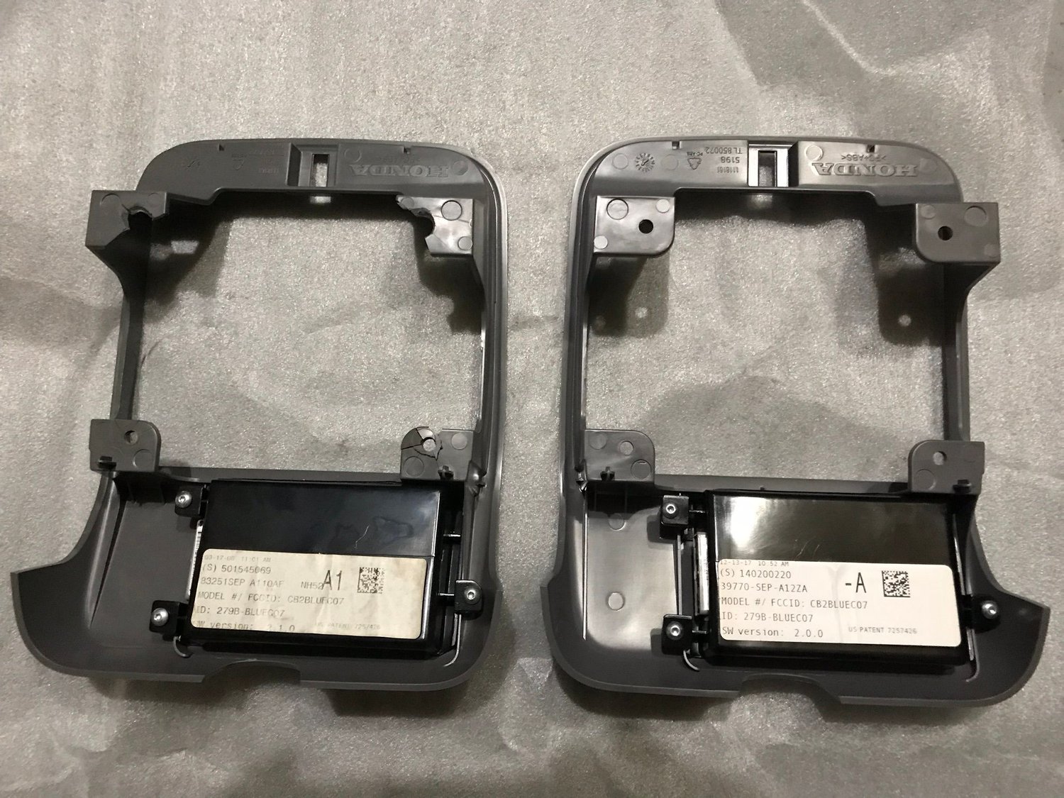

Hopefully they fix the HFL issue since I replaced all 3 of my TL, the original one lasted since the car was new to 8 years 95k miles. The other 2 unit already death when I bought the car, including my 08 which as 48k miles. To check and see your HFL status scroll through the option until it reach HFL menu then click selected, if it said "booting up" then its r.i.p
AS you can see they change the version of of the HFL hopefully they fix the issue.
