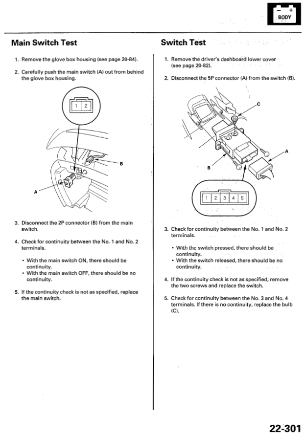

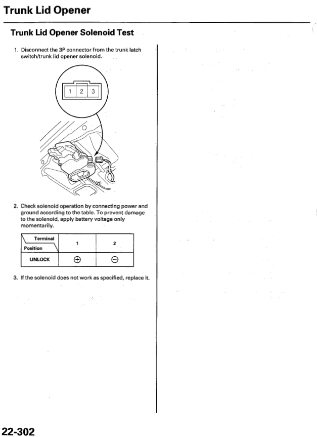

"Hi. Please help. . I have an 05acuratl. Theinstrument clustershows trunk open but trunk is closed. I just bought the car and thetrunk latchwas broke when i got the car so i Just installed new oem acuratrunk latch.Trunk lightis off. All buttons for opening trunk function fine. I disconnectedtrunk lightjust to see if light on dash for the trunk goes out .Still on...I disconnected thetrunk latchconnection and still on. I'm kinda stumped

You don't need to create a new thread for the same question.
Test these:

My latch and fob and trunk opener work fine. Brand new latch as well. Problem is trunk is closed but on mid shows open

So I gather you have not tested them?

I honestly haven't. I had figured since they worked I had assumed they were ok

that would be a negatory sir...
I'd test per the service manual.

Ok. I'll test the items per service manual. ...thanks. ...keeping car lol despite the open trunk indicator on mid
