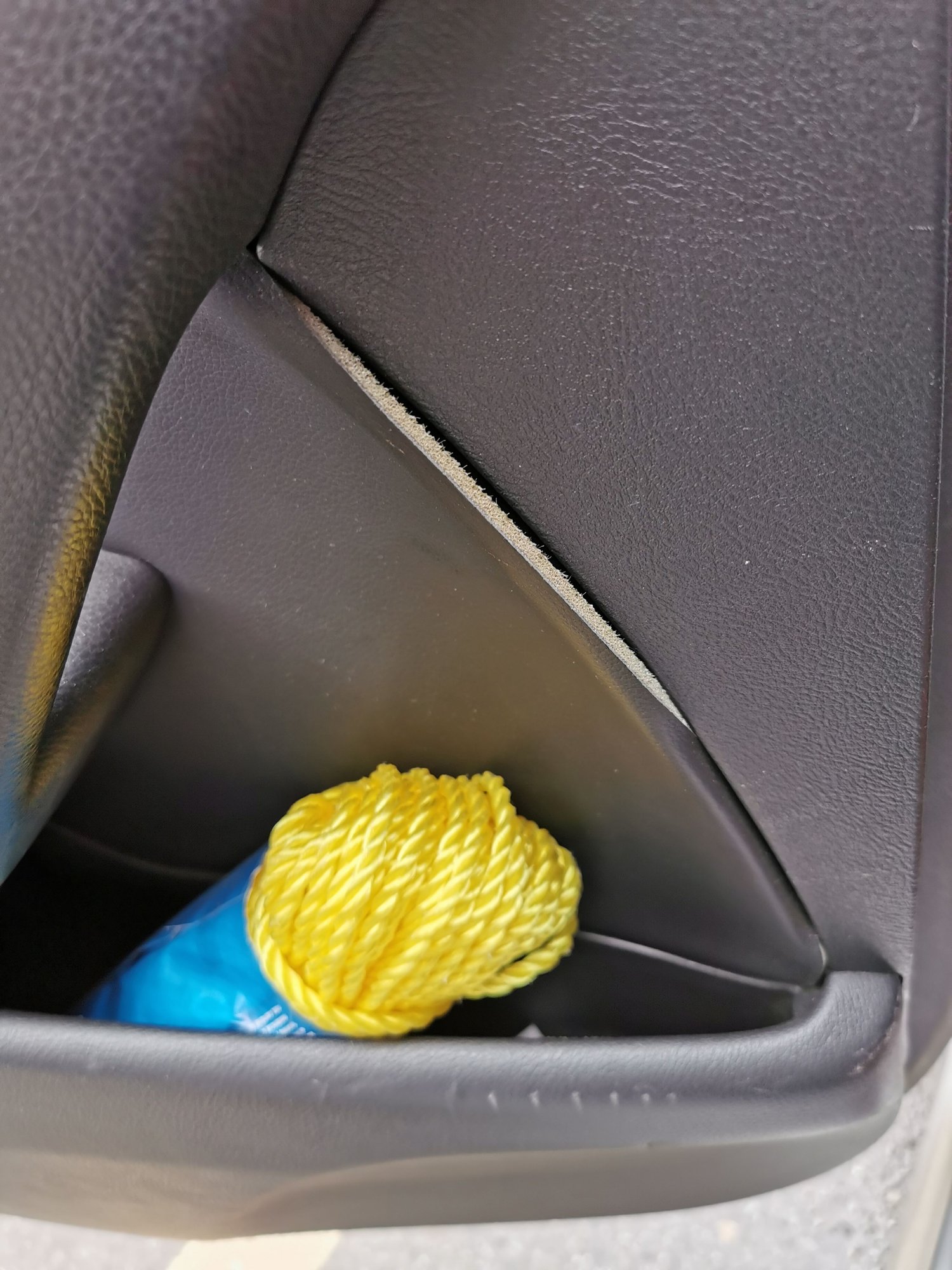

I have a 2007 Acura TL Type-S with 213,XXX kms on it, mechanically sound. Exterior is a bit rough though, but that's fine. Lately, I've been getting annoyed about the stitched leather insert on the doors; they have started peeling out of the panel they fit into. I've attached pictures.
Obviously tucking then back in is only a temporary solution as eventually they loosen up again. Is there an effective way to fix this? Can I just super glue it back in or something, as crude as that sounds?
Another view of the front driver's door
Front driver's door
Rear left passenger's door
Any feedback would be appreciated. Thanks! ☺️

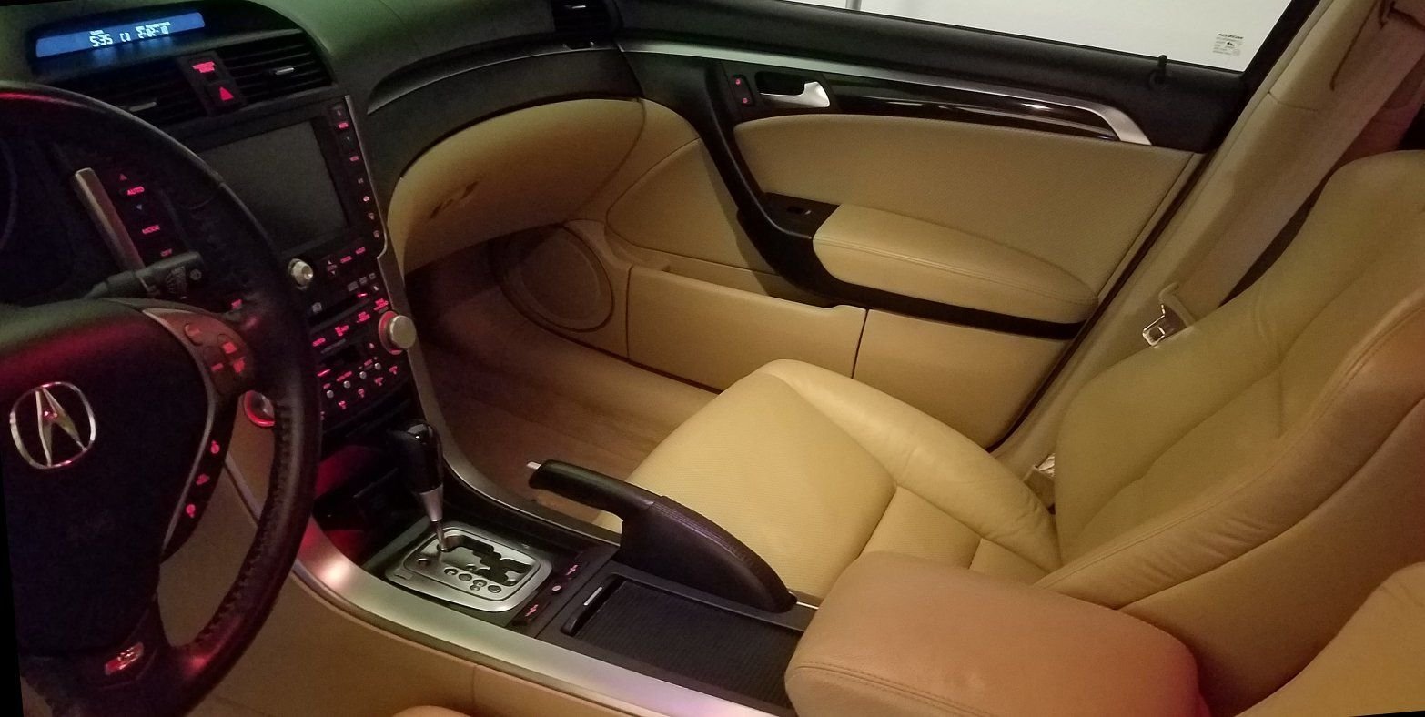

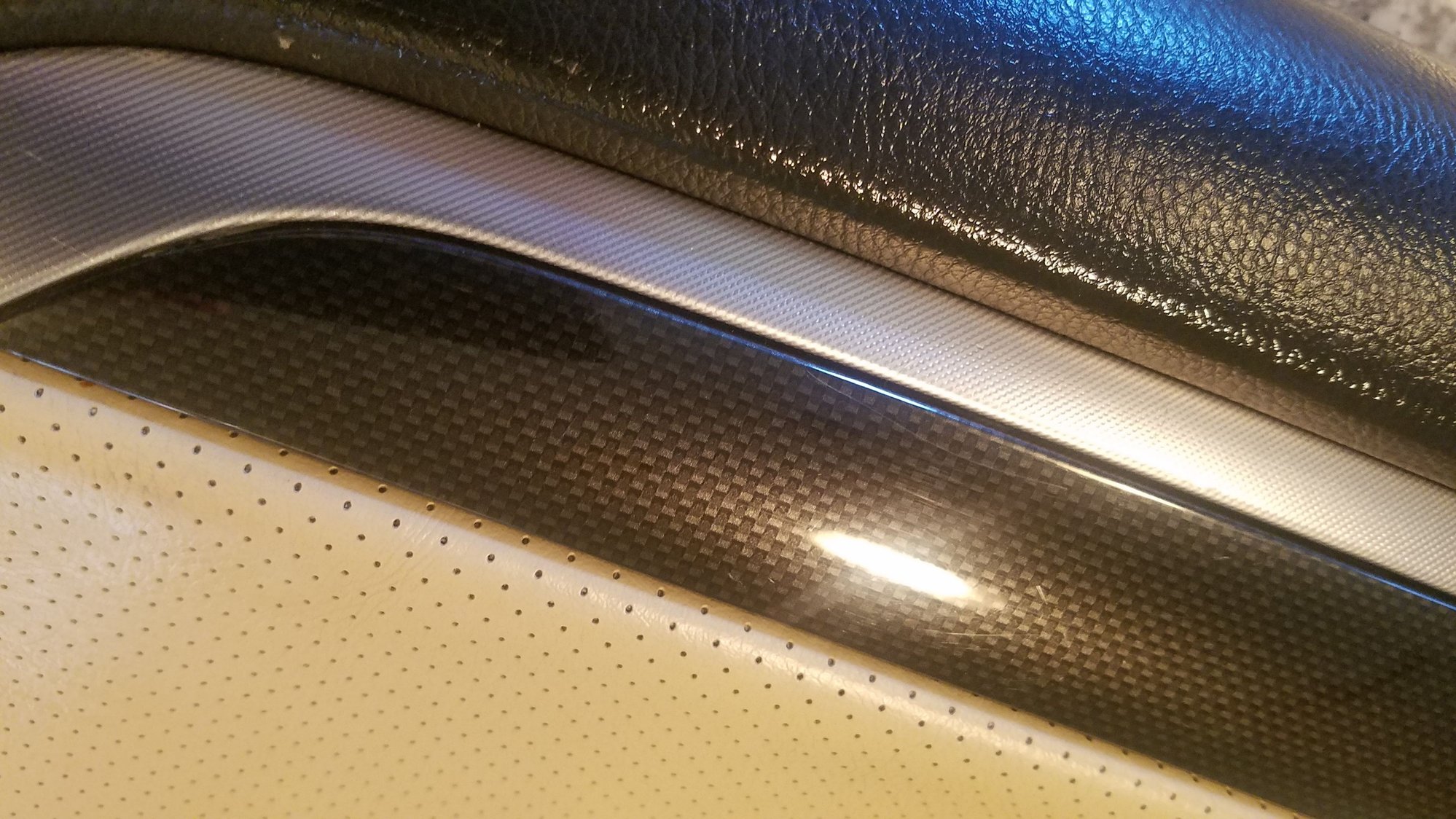

I just installed some new Black carbon fiber inserts in my door panels. And polished them up with Mcguairs..
Old Nov 23, 2019 | 08:31 PM
GhostTL09's Avatar
Joined: Mar 2014
Posts: 2,172
Likes: 863
From: Georgia
Clean interior
