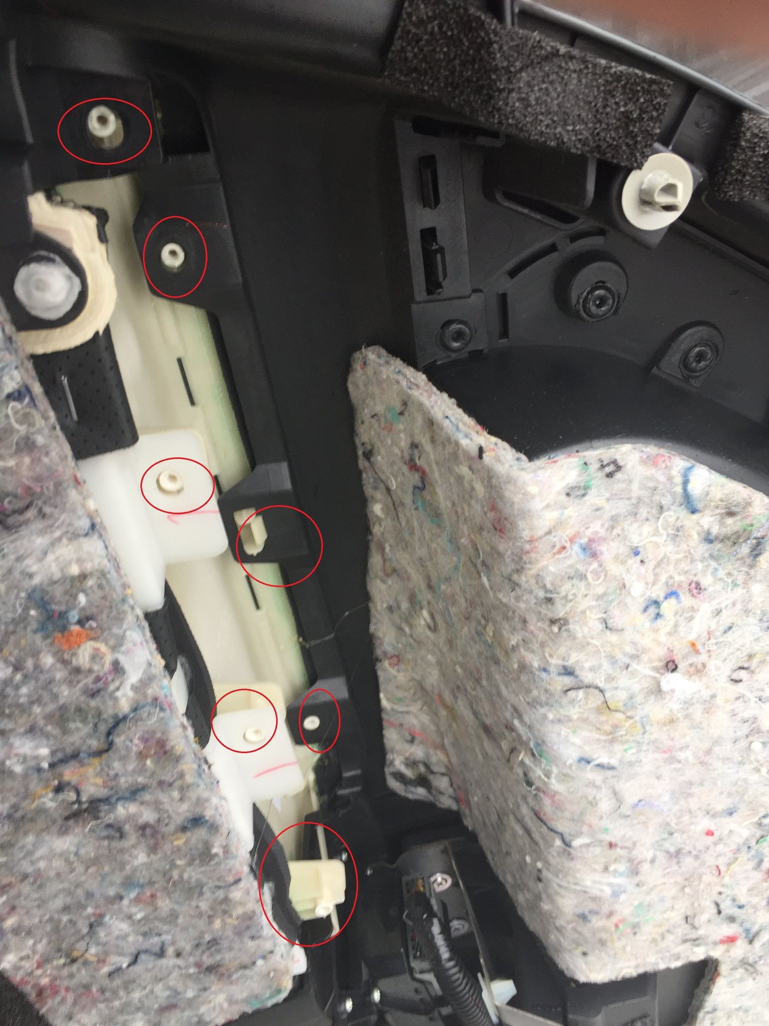

There are 6 screws and a clip holding the armrest on:
You'll notice on mine, one of the clips was broken, not sure why.
Unscrew the 6 screws, theyre all the same length, then undo the clip and slide out the armrest. Tada.

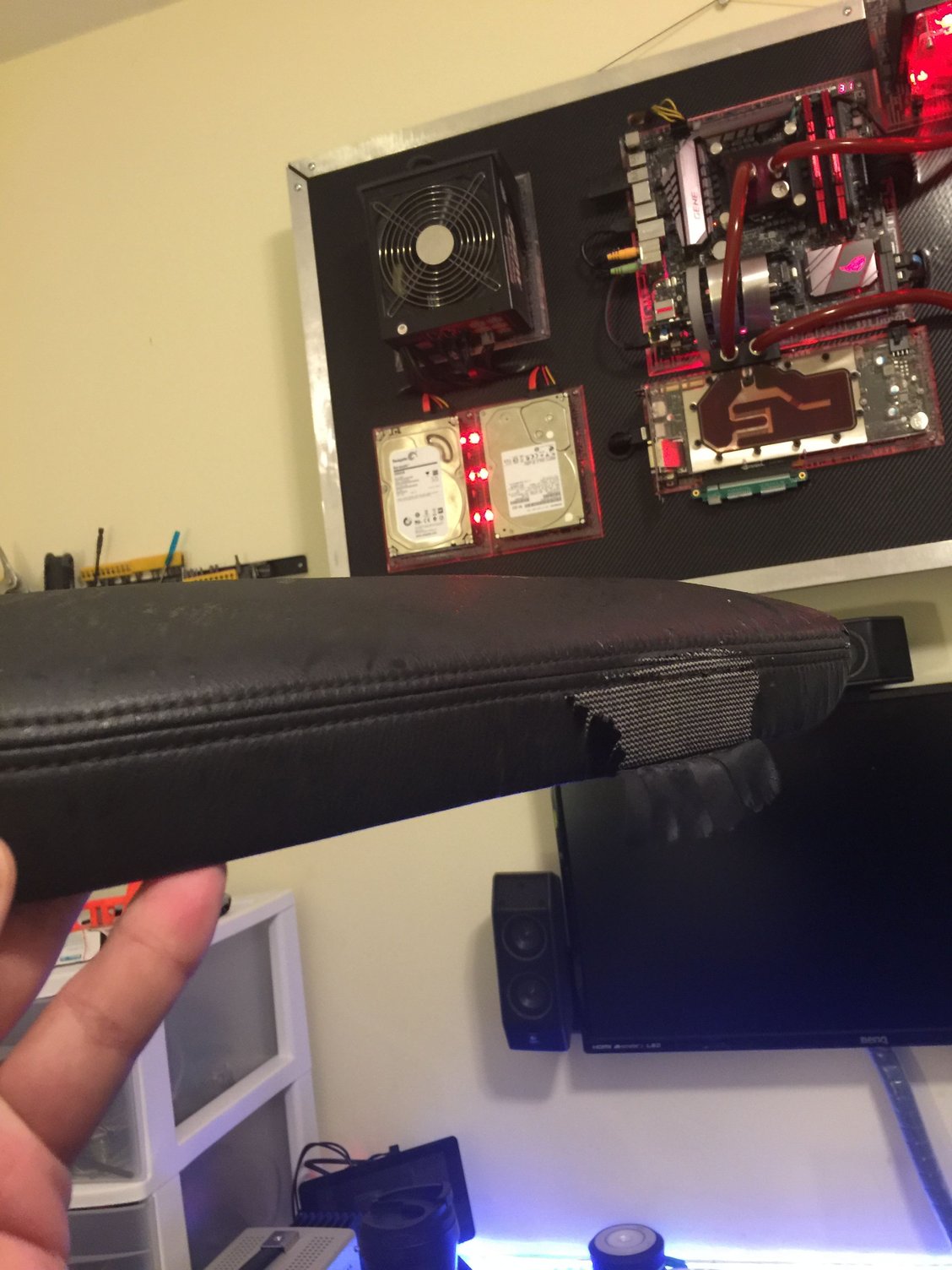

This was the armrest after being removed from the car:
As you can see, vinyl ripped and torn, bubbling like mad. Pull it all off, it literally just peels from the fabric/foam substrate below.
Do not remove the old stitching, there's no reason to, you won't be able to see it anyways. BE CAREFUL, when youre pulling near the edges, the foam and fabric are just held on with some crappy adhesive and will come off quite easily, some of mine tried to peel but I just glued it back on with a small amount of hot glue, the reason being is that this stuff is where I used contact cement later on. You should be left with this:
