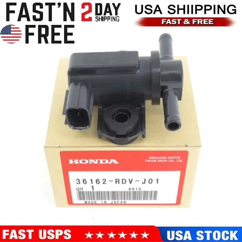

If you compare the picture from the Ebay seller to this Acura parts website it looks the Ebay seller is using the Acura parts website picture.
Genuine OEM Acura - Purge Control Valve Part# 36162-RDV-J01 | Acura Parts For Less
OEM Vapor Canister Purge Solenoid Valve 36162-RDV-J01 for HONDA ACCORD Acura TL - Picture 1 of 5
OEM Vapor Canister Purge Solenoid Valve 36162-RDV-J01 for HONDA ACCORD Acura TL | eBay

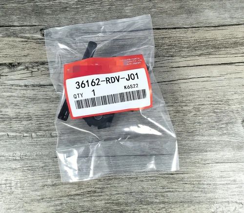

This is definitely a counterfeit: Looks like the sticker was printed at home from the seller's computer.
OEM Vapor Canister Purge Solenoid Valve 36162-RDV-J01 for HONDA ACCORD Acura TL - Picture 1 of 2
The reviews say its an original OEM. and works good. Who writes these reviews the seller's friends?
