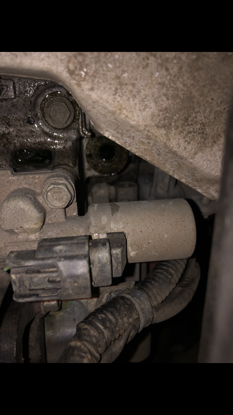

Old Aug 27, 2020 | 08:19 PM
Fabianl920's Avatar
Joined: Aug 2020
Posts: 11
Coolant leak
Recently my car started leaking coolant and I found the source to be this black hole in the picture above. It is on the driver side near the battery under the car, close to the front left tire. Is this missing a bolt or any idea why it might be leaking from here?
Old Aug 27, 2020 | 08:24 PM
Posts: 48,313
That's the transmission.. there shouldn't be any coolant around there. Check ATF warmer lines
Old Aug 28, 2020 | 03:59 PM
redbeard1's Avatar
Joined: Oct 2016
Posts: 379
Likes: 102
Other posters have mentioned that hole (see link below). I think the leak is higher and collecting in that hole making you think it is the source.
https://acurazine.com/forums/3g-tl-p...sensor-982536/
