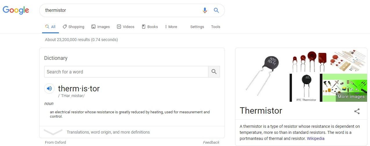

Pretty sure it actually is a transistor. A thermistor is usually more for temperature detection/control, not for adjusting the amount of power being delivered to a circuit.

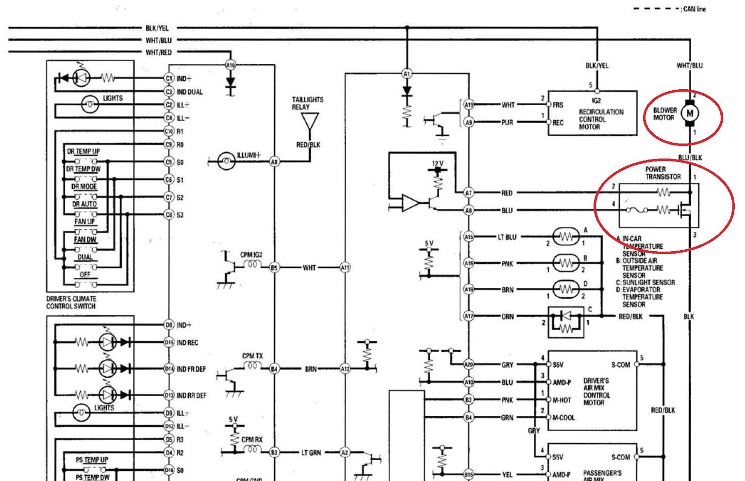

Just like Jackass wrote:
And this is taken right from climate control diagram:
Transistor is like a switch. Kinda like a relay, just it's solid state, not mechanical. It turns ON and OFF very quickly (probably above 100,000 times a second) and that's how it regulates amount of energy going into the blower motor, therefore regulating the speed.
Some stores label it as resistor, simply because in some systems there is a actual resistor. Just not the case of our cars. Most often you can find resistor when car has simple 0-1-2-3-4 speed regulation.
And coming back to the thread - in this case I would back-probe the blower motor plug, and connect it to some lightbulb... let's say 15W 12V. If lightbulb is bright and blower motor doesn't turn, and you can change brightness by changing the fan speed, then replace blower motor. If you still not sure, then disconnect the motor and connect stronger light bulb (35W? 55W?) and recheck.
If lightbulb doesn't lit and motor doesn't run, then most likely transistor. In case of our cars I could try putting an oscilloscope at pin #4 of the transistor to check if it receives command signal from the computer, and if blower motor has good power. Or for example remove transistor and jump pin #1 and #3 and check if blower will run at full speed without problems.

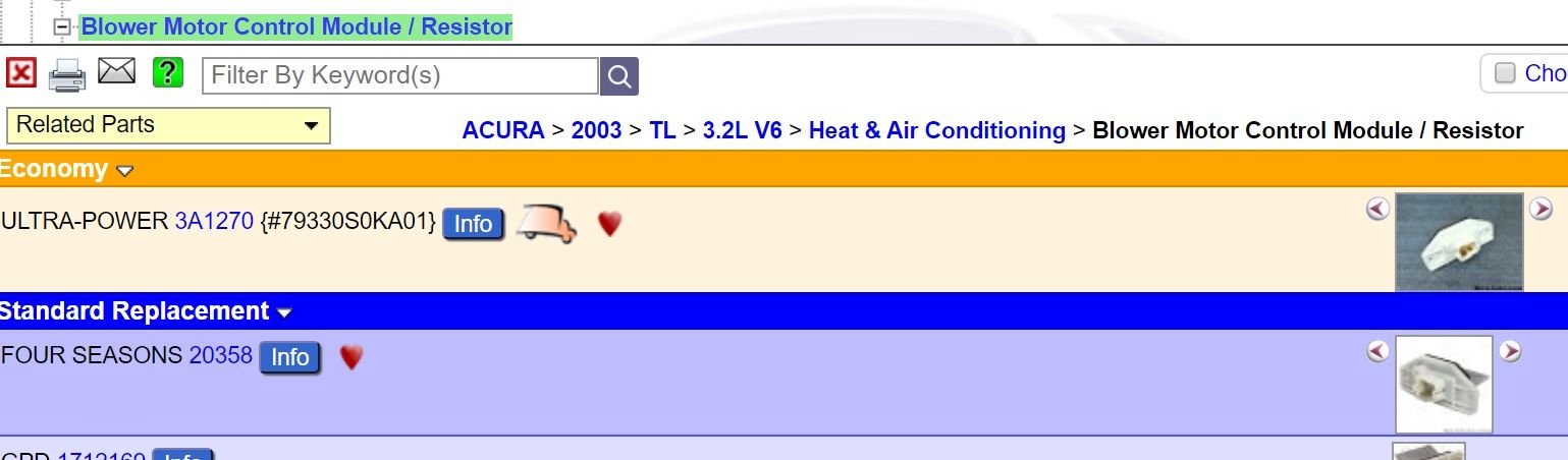

Well then, I stand corrected. Maybe... Picture direct from RockAuto...

Calling it a resistor isn't a huge issue....that is not the part we are trying to correct. Older cars used resistor packs to get the multi-speeds. In more modern cars with more than just a few speeds, a transistor takes this function to give the 6+ speeds most cars have these days. Many people, myself included, still call it the blower motor resistor by default.
But a thermistor is a completely different beast. Technically the interior temp sensor located below the steering wheel is more than likely a thermistor.

I was just trying to help people find the part. I haven't encountered it being called a transistor at a part store.
