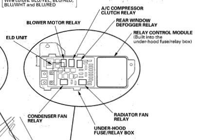

I had a similar problem and it turned out to be the compressor relay. This relay is located in the under hood fuse box which is in the engine compartment (page 245 in the owners manual).
There are three of the same relays in the fuse box. Temporarily you can swap the A/C compressor relay with one of the others to see if the compressor comes back on and operates like it should. But the other two relays are for the radiator fan circuit, so don't just swap them and leave it that way for a long period, the car could overheat without the fans operating properly.
They pull straight out and can only go back in one way. The A/C compressor relay needs a little coaxing to get out since those green relays are so close to it.
Below is a picture of the fuse box. The red circle is the A/C compressor relay, the yellow ones are the fan relays.
The part number is 39794-SDA-A03. They're about $25-30. The Acura parts dealer said they go through allot of these during the summer (he had 32 in stock).
Good Luck!
