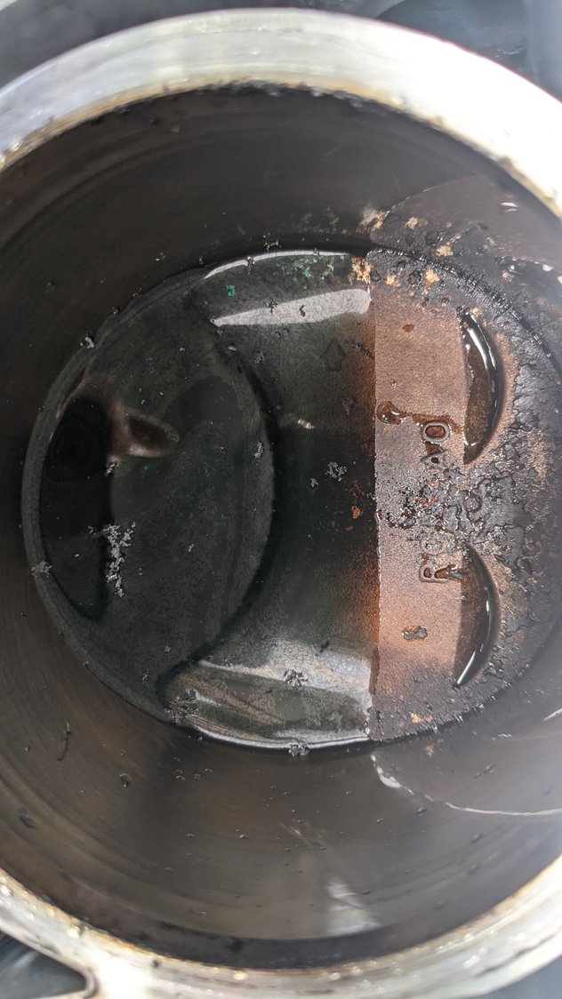

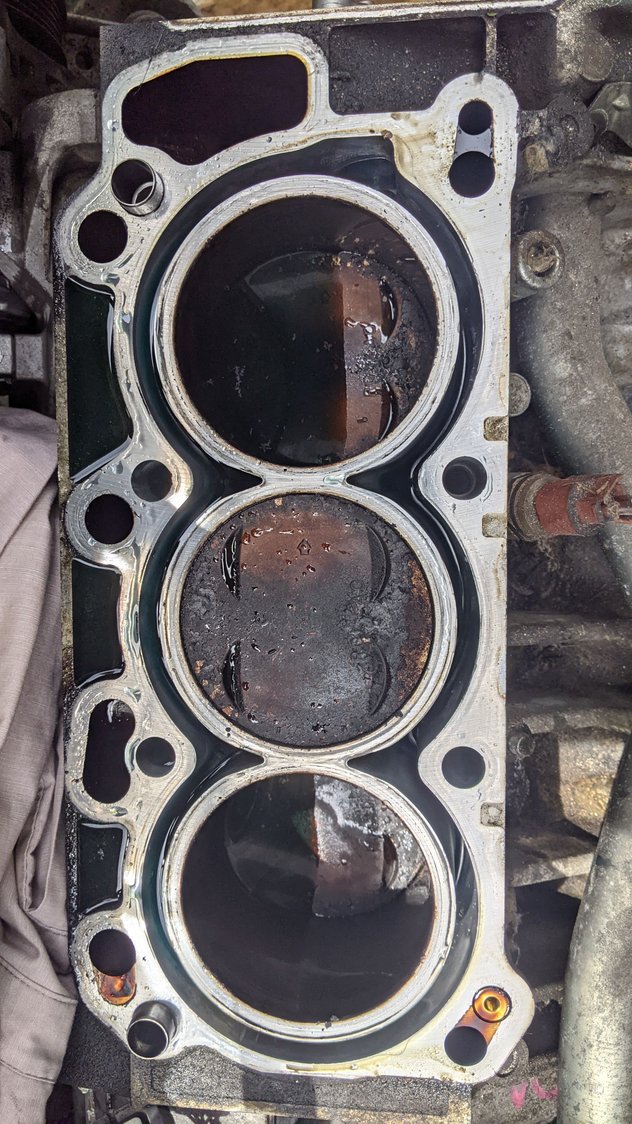

Another update, I decided to make a last ditch effort and change the heads from my motor (viewer descretion advised)
From these in the photo to some RL heads I grabbed from the junkyard a while back they're currently in the shop being tested and prepped for the install my question is how can I clean up my Pistons while I have the heads off now. They're a bit of flaking which of course is mixed in a bit of the coolant. Thankfully no oil
Old Nov 14, 2021 | 11:00 AM
Posts: 6,911
Likes: 2,214
Originally Posted by Glorygang600
...my question is how can I clean up my Pistons while I have the heads off now.
Acetone is the key.
