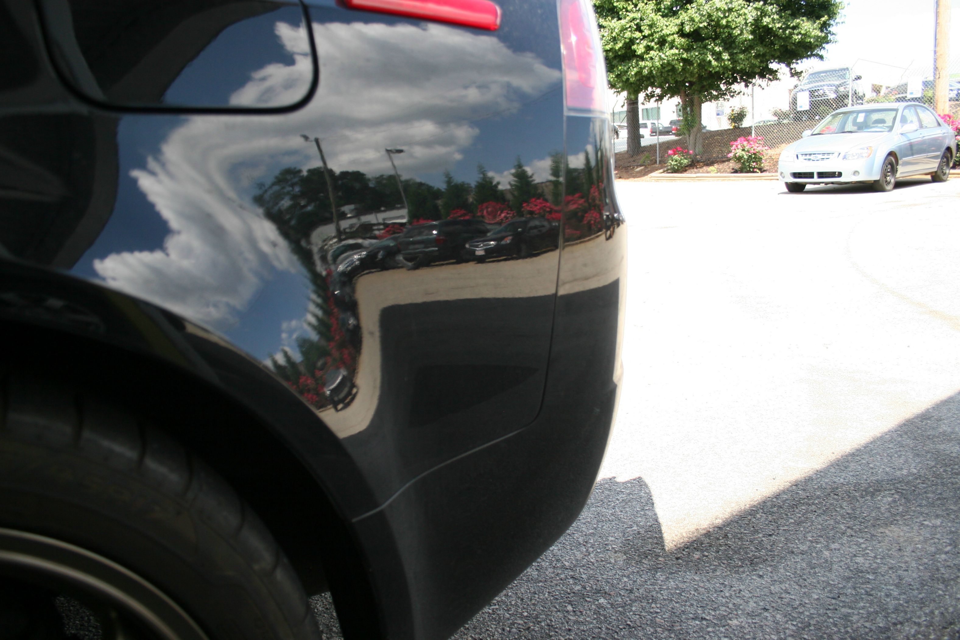

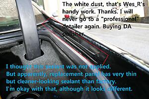

Sorry for big-ass pictures. But I think detail and high-res is important in this case
PICS WITH NO MARKINGS IS THE UNDAMAGED SIDE!!
Let's start with bumper.
Quarter panel
Manager and insurance adjuster(poor guy. He's a nice person. The body shop is just stupid) agreed the guard rail impressions and fitment issue should have been corrected and I made sure they said "We will look for ways on whether it is repairable or have to be replaced to correct the problem".
(instead of "we'll see what we can do" which results in "sorry we can't. you damaged it yourself")
Let me know if I missed anything.

Thanks for the better pictures, I can see whats going on now.
It does look like the shop could have taken better care in lining up the panel.
Looks like your adjuster is willing to work with you, so I hope you'll make good progress! I dislike body shops, they do a good job for 98% of the population, but the 2% who are car nuts always pick up these things.

That's a shit job if you ask me. There is no reason the untrained eye should be able to see these repairs. Putty should be used conservatively and not be the main "source" of the repair. They probably use the cheap filler too.

Call the nearest premium car dealers and see which body shops do repairs for their new cars-- a couple of those shops will probably be on Geico's list.
There is no reason to accept the car back in that condition.

They did fix the bump on top of the C pillar, hard to tell from the undamaged side.
But there's another problem ... I wanted to ask the forum before I go fight them again, because I do realize if you paint a new panel that's attached to the car, you get rough edges. But, this is visible "outside" part of panel too.... Pics
It's bottom of C pillar where it meets trunk lid.
I was very unhappy that not only I had to deal with technicians myself, but also their attitude.
"I was the one who got to order a new bumper for you nice and clean"
no shit. You should've done it last year.
Is this typical with repaint??

Sorry for double post, upon closer examination, I found this.. Is this what I think it is?
Smooth part feels smooth. dull part feels rough. And that's a very clean border
I'm not even mad lol. I just, give up on Geico express repair facilities chosen "based on their quality of work and reputation"
Filed another repair warranty claim.

what I can tell based on pics is overspray in the final pic. Which you can get off not to hard and the first pic is just a lack of coverage or roughness. They could buff and polish it. More full pics??
Old May 24, 2014 | 02:37 AM
4drviper's Avatar
Joined: Sep 2011
Posts: 1,138
Likes: 78
What kind of full pictures do you want to see? Faraway view of the rough edge of C pillar? Let me know and I'll go take it when it's brighter outside.
I don't think it's just buff issue. There are no clear coat or metallic flake visible. on that particular part but of course I could be wrong.
I do not want them to buff my car because when they buffed it after painting, they create swirl marks. And when I asked last time why the newly painted panels have swirls, the manager told me he will cut me a check to take it elsewhere if I don't like the work they do .-. When I asked the technician yesterday (which I did not like because of their attitude treating me like they were doing me a favor) he said they only buff it, but don't "glaze" it, and glaze is what needs to be done to get rid of swirl marks. I'm done with these guys. If a newly painted panel has more swirls than before.......... I don't think anyone would appreciate it.

jeez, I feel sympathy for you. That is some crap work, but relatively typical of dealership shops. Sadly this is the kind of work that alot of places do. You need to find yourself a small privately owned shop that isnt fed insurance work by the major insurance companies because they do it the cheapest and the quickest. Find a place that has to do great work to survive in the world of cheap and crappy shops.
it looks like they just back taped that inner c pillar section instead of using a hard edge windshield tape to insert and peel back the seal so that they could get color and clear in there. That looks like junk and Im glad youve made that clear. Id be ashamed of myself if something left my shop looking like that. Now that I have my own shop I refuse to do insurance work, I am more in the restoration/custom paint/ customer pay market. I hated insurance work at the shop I worked at previously, they never want to give you the proper time to get it done, and they never want to pay your rate. They want it done, cheap and quick and those two dont go well together in the body and paint business.
I really hope you can get this issue resolved at another shop who actually cares what people think of their work. The sad truth is 95 % of people in the world give a crap about what their paint looks like and if the panels line up perfectly, they just want their cars back.That is how all these crappy shops survive, and they have no idea what to do when someone who knows what to look for or someones just a little more picky than the average person, to me their " fixed " version looks worse than the previous. Best of luck to you man.
