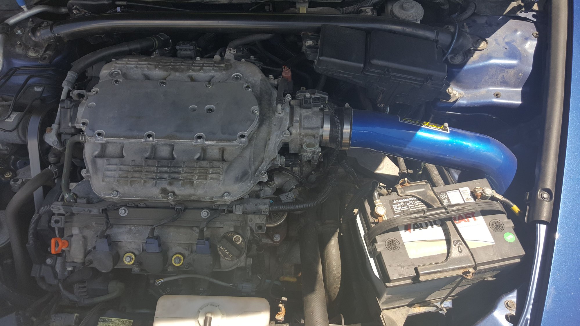

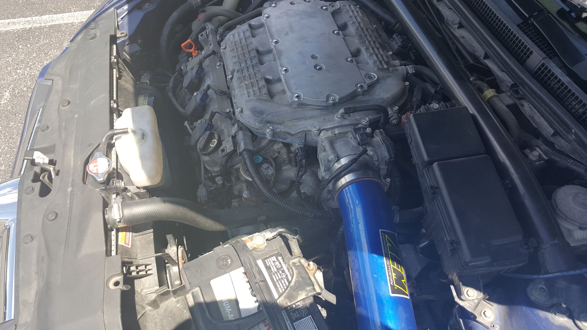

^is the AIT sensor in the correct place? (air intake temp. sensor) it looks for temps and will ask ECU to adjust accordingly

Where is it located on this car?

near the throttlebody, on black hose.. but since you have an aftermarket intake, it should be on the intake itself.

do some research on the IAT sensor. When I swapped my 3.2 manifold and throttle body for the 3.7 parts I had to relocate the IAT sensor as usually it sits near the throttle body and intake , but your AEM intake doesn't have the bung in which the IAT should be relocated to. I had to dangle mine near the bottom of the front bumper and ziptie it
Old Jul 15, 2016 | 12:00 PM
^thats why I couldnt see the sensor on the aftermarket intake....^cuz the bung isnt there.
Thanks bro!!
as mentioned, its probably hanging some where. it needs to be somewhere recieving cool air!
Thanks bro!!
correct! His intake is not the V2 AEM so it doesn't have the bung. Justn is right, whoever installed the intake probably just left it dangling. Youll need to locate the sensor and extend it by soldering in an extension and locate it somewhere near the bumper mesh near your foglights and you should be good to go
