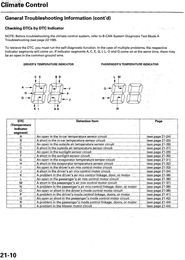

Sorry, rolling 80mph, can't run the DTC till we stop. ;-). (Only two reasons to stop IMO and one of those is debatable)

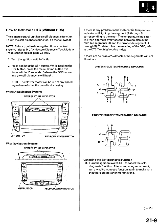

You sure that's the right procedure for an '07 w/nav? I tender it being a process of holding two buttons down, but can't find it online and aren't getting anything from the car when I try several different combinations.

The procedure has worked for me an my 08 TL-S. Never had any DTCs, but tried it to see what would happen and it worked.

Shouldn't be really difficult. Car off but key in ignition to on, hold down OFF on the HVAC then press recirculation 5 times every second or so.
Also if you hear everything move and see them move properly it might not be the motors, hm...
