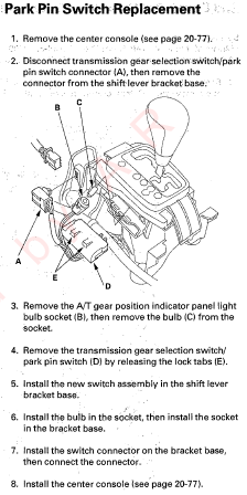

P0958 Manual Shifter Switch
Does anyone have a link or video on how to replace the switch, my mechanic personally told me its under the shifter / center console, but before I tare out my car I want to know a little more ..please and thank you
