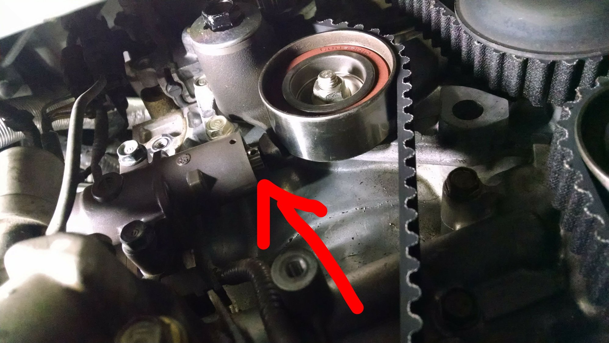

The timing belt tensioner is the brown cylinder to the left. The red arrow points to the the little chrome "piston" inside the timing belt tensioner. The tensioner is spring loaded and fluid-filled. Eventually, the seal wears down and the fluid will start to leak, and the tensioner will no longer have as much tension.
Once the tensioner becomes weak, that piston will tap (loudly) against that little tab to the left of the pulley - causing a rattling noise.
Timing belt tensioner
