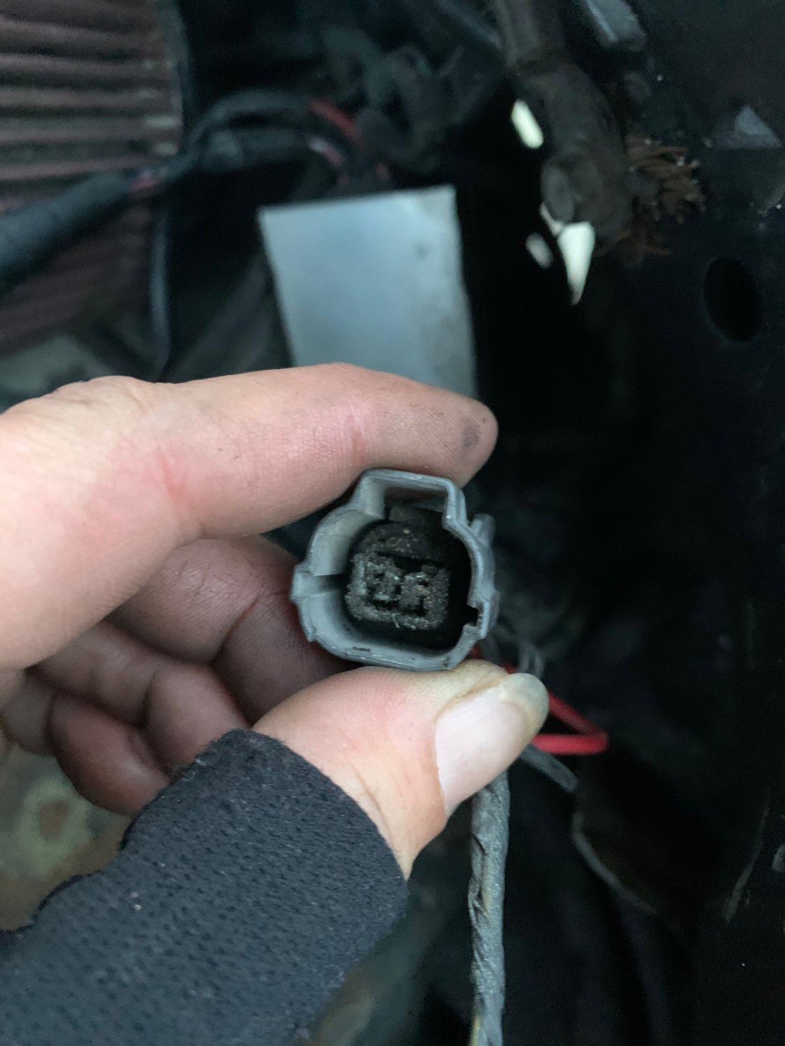

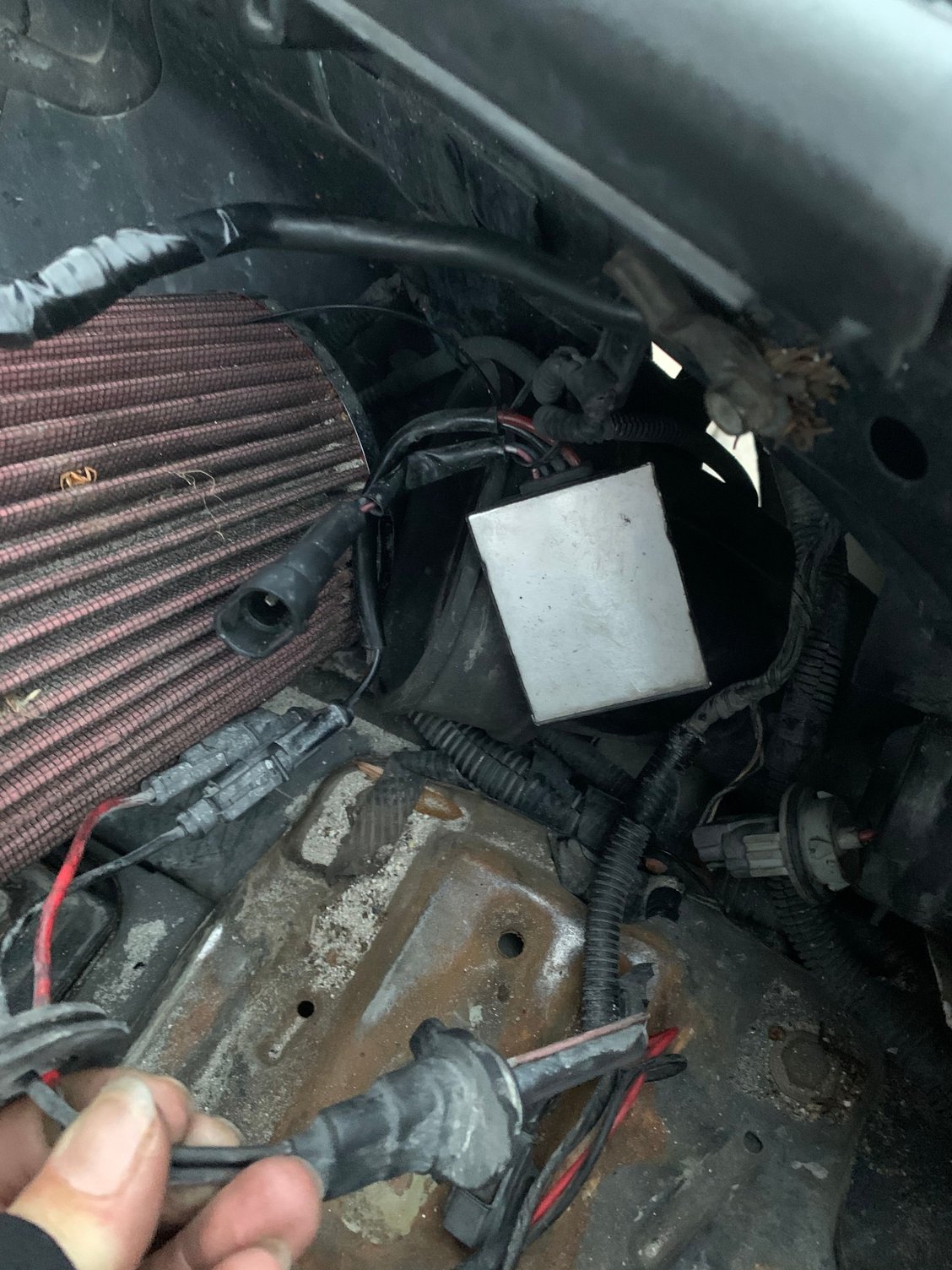

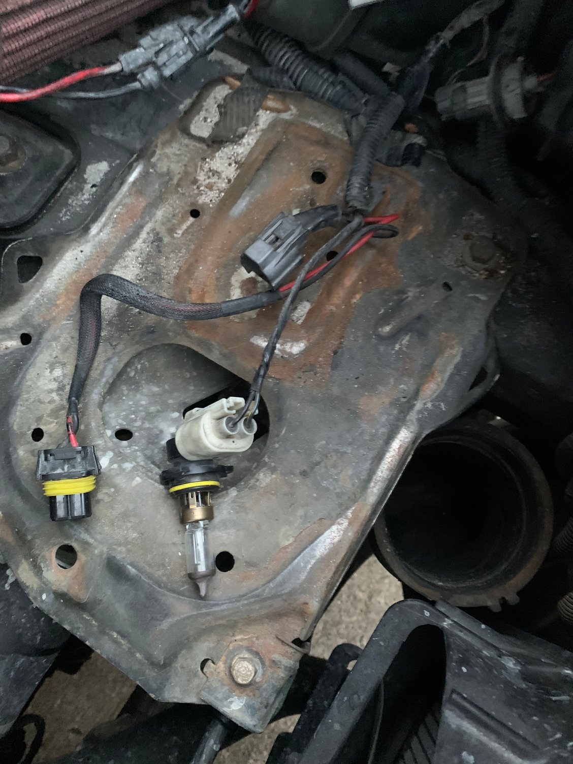

This is zip tied off but wasn’t connected to anything
These are the only thing connected
This is just dirty connector

that little silver box is the ballast for HID lights, you'll have to trace the wires from the ballast and see if they connect to the car, then follow the wires from the ballast and they should lead to a D2S HID bulb.

that connector is supposed to connect to an OEM ballast. The other plug is a 9005/6 plug meant for aftermarket HID ballasts. they shouldn't have 9006 HID bulbs, you can still use an aftermarket ballast with a D2S bulb and Amp > D2S connector from the ballast to bulb.. That guy didn't know what the heck he was doing.

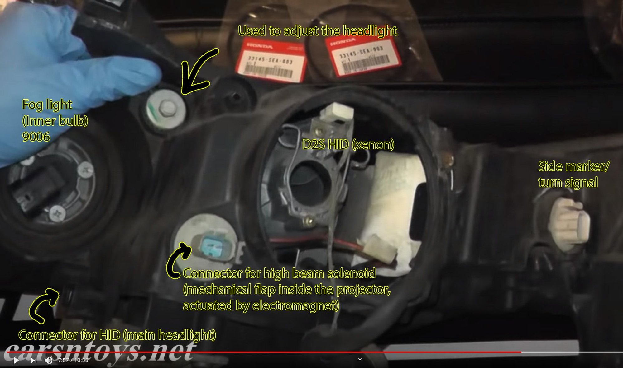

Did main headlights worked before? This one:
For proper tire size and pressure (if you have stock wheels), look at the sticker on the middle pillar ("b" pillar) when you open the driver's door. You most likely have a "donut" spare so don't compare size of that wheel to other four.
Main bulb is behind the plastic cup, that might be secured with small security torx screw. Main bulb is D2S HID, which is powered by ballast (small silver box on the bottom of the headlight).
This is taken from youtube from 2005 TL. Yours might be slightly different. That the back side of passenger's headlight outside of the car.
Also, seems like he spliced the 9006 female connector to the hid connector (gray that wasn't connected to anything). That might be for couple reasons. Maybe stock ballast failed and he replaced them with cheap aftermarket parts?
