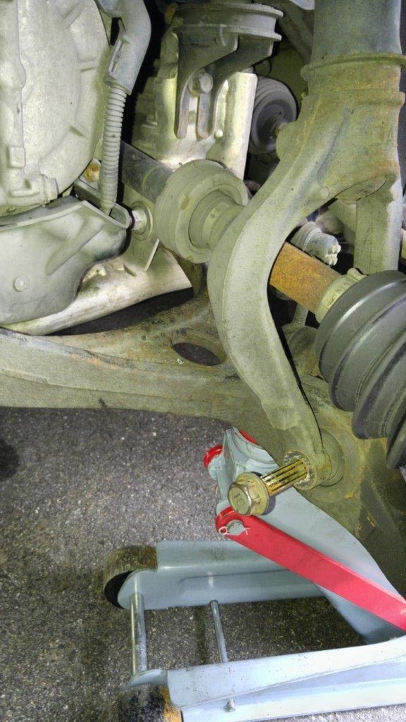

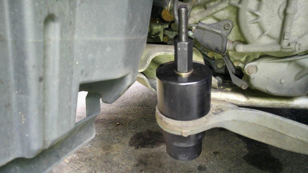

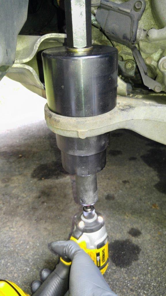

Driver's Side Compliance Bushing aka LCA Bushing
More photos were requested so here they are.
Doing the driver's side was less painful because I didn't need to replace the ball joint on this side. I pressed mine out through the top of the control arm.
I didn't see any markings on the LCA indicating proper rotational orientation of the new bushing so I looked around YouTube till I found footage of someone who also did this project. I think I may have installed this new bushing upside down. After looking over my pictures, I noticed the 'flappy' portion of bushing material was on top of the old bushing, and I inadvertantly installed the new one in the opposite orientation. Hopefully it won't matter. I really don't feel like taking this stuff apart again.

Tool for pressing the bushing.
I store the bolts here so they're within reach, but unlikely to roll away.
I know it says "No Impact" but I got it loose enough doing it manually that I think it'll be alright now.

Upside down?

Unfortunately I did indeed install the bushings upside down. That's what I get for not looking carefully at how the old ones were installed before I pressed them out. Though I didn't notice any trouble with the way the car drives, I decided to play it safe and redo the install, this time with the bushings installed in the proper orientation.
I believe this is how they should look on the driver's side:

Just got done with this job, amongst others. Bushings are in. That tool is a lifesaver. I pulled the axle nut on the drivers side and noticed it didnt move a bit during the job. Didnt pull it on the passenger side. Took a total of an hour to do. Cant wait to get back on the road. Thanks for the writeup.

Hi, I'm doing this job now on my 2004 Acura TL and I can't seem to pull the Lower control Arm out enough to get a proper top and bottom access to reinstall the new Compliance Bushings. All three of those bolts are removed as you have shown but I can't get the Compliance bushing side of the arm to pull out and rest against the frame mounting flange. I feel like I have to take the whole arm off now. And on top of that, these new Honda bushings were milled by a monkey. Anyone else have issues with their new bushings from Honda? They are not flat (evenly ground) and the starter edge is ground by hand after a 6-pack and is all over the place. When trying to start pushing the bearing in it is cocking to one side. I'm using a 2-1/8" and 3-1/2" sockets with a 9" grade 5 bolt and nut like some other posters have used. Maybe this setup is OK for removing the bushings but getting them squared up is a different story.
