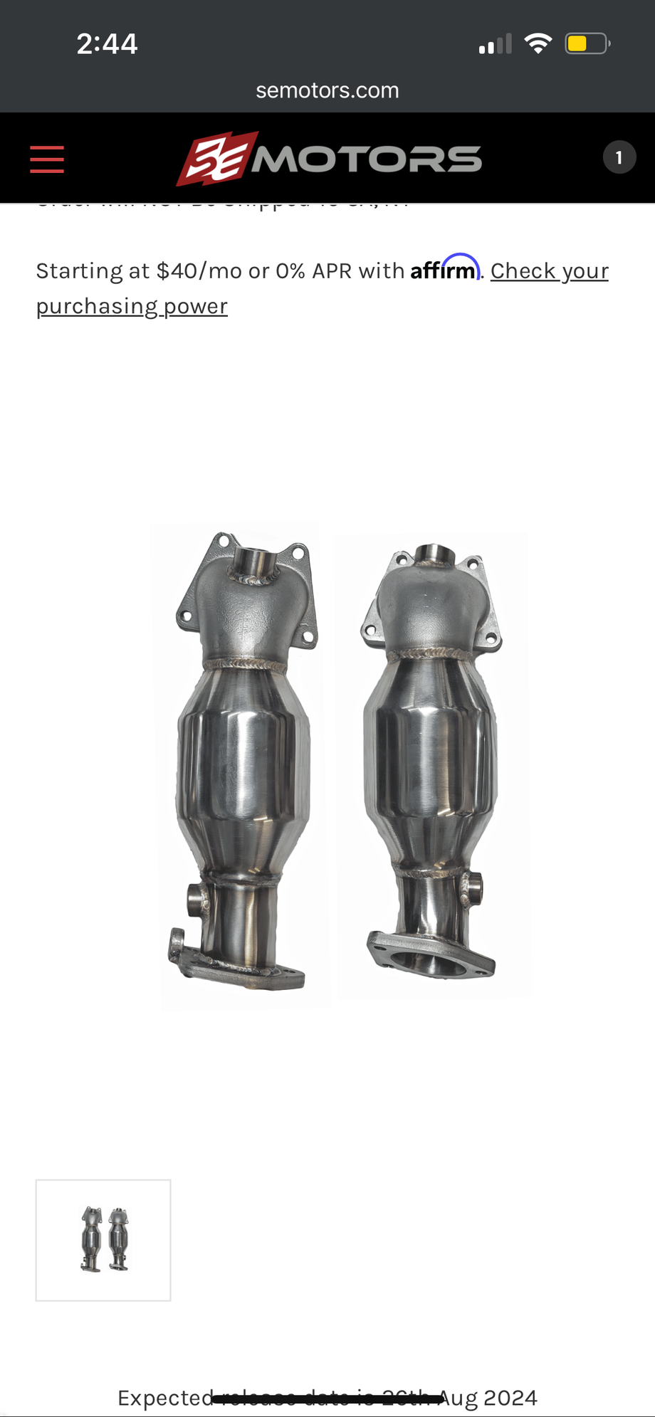

Hi again just had a couple questions reguarding these PCDs they are Tsudo PCDs but they say they are resonated I haven’t heard of resonated PCDs before and haven’t been able to find any posts about these nor sound clips so I was wondering if you guys have tried them out or heard them before or should I just go with HFPCs I’m looking mainly for sound so if they sound the same as a PCD but without the rasp that would be great I’m also going to get a rv6 v3 jpipe to go with them, the car only has a stage 3 setup right now,
Here are the PCDs in question

Looks to be a new product?
Tsudo had HFPCs while back. IDK about their quality.

I went with the tsudo pcd from semotors. The are larger then the rv6 and are resonated. Very little rasp. Paired with rv6 j-pipe and tsudo cat back exhaust. Set up sounds very nice . Low growl and unleashed when you "gently accelerate to the speed limit" just make sure you grap the elbow defoulers from amazon they are $30. And lock tight the couplers on the defoulers.

I have them paired with a rv6 j-pipe and tsudo cat back exhaust and love the sound. Nice low growl very little rasp. Just make sure you get the 90° defoulers for your 02 sensor and lock tight them. The front defouler brings the 02 sensor right into the front engine mount. The vibration worked the defouler loose. So lock tight it and good to go. Se motors was great they shipped my exhaust and the gaskets were messed up but they sent new ones free and pretty quick.

thanks for the response man after seeing this I think I’m gonna go ahead and pick them up could you send me the link for the defoulers on Amazon?
