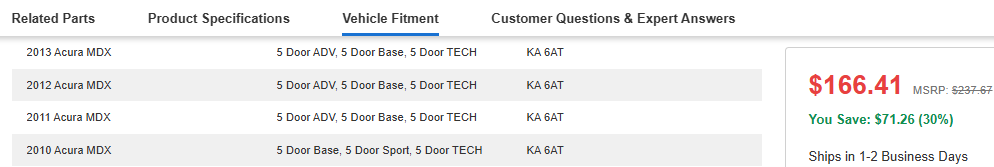

Here is what I found, #12; oil pan crank sensor for the 2008 Honda Odyssey EXL with all related fitments - 37500-R40-A01.
#33; oil pan crank sensor for the 2010 Acura MDX with all related fitments - 37500-R40-A01.
They are the same part number 37500-R40-A01.
37500-R40-A01 cross referenced to RockAuto, the sensors have three pins?
Not sure how 'six pins' ties into all this?

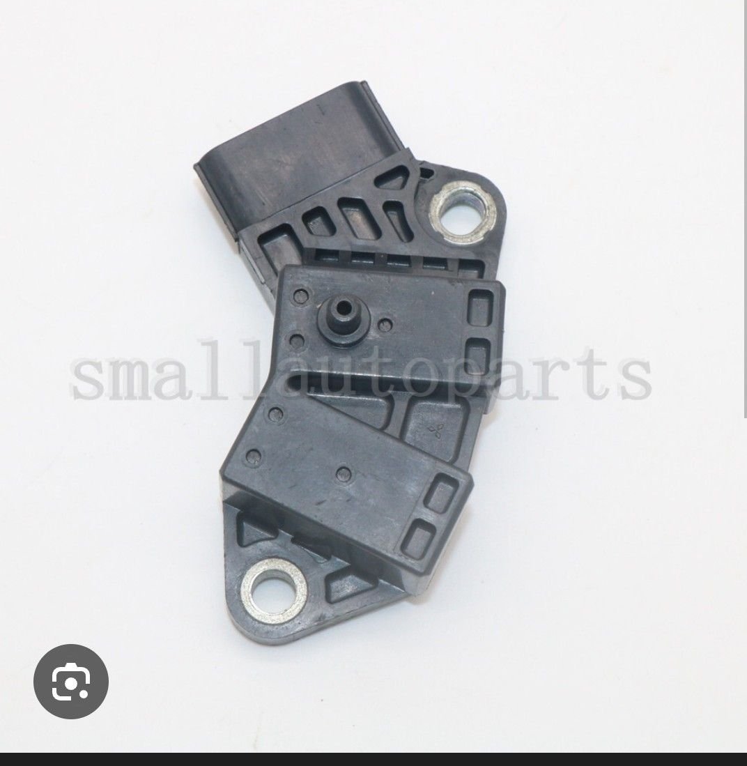

The J37A1 has the crank sensor on the front of the engine. It's a 6 pin and looks like this.
The ssensor from the J35A looks like the one you sent me, with 3 pins.

I'm no expert, with that said, I'm not seeing how it would be possible to take an 08' Odyssey J35A7 ECU / VCM; with a factory engine harness 3 wire / 3 pin oil pan mounted crank sensor and make it compatible with a non-VCM 08' MDX J37A1 with a 6 pin oil pump mounted crank sensor.
It seems like 'plug & play' probability of success would increase if a 2010 MDX J37A1 was employed instead (if it mounts to the Ody trans?) since that engine has a similar oil pan 6 pin crank sensor configuration (shown above in post 7) as the original blown 2008 Ody EXL J35A7?
That does not even address any 'can of worms' issues that may / would arise (if any) regarding the Odyssey's VCM configured ECM trying to manage a non-VCM MDX J37A1.
I understand the allure of an increased displacement J37A1 over the J35A7, especially for the $100 dollar cost; however, it appears to be a puzzle you may not be able to piece together easily, if at all?
