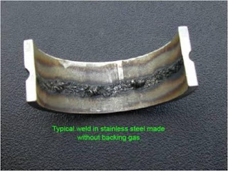

Backpurging is having gas inside the pipe to ensure there is no contamination from air during TIG welding. Without it, there can be nasty crud on the inside of the pipe, and not pretty like the outside.
If this were on a turbo manifold, I'd be more concerned about backpurging. On an X-pipe connecting to the exhaust? eh..I'm surprised they even tig welded it. I think they did a pretty nice job.

I've always found visuals to help me. It did when I was learning to weld:
Here's a weld that was not back purged. The outside could look beautiful, and the inside like this:
You can back purge carbon steel or aluminum but they are not as dependent as stainless is. Stainless needs the back purging to prevent the granulation. Without it, it also hurts the corrosion resistance of stainless.
