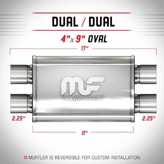

Has anyone done this or ever contemplated doing it?
My current setup is: RV6 V3 PCD - RV6 V3 J-PIPE - RV6 True Dual Exhaust
I know, I know it would pain me to hack up such a beautiful piece of work, but honestly its too loud and too raspy for daily driving and I have a pretty high tolerance for this stuff. Its the PCD thats the cause of the loud and rasp, but PCD is a pain to take off and the gains are too good to get rid of em. Im getting a lot of attention with this setup and not the good kind, already got a few tickets (Canadian cops are pricks). Very minimal highway drone though, which is good.
The only part that makes it tricky is due to the 2.25 inch twin-tube piping that goes all the way through, not sure what the best way to go about it is.
I was looking online on Magnaflows website and came across this, the only muffler or resonator I can potentially see working here. Im thinking of welding it in right after where the J-Pipe connects. What you guys think?

So, Magnaflow has two options available for dual 2.25" inlet and outlet mufflers.
The one posted above is the (11378) muffler which is the smaller 11" option. This one is a few inches bigger, the (11385).
Hmmmmm

There is no room for that resonator under the car. Everything is extremely tight already. We might be able to build custom mini resonator or a helmholtz resonator. However I dont know what it will do to the sound of the system. You might loose the signature TD sound.
Thanks for chiming in Richie. I guess that puts an end to that idea. For the brief period I had just J-Pipe and True Duals, the exhaust note was pure eargasm. It was actually very quiet unless you floored it.
Damn PCDs lol, but the gains are soo goood. If you decide to customize a mini-resonator to add onto this system, please let us know! Till then I guess Ill be mindful of cops.
