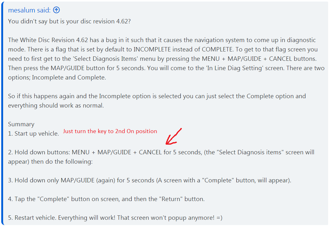

I successfully installed a 07 Camera on my 07/08 player, and I downgraded from 4.C0 to 4.2x and for some reason when I start my car, it goes straight into the diag menu and it won't let me back out.
The only way to get out is to press map-menu-cancel then it gives me the normal menu, then I just press return (exit).
is there a Reset? I'm not sure why it is doing this. I even disconnected the camera thinking it was causing an issue, but it made no difference. The Exit Diag button is grayed out. it won't work

Never mind! There must be a bug in this version. Found the Problem. How did we survive without Google? haha (It used to be webcrawler before Google)
