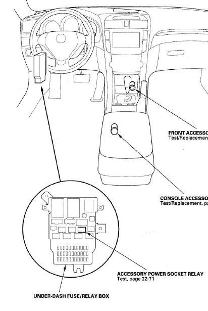

Cigarette Lighter/Power Outlet 07 TL
I Changed The Fuse On My Cigarette Lighter/Power OutletOn My 07 TL And It Still Isn’t Working Does Anyone Know Where I Can Get A Replacement From
Also I Watched A Video That Showed Them Using A Special Tool But That Wasn’t In Another Model Car But Will I Need That Tool For My TL ?

Which Fuse Did You Changed Exactly? How Do You Know That Outlet Is Still Not Working? Did You Used The Same Thing That Caused The Fuse To Burn In The First Place?

I Changed Whatever Fuse Is Used For Accessories In The Fuse Box Under The Steering Wheel And It Didnt Work I Then Changed The Fuse From The Fuse Box Under The Hood , Socket Still Wasn’t Getting Any Power

It might be unplugged under the cupholder. You'll have to take out the center console to figure it out. Also check to make sure the fuse did not blow again that you replaced. Did you or a previous owner wire anything to it?

There Is Couple Fuses To Check. Use Test Light To Probe Both Terminals Of Each Fuse With Key ON / Accessory Position.
Checking Them With Test Light Ensures That Fuse Is Receiving Power. There Is Also A Relay. If All Fuses Receive Power Try To Swap That Relay With Other Similar Looking One.

It’s Not Unplugged It’s Burnt Out, I Just Need To Know How To Remove It

You have to remove the center console.
