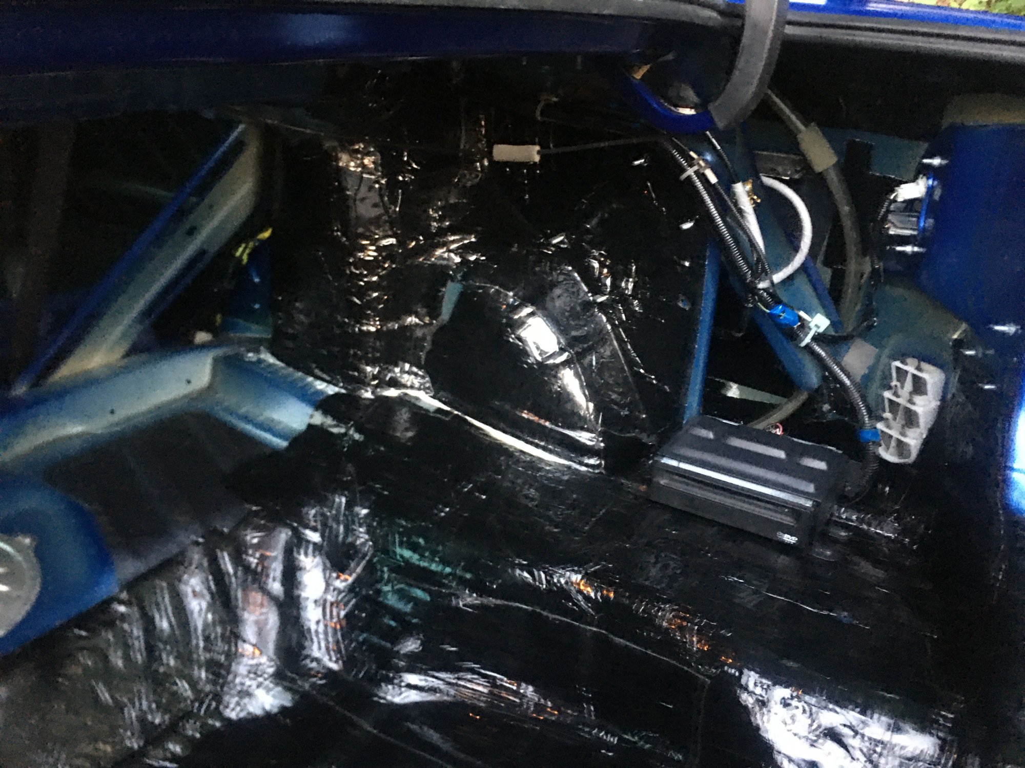

Also, I’m dynamatting my trunk, rear deck and under my rear seat. Any tips? In the trunk back where you would access your side markers, should I put a sheet across all that or just cover the metal and leave it all open? I got the mat and the pad material. I’m hoping it helps with the drone from the XLR8 catback.

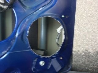

I had to cut my door and add a 1 1/8” spacer to get the woofer to fit.

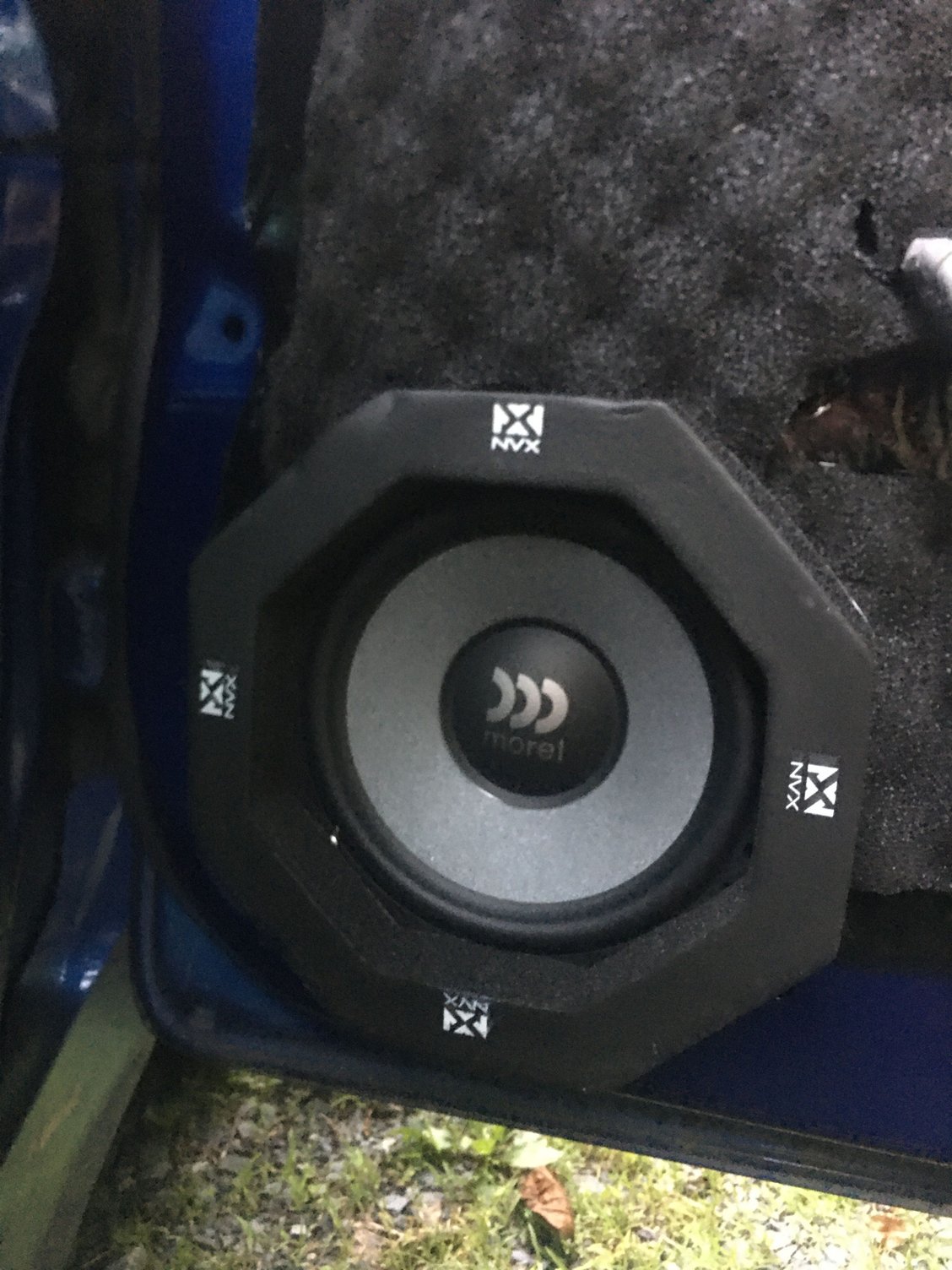

Yes, there is plenty of room for the mid driver in the door. I was thinking that the LC6i was a processor, that is just a LOC. what are you using for amplification? If you choose the correct amp it will work just fine with the low level signal from the HU and you can avoid the LOC completely. What your doing is taking an already amplified and noisy high level output and converting it to a low level signal to be used by your amp. There is no need for that. Use the cleanest signal you can use always.

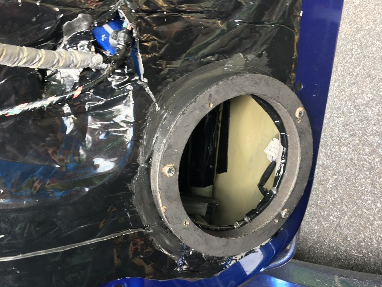

Im using a JL RD400/4 for the speakers. I haven’t decided on the sub. I have a JL 12W7 that is 16 years old. Was gunna throw it in with an old amp but the foam was all deteriorated. (Been in basement for years). I just got in the replacement foam and I’m thinking I’ll upgrade to newer amp technology too. I got the lc6i to hook up the sub too. I don’t mind running it. I already created a spot to mount it in the trunk. I tapped off the wires for the fronts right at the plug coming off the amp. I ran 12 gauge for that back to the trunk. Was gunna use 12 gauge and tap off the ends of the rears and rear sub to go to the lc6i for my signals. I have all new 12 gauge for the new speakers except for the front doors. I had to splice into the wire going through the loom to the plug. I wasn’t messing around with drilling a new hole. I would have had to take my door off.
I’m not going for a competition sound, I just love listening to music when cruising.

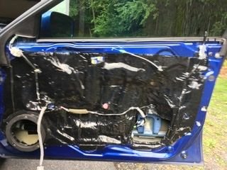

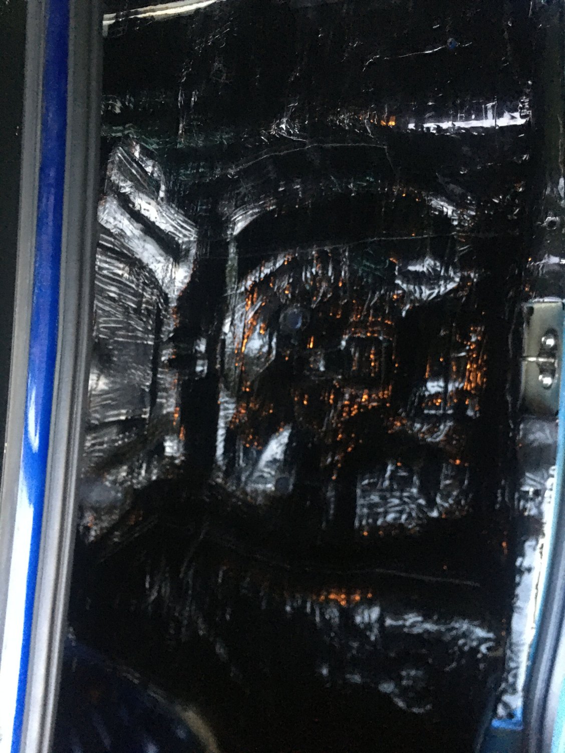

some pics of my progress.
I only have 2 sheets left of the deadening material so I ordered more. I plan to do the rear deck and bottom of rear seats too. I’m also covering in the foam once done. Hoping it helps with the drone of my exhaust. My camera on my phone is messed up so pics suck

You cannot have to much deadening..............I think your close...haha That should knock down a lot of roadnoise and sound. If you are using a JL amp you absolutely do not need the LC6i. Use the low level signal directly from the HU. I am running a JL XD700/5 4 channels bridged to front components. sub channel going to a single 15" infinite baffle. rear deck OEM speakers still on factory amp for rear fill only. center channel on factory amp too. You do not need anything coming from the rear, and this maintains center channel voice prompts. You can take the sub output from HU and run to new (appropriate) amp for sub. this will maintain sub control from the HU. That is not what I did. The sub signal from the HU has already been manipulated in the HU so I used the full range left and right signal directly to the amp and let the JL amp tailor the signal to the sub. then add the JL remote level adjustment to the amp for sub control. let me know if you have any questions. I realize my thread about my adventure is a long one, but very valuable information in there.

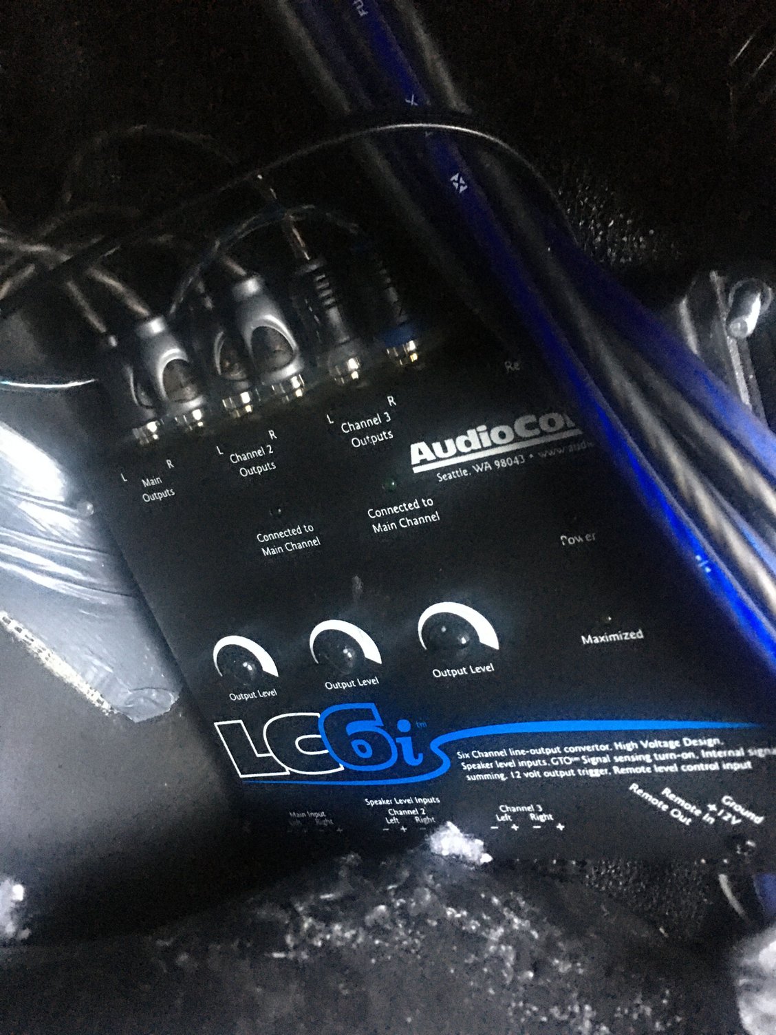

I got everything in speaker related. The lc6i was pissing me off with the “hiss” noise it was causing. I had to turn the gains down on it even tho that is not how audio control says to set it up. The speakers sound amazing. I’m actually debating on putting in a sub at this point. My hold up now is determining where and how I want to mount my amp for the speakers. I was going to do a rack under the rear deck but that will make it hard to get a sub in/out if I needed too. I think I’m just going to make a board that bolts to the back of the rear seat cross members. That opening in the center of the seats is pointless anyways. I’ll mount my amp for the speakers on the passenger side, distribution block up top in the center and leave room for a sub amp and cap if I decide to add it later. I could hide it but if something goes then I’d have to rip it all apart to change a fuse. Anyone have any ideas on mounting to the rear seats? I was thinking of using 1/2” wood for a template and then finishing in a 1/2” plastic sheet once I got it all laid out with threaded inserts to fasten it to the structure that bolts to the rear cross members.

Your using speaker level inputs to the LOC correct? The hiss is either the post amp signal your trying to use or a bad ground somewhere. I would use cardboard for a template. I dont believe any one is using CAP's at this time

Its definitely not a bad ground. I called audio control and they are saying it’s the gain on the amp. They said with their product I shouldn’t need any gain on my amp. I’m gunna mess with it later and see. My amp gain is only 25% up. Are the factory alternators good enough to keep up with the larger stereo draw?

I would remove the LOC from the equation and take the low level L/R output from the HU into the JL and your hiss will go away. Same low level L/R signal into sub amp and you will be good. I cannot think of any reason to introduce the LOC if your using JL amps that work perfect with the HU, am I missing something your trying to do? Factory alternator fine with what you got going on. time playing without running varies, but battery usually the weak link there. Edit, if you want factory sub control you need to use the Sub output from HU, my method you need JL remote gain control.

i went with the LOC because my friend had it and gave it to me. I messed with it and it sounds much better. Still a little his but not much now. If I changed things up now I’d have to rip apart the whole car again to wire to the HU. Maybe I’ll change it up down the road. I got the AccuBass adder knob that ties into the LOC wired up so I can adjust it up or down if need be. So far everyone I had listen to my speakers is amazed how clear and clean the sound is. The hiss is only with the volume at 0. Very faint now. I’ve run (In other cars) Polks, JL c2’s and infinity kappa perfects and these Morel Tempo Ultras make the others sound like Sony explodes.

Factory amp has a TON of white/floor noise even with the radio set to 0 volume. Most folks use a line driver to help raise the factory signal to the requirements of audio processors such as the Rocksford, Audiocontrol, etc. pohljm is right on many points and folks should listen...
