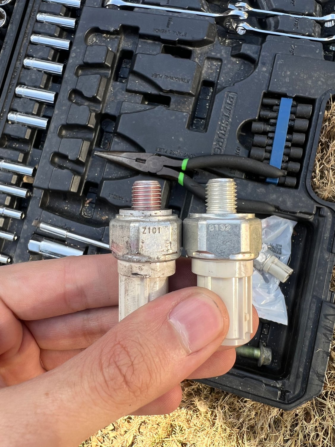

Ill go pick a couple original ones up monday, he didnt seem like the fellow to buy OEM parts but i dont either if i have the choice, it appears i dont have the choice here lol, ill pick some up and update yall if it fixes it

PO just responded and said they were off rockauto, quick check reveals rock auto does not sell OEM pressure switches so that will be my next attempt, im seeing varying answers, some people say they have 2 switches, some people say the 07-08 added a 3rd switch, and i saw a couple that said "4th" but im not sure if they meant a 4th switch or the switch for 4th gear

The 07-08s have 3 switches. Two (#3 & #4) are easily accessible from the bottom via the wheel well and the other (#2) is on top under the battery/air duct area.

do you happen to have part numbers so i can order them online? i know one part number is for 2 sensors and the 3rd has a separate number

for anyone who may stumble across this forum in the future:
2 x 28600-RKE-004 (pressure switches)
1 x 28610-RKE-004 (pressure switches)
3 x 90471-PW7-A00 (crush washers)
thanks! @Pair of TLs

just stopped in at my local honda dealer and they said $370 for the set, about $125 each, so ill be ordering those online, also the code does clear, it just returns after 2 drive cycles (as the manual says its supposed to) i need to drive it today to get a proper code reading to maybe give you guys more insight, and im not sure what difference it makes, but it has mobil 1 full synthetic ATF and not valvoline at the moment, will keep yall posted!

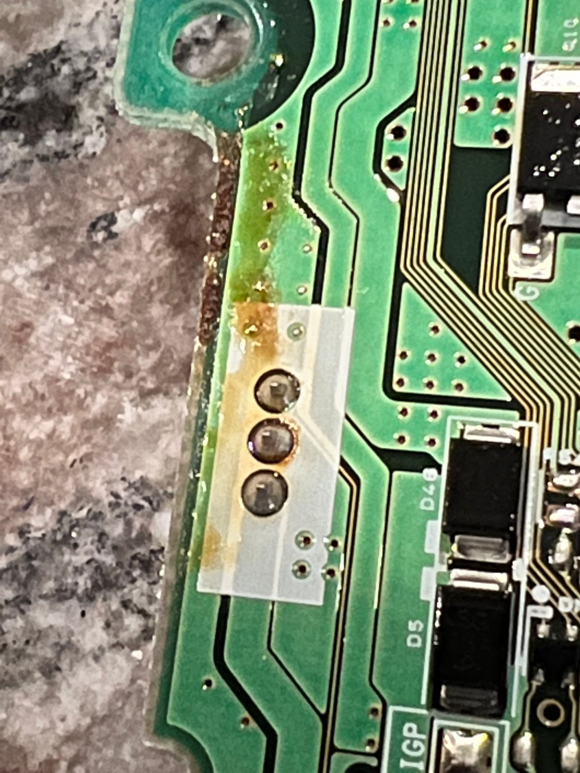

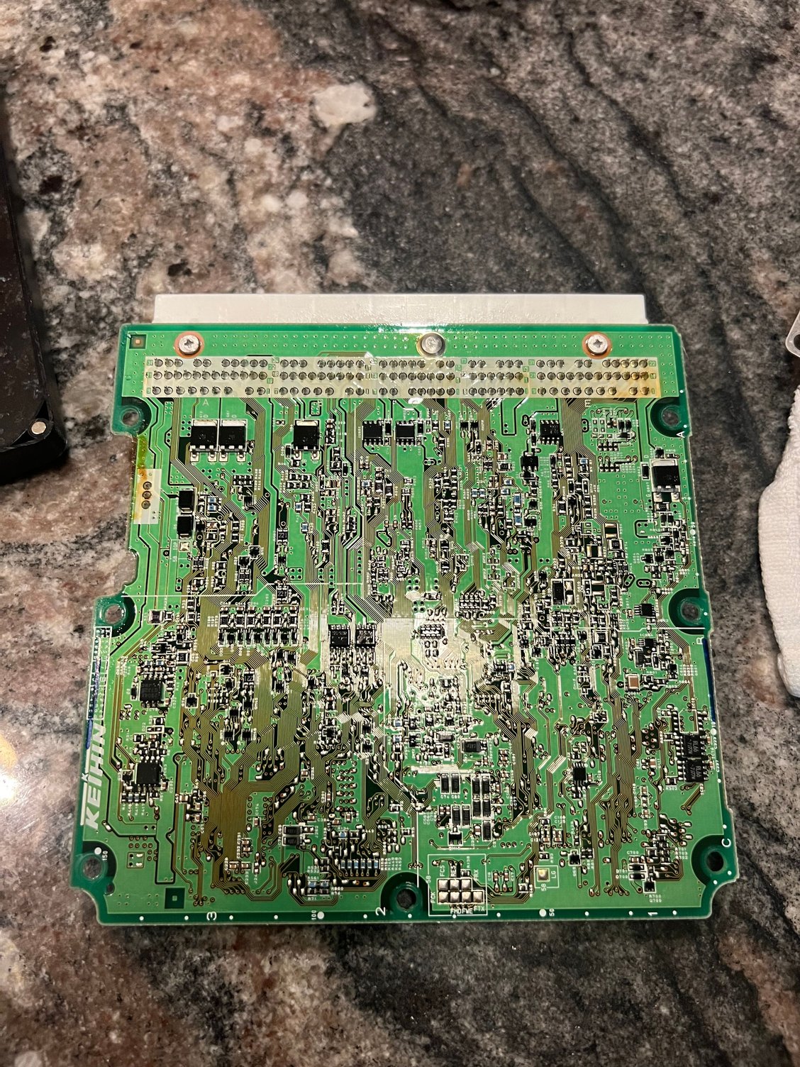

Attached photos of ECM, nothing stands out to say its bad but cant find many ways to test it online, will be reinstalling it and i will try to clear the codes through nav then drive until codes come back so i can provide exact codes
Back of ECM
Browning on pins
Back of ECM(glare)
Browning on pins
Front of ECM

I know squat about circuit boards, but that brownish area in pic 4 doesn't look good...

Hey Turbo, i appreciate your input, as seen above i had included pictures of my ECU so feel free to take a look and see if you can notice any soldering issues, i did not in person,
as for the valve body, it is my understanding that the valve solenoids are the valves, in which case on this transmission the valves are actually externally mounted and accessible without removal of the transmission, let me know if theres any type of test youd like to see or anything else you stumble across that may help me make progress on my issue!
Thanks!
https://www.acurapartsworld.com/v-20...ain-valve-body
This is an illustrated parts breakdown of the valve body in the 08 type S auto to give you a visual reference for what pistons I’m referring to. Actually I think the actual nomenclature is CPC valve I’ve always called them pistons because that’s what the guy that thought me to rebuild transmissions called them and old habits die hard. Anyway they are the long cam looking pieces (sorry it’s the only way I could think of to describe them) that go in first followed by some seals and then held in by the #8 and #9 clips. The exterior solenoids determine which pistons get pressurized and when. But if the internal valve is seized in the valve body all the ecu sees is that the pressure isn’t correct where it’s supposed to be. So it in turn will default to that as a solenoid being stuck open or closed depending on where the piston is stuck at.
Obviously a bad solenoid is the culprit for this condition on an otherwise fully functioning transmission. But seeing as you have already replaced all of them the next logical step, in my opinion, is an issue in the valve body itself.
