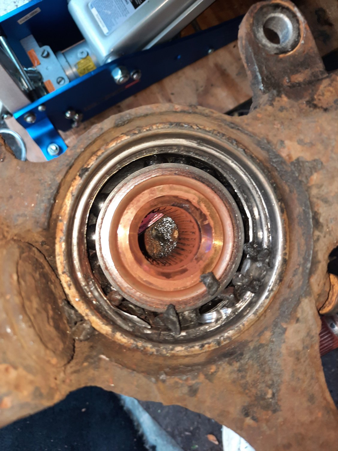

Old Sep 10, 2024 | 06:17 PM
bbsitum's Avatar
Joined: Sep 2016
Posts: 984
Likes: 63
Almost 3 month latter extension of it. When replaced tire second time I heard slight metallic noise right away and so for this almost 3 month. Past night was stronger noise. This morning checked and it is mark that I sow in photo. When lift car and did 12,6 and other angles it show up that tire is shaking, wheel bearing is bad. I spotted a few months go that brake caliper is to close to rotor, like 1/16 away on that passenger side. There is play in bearing and it touch rotor. How long I can drive like this. No still to much of noise. No grinding, just noise of caliper touching rotor. Tough to order NSK bearing, like OEM, and it is only 31$ at Rockauto. They say can be here at Friday for 13$. Another option is "Precise" from O'reilly for 45$. All other parts stores look for 85$. There is in same O'reilly store "Precise" for 45$ and 75$. Not clear what is it.

Likes: 63
Tested again changed diagnosis. I think upper control arm is problem. No shaking at 12/6 and 9/3 but shaking and a lot at 7,5/1,5 and I can see it is shaking in upper control arm. I have an upper control arm from junkyard will put it when I get time. I think problem with caliper/rotor is that I installed that caliper little with angle past year, rust or so. And when pads get thinner it started scrapping. Edit I think rust is behind rotor, as rotor is replaced past year to. I did some cleaning there but not much. I have 2 pads at hand and will put there to and get clean of rust caliper and its housing. However can be rotor is not seating properly, probably will clean rotor housing too. Only I ordered wheel bearing from rockauto and is on way. It is ok keep one in stack if will need.

Likes: 63
Replaced upper control arm passenger side and driving improved. But need do same at driver side. About rotor and caliper both are properly installed. Gap at both side between rotor and caliper is like strong sixteen. Obviously rotor is to thick. Just will live it to worn out itself natural way.

Likes: 63
Well after driving around for a dose miles rotor touching caliper again. Upper control arm was bad but I still have some shaking in wheel. Plus top of wheel is like 1/2 out of level at one almost level surface. But I do not hear grinding noise from bearing still. I hear noise when rotor touch caliper, it is all. Most likely will replace bearing tomorrow. Get it from rockauto Yesterday.

Likes: 63
Went for a few miles today and noise from rotor/caliper touching was to much. Lift wheel again and now is a lot shaking at 12/6 and upper arm is good now. Rotor move away and toward caliper with shaking. Again didn't hear noise from bearing when turned wheel and keep rotor away from caliper. Didn't look much difficult to turn when I did put tranny in neutral and spin the wheel keeping rotor away from caliper. Rotor and wheel move together obviously.

Likes: 63
Bearing was bad. Ordered it from Rockauto but wasn't capable to kick out old bearing and put new one in. So went to you pull and brought a knuckle with good bearing and put it up.

Likes: 63
Image of bad bearing.
