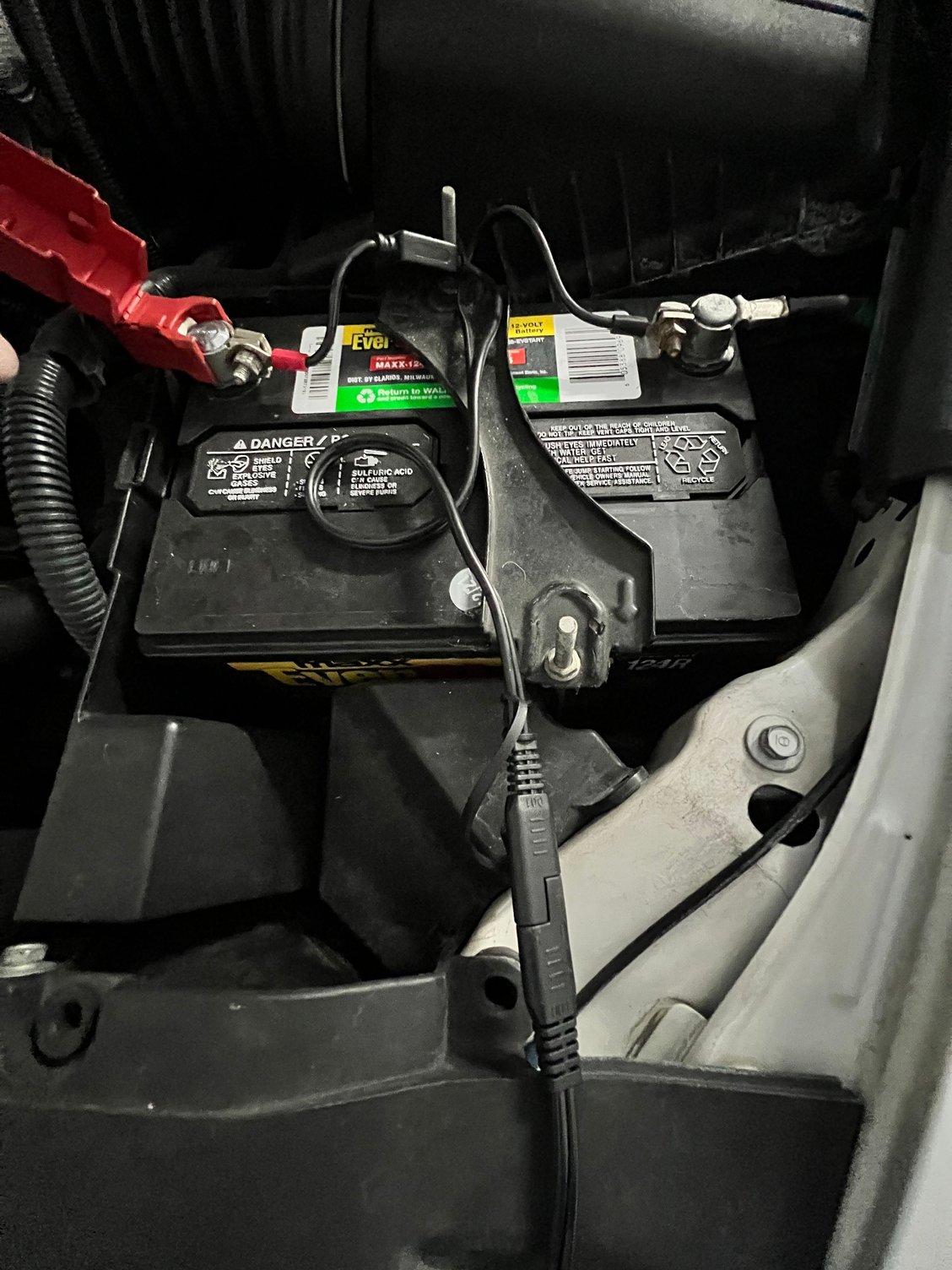

Ended up doing it like this, probably not much different than hooking it up directly to the battery. I read that I should leave the hood open for ventilation. I wanted to wire it in such a way that I could keep the battery cover on and just have to barely pop the hood and plug it in, and keep the hood mostly closed. Any thoughts on that? Or should I just stick to leaving it opened all up like that? Also, this might be a stupid question, but i read something about making sure no accessories are running while its on there, is it a problem to open the doors and have the lights come on? I do have the Diode Dynamics bright leds...

I would connect directly to the battery post.
I left my hood open. I unclipped the plastic trim that covers the battery and left it on top of the engine...which meant I had to leave the hood open.
On other cars, I just run the battery tender cables up the bumper grille, into the underhood area, and clip directly to the battery. I close the hood. Or leave it popped incase I am a dumb mf and forget that things are plugged in.
I would avoid leaving any accesories RUNNING that will draw more amps than the tender will put out. Because then it won't charge the battery
Don't over think this.
  • Plug into the battery posts.
  • Close the hood, or leave it popped, or take it off and throw it in the woods. It doesn't matter.
  • Don't leave doors open or lights on.
  • No, its not an issue if you need to turn something on momentarily
Think of the battery tender as a weak alternator. You don't do anything special like leaving your hood open or plugging the ground side to the fender when your car is running and the alternator is charging the battery. So...don't do anything special with the battery tender plugged in either.

100% agree with BROlando. I use a NOCO 3.5A trickle charger to top off the charge when I haven't driven my 08 TL-S in a while. I try and drive it once a week, but that doesn't always happen. It can be 2-3 weeks between drives so when this happens, I connect right onto the battery posts and leave the hood open - just as a reminder.

Thanks guys! That was the perfect response I needed: "don't over think this" my biggest problem in life!
