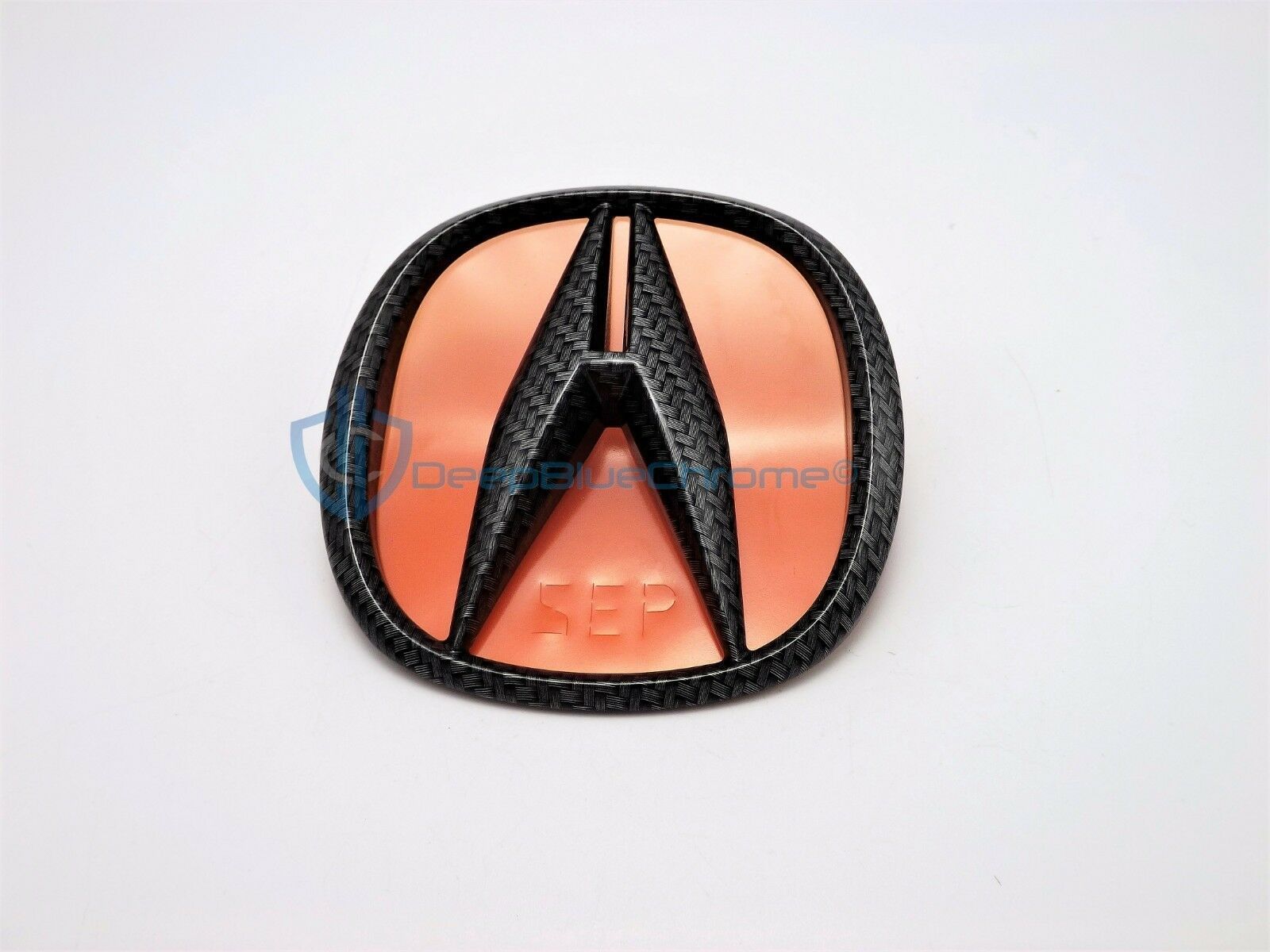

I am going to be replacing the Acura logo/emblem on the rear center part of the trunk lid with the one below. I know there are 2 holes underneath the emblem, I assume there are clips as well as adhesive tape? Guess the question is do I need to get to them from the back of the trunk lid. I saw a video on youtube where the emblem just came off with some heat and some floss, they didn't show the clips or anything being done from inside (or the back) of the trunk lid.

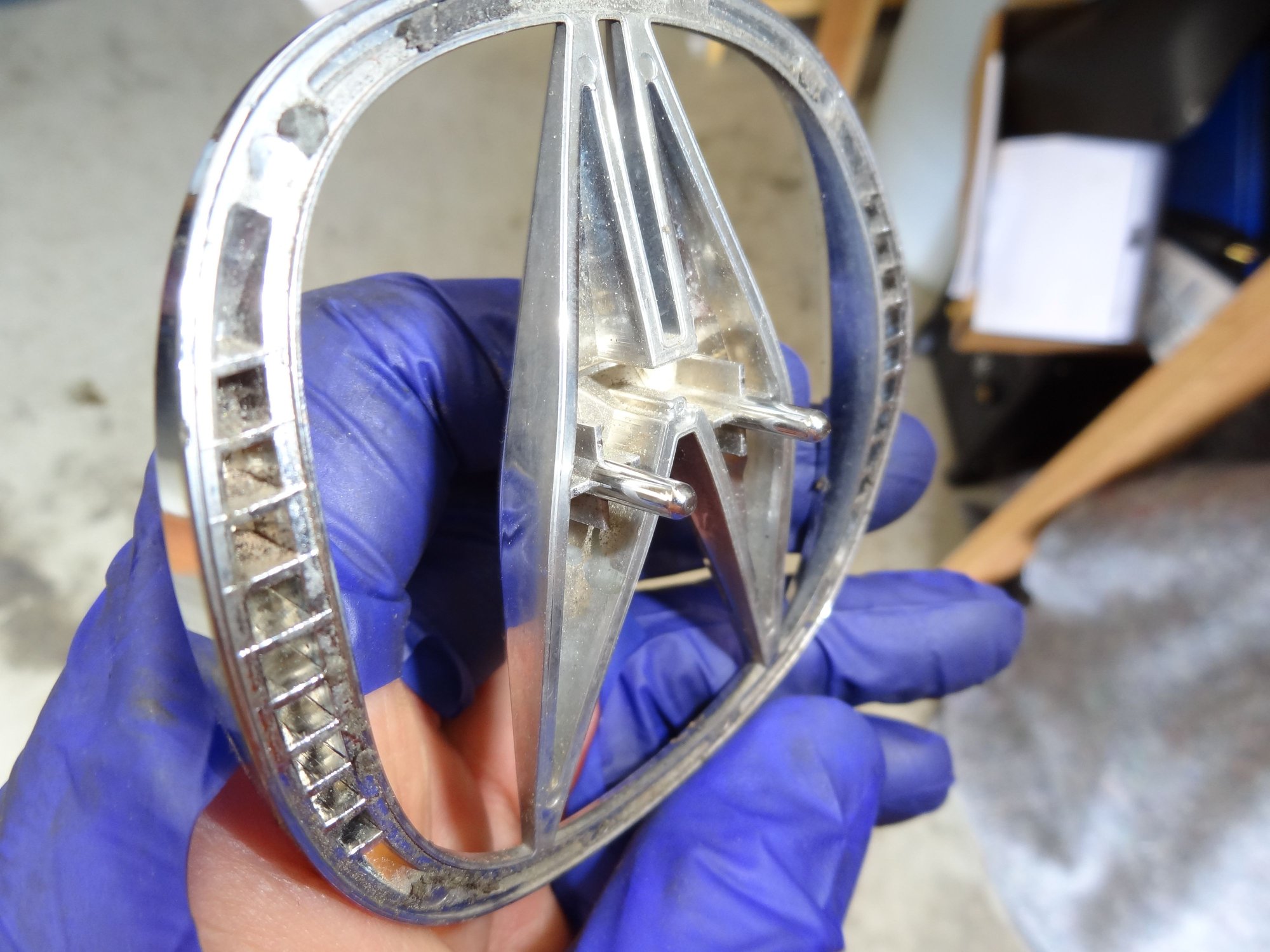

Just for reference, this is what the underside of the OEM emblem looks like.
A good idea to warm the emblem "ring" with a har dryer so the adhesive warms and its easier to peel the emblem off without breaking it.

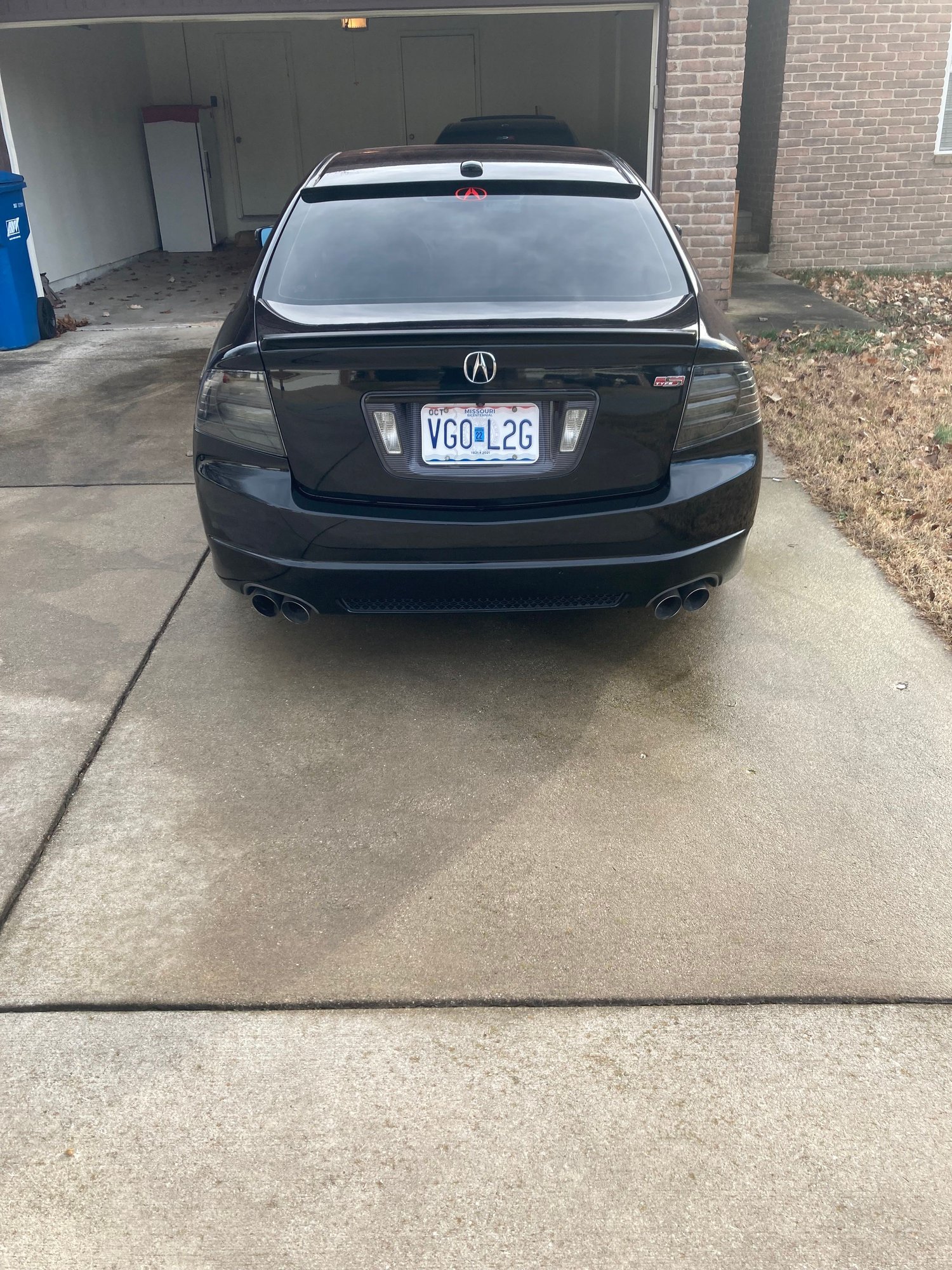

Yep got a heat gun from a work buddy so that's the plan. Floss or fishing line..or does it really matter...can't imagine it would. Previous owner already debadged the "Acura" as shown, I think it'll turn out decent.

Turned out pretty decent, imo....
