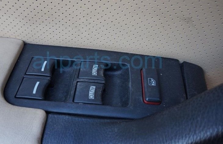

If it works fine from passenger's switch, but doesn't from driver's (master switch) then suspect master switch.

Maybe just take some crc qd electronic cleaner and spray clean it real good, if you have the skill set to remove?
If you would like to 'roll the dice', here's a salvage one for $49 before shipping.
2004 Acura TL Power / Master Window Control Switch 35750-SEP-A02 (ahparts.com)
Otherwise, it's OEM master switch for $234.44 before shipping.
83560-SEP-A01ZA Genuine Acura Part (acurapartswarehouse.com)
