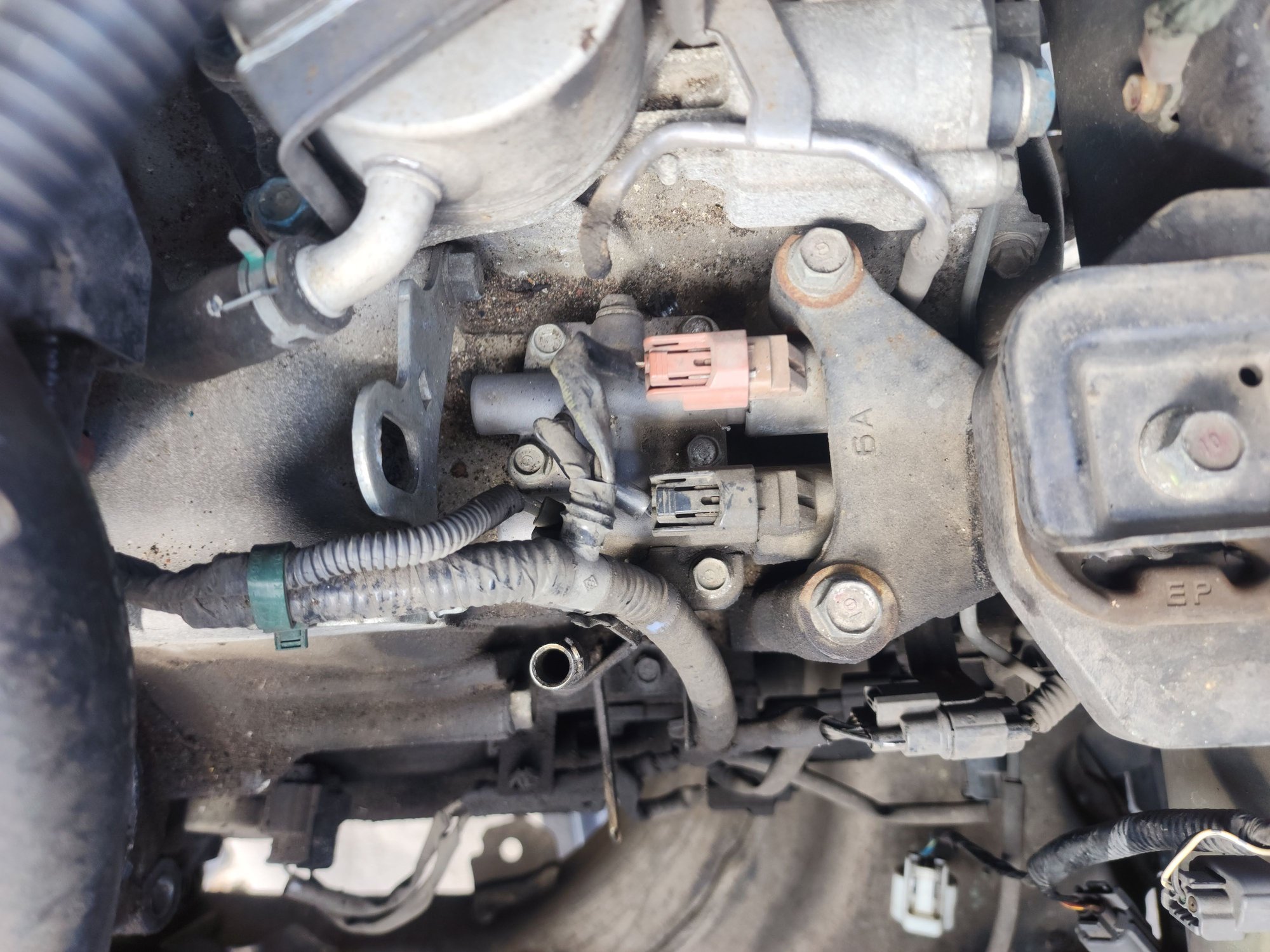

Send some pictures of the part or installation or your work 😉
If you did it yourself ensure the car gear selector is aligned to neutral, straight with the position on the neutral safety switch when installingORstraight and align the switch itself VERTICALLY to the markings. Remove everything to inspect and reinstall.If you had your old parts you can try and play if it was or wasn't defective. SLUGGISH drives after tranny change with filter on the side in engine bay.Check connection on Transmission solenoid in the picture and it has to click properly. It can be hard to notice on dirty and oily plastic connectors in picture. Clean the 3 metal pipes and screen. A good one has no gunk. Refit the gasket and screws with 2 connectors. The blinking D light is also a low transmission fluid symptom since that is not you, you have a gear problem. 😉
