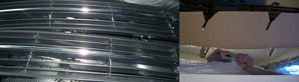

So I got the original idea from threads like:
https://acurazine.com/forums/showthread.php?t=98149
https://acurazine.com/forums/showthread.php?t=101254
I tried the mod using 'Trimbrite' door molding (from pep boys) many months ago. I liked the way it looked from the front, but did not like how when standing in from of the car you could see how the chrome didn't cover the whole depth of plastic bar. The bar measures about 1 inch deep, and the molding is between 1/4 -1/2 in. So I took off the door molding and thought about other ways to accomplish this.

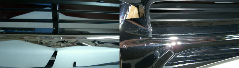

So here is my twist on it. I used metallic chrome tape on the inserts. It is definitely a difficult task due to the curvature of the insert and how you will need to bend the tape around it. I applied the tape to the top lip of the bar first, then to the front, and lastly the bottom (which is where the creases will be). You will get creases no matter what due to the curvature, so the bottom is the best place. Since the tape covers the whole bar, i'm fixing the problem of coverage caused by the door molding. It seems best to try cutting the tape to fit first then trying to apply it first, then cut due to the vertical bars.
And now for some pics:
The application process (top first):
below you will see some creases starting from the bottom edge:
finished inserts on passenger seat & the template I had to make to get the cut right:

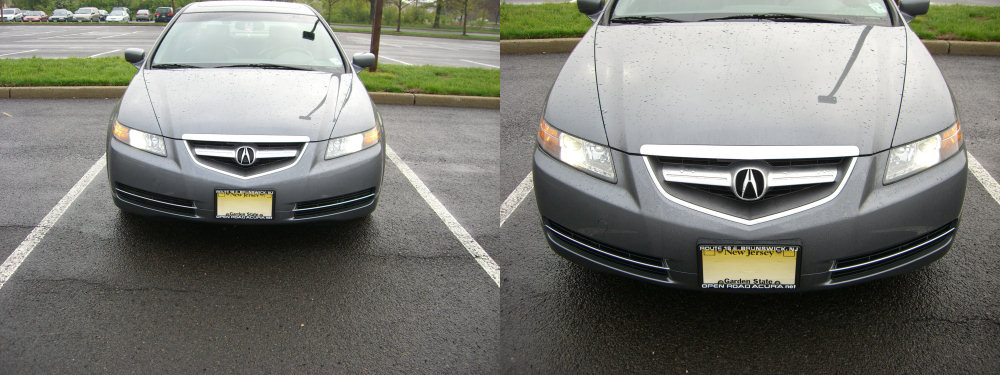

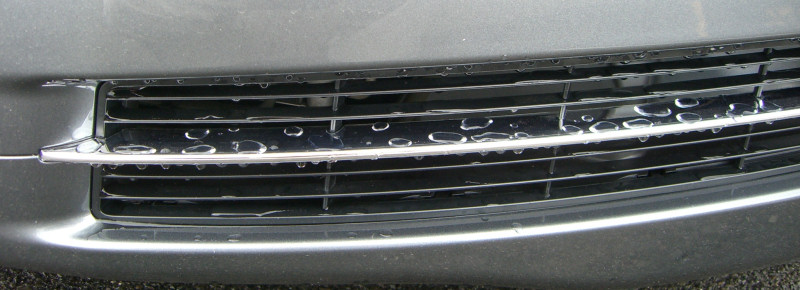

chrome reflection on the whole piece:
I will try and post more pictures later. I just did this yesterday, and put them on my car this morning. I have no idea how well these will hold up yet. I've read from the people using the door molding the the chrome starts to bubble and come off, but this is different.
If you are worried about ruining your current ones, you can purchase the inserts new from acuraoemparts.com for 5.26 a piece.
What do you guys think?

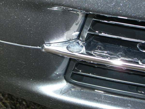

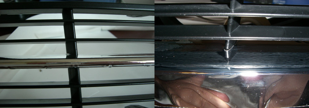

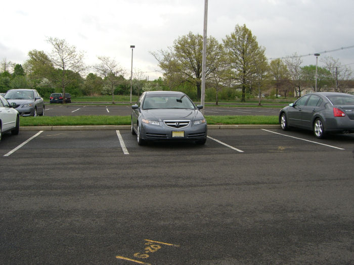

Here are a few more pics:
