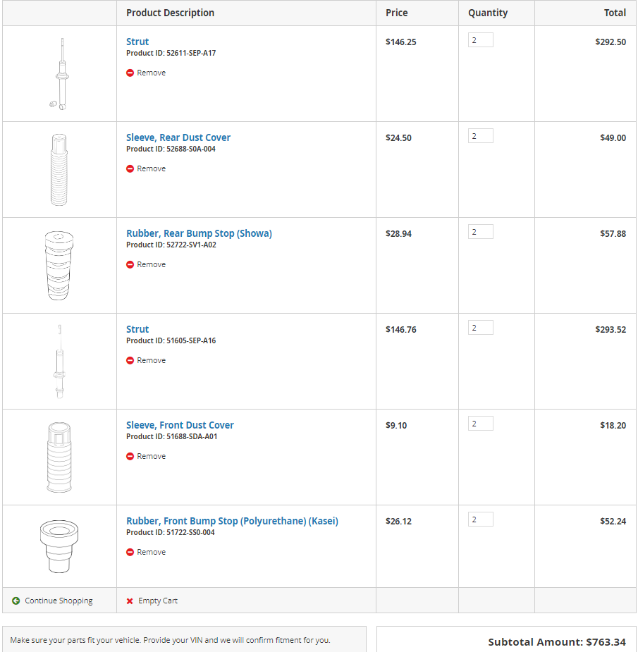

I am not sure where you get that over 1k pricing from? If i ever redo mine, these are the component I will be purchase. The pricing showing as of today, when these was cheaper all four corner will run you around $875 after shipped and taxes and this was about 4 years ago.
@04WDPSeDaN

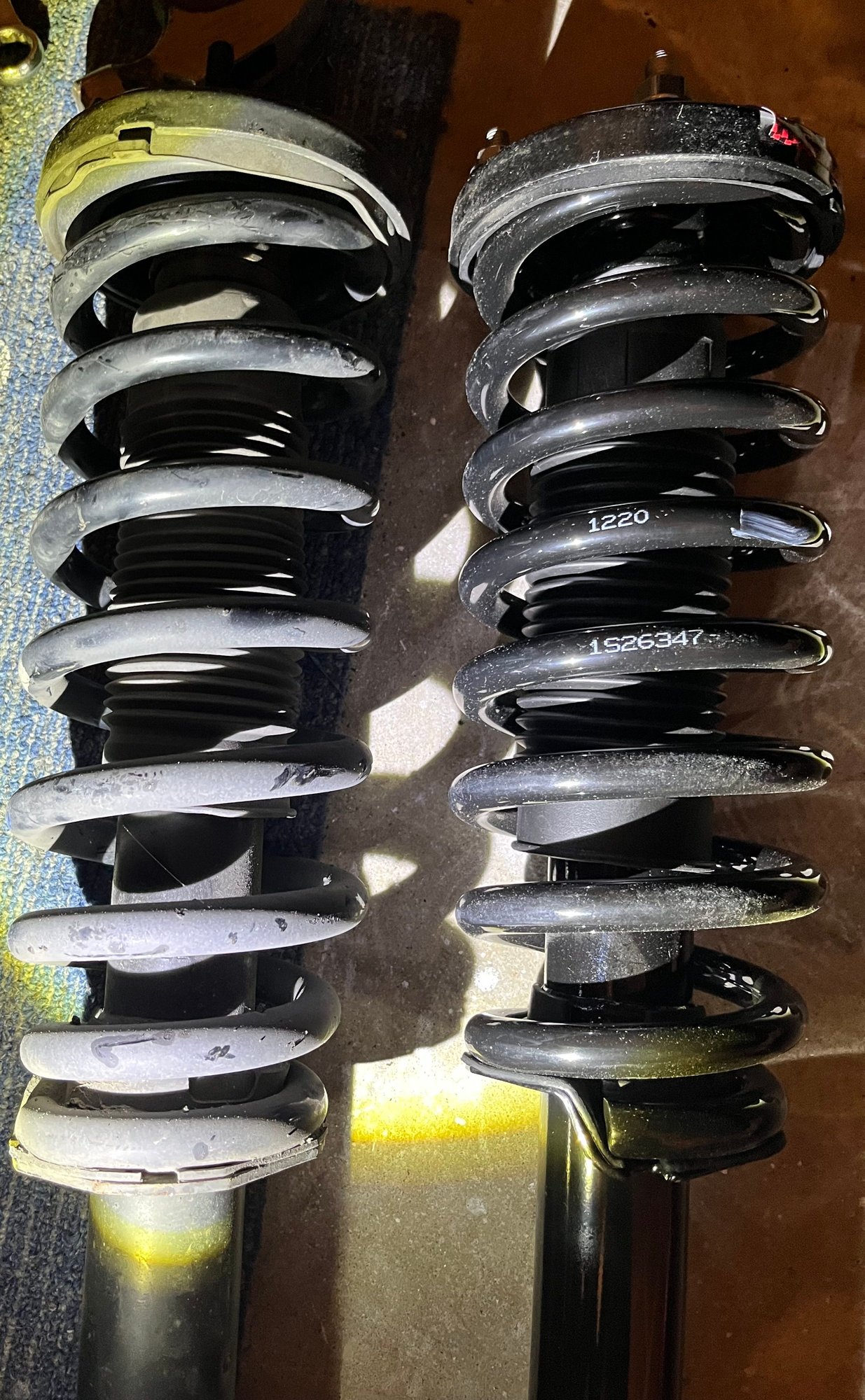

I just bought FCS from Home Depot and put them my front going to do the rear.

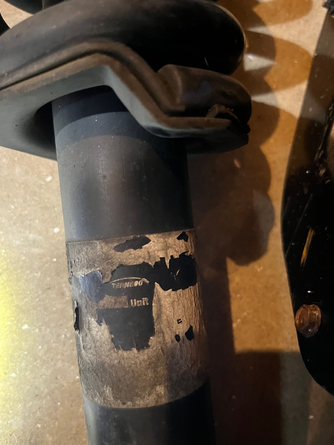

What brand are the old shocks?
Old Jul 29, 2022 | 03:37 AM
CenturionTL's Avatar
Posts: 389
Likes: 30
Ok they are Tenneco a brand of Monroe.
