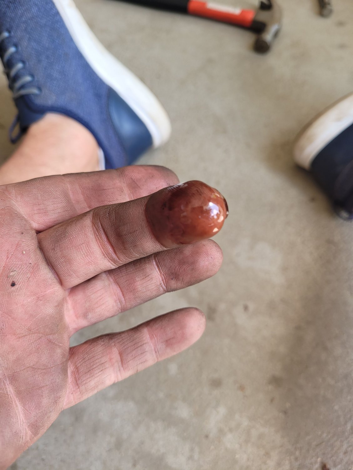

Hey All,
So I recently did the front valve cover gasket on my 07 TL and after I was done I sprayed some engine degreaser to grt all the old oil off the manifold. That seemed to work as I no longer smell that burning smell.
But I noticed a leak coming from the frame? I wonder if the oil and degreaser that I didnt get when i sprayed it off is just coming out?
It is a solid leak. I checked my oil amd transmission and they dont seem to be low.
Anyone have any ideas?
I posted 2 pictures. It seems to be a redish color and just smells like grease.
Thanks all

Frame doesn't have oil in it to leak from, you'll need to determine where the leak is coming from if it's still an active one

Yea I am aware that the frame doesn't have fluid in it. It just seems to be thst is where the leak is ending, right at that bolt.

Red = usually ATF.
Drivers-side is where the transmission sits.
Clean the entire area THOROUGHLY with more brakleen so there's no more mystery oil/leaks. Start the engine then start snooping around. I bet you'll find something suspicious eventually.
