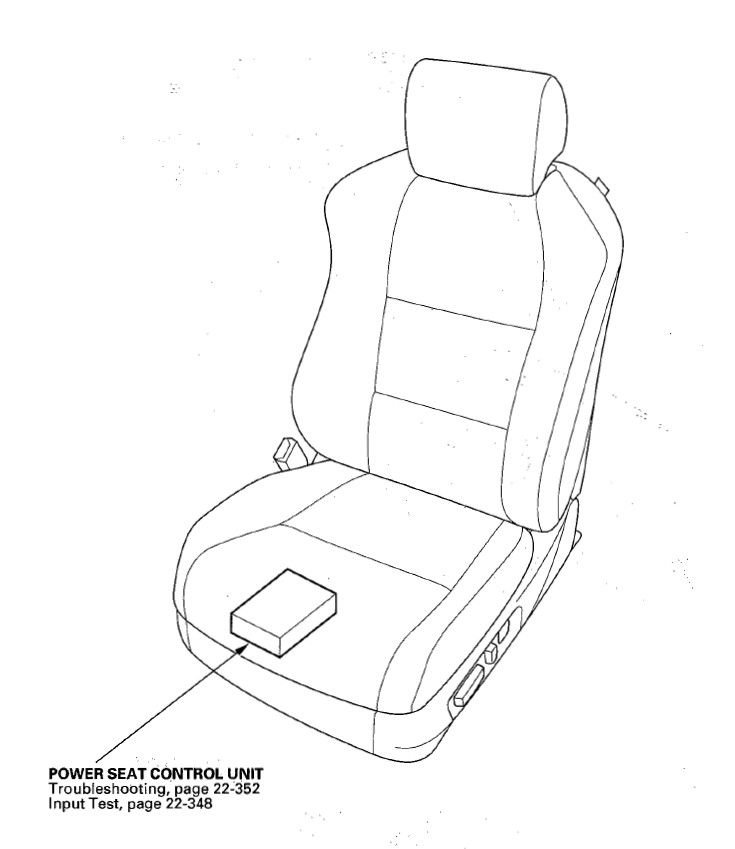

The service manual says the "Power Seat Control Unit" is under the seat. It is not. Unless it's buried in the cushion, or only here in an automatic, this diagram is wrong. I was hoping to position the seat the way want it, unplug the control unit and be done with, but no such luck so far. My copy of the shop manual is missing the pages referenced below, conveniently.
