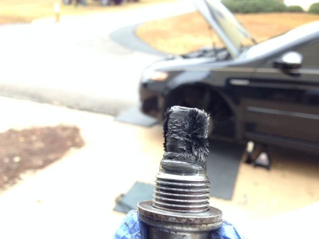

Got around to doing the oil change, pretty simple process of removing the plastic cover under the car, a 3/8" ratchet fits the drain bolt (no socket needed), just shy of 3 qts came out. I measured it to be sure and also checked the oil for any large objects. Replaced the bolt - torqued it (36ft-lbs). There is a ATF filler bolt on top and is accessed from the engine compartment. Topped it up with 3 qts of DW-1 honda tranny fluid. Tightened the filler bolt (33 Ft-lbs). I used this video as a guide:
I took pics of the oil drain bolt magnet, no large items after 97K use.

Not his video, if you look at the magnet you'll see a black TL in the background. The white TL is just another user video.
