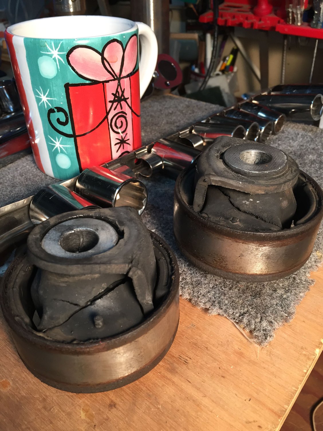

Check compliance bushings on the lower control arm for cracks as they usually fail by 60K miles or even earlier. Also check engine mounts.

Thanks for the input. I purchased the car (burgandy 06 TL with 82k miles) and love it! PO had the trans fluid changed at dealer about 9k miles ago and fluid still looks and smells ok. I'll be replacing the pressure switches soon and will probably plan on 3x3 trans fluid change about every 20k miles. MikeTC - motor mounts looked good, but I'm not sure what lower control arm compliance bushings are. I'll look into those and check on it.

Compliance bushings.

hpcacura, you could read all about the compliance bushing failures and fixes on the following link:
https://acurazine.com/forums/3g-tl-p...d-look-707888/
Good luck with your new ride!!
Old Nov 24, 2016 | 08:15 AM
MikeTC's Avatar
Joined: Oct 2012
Posts: 160
Likes: 21
Here are my failed bushings at 115K miles:
