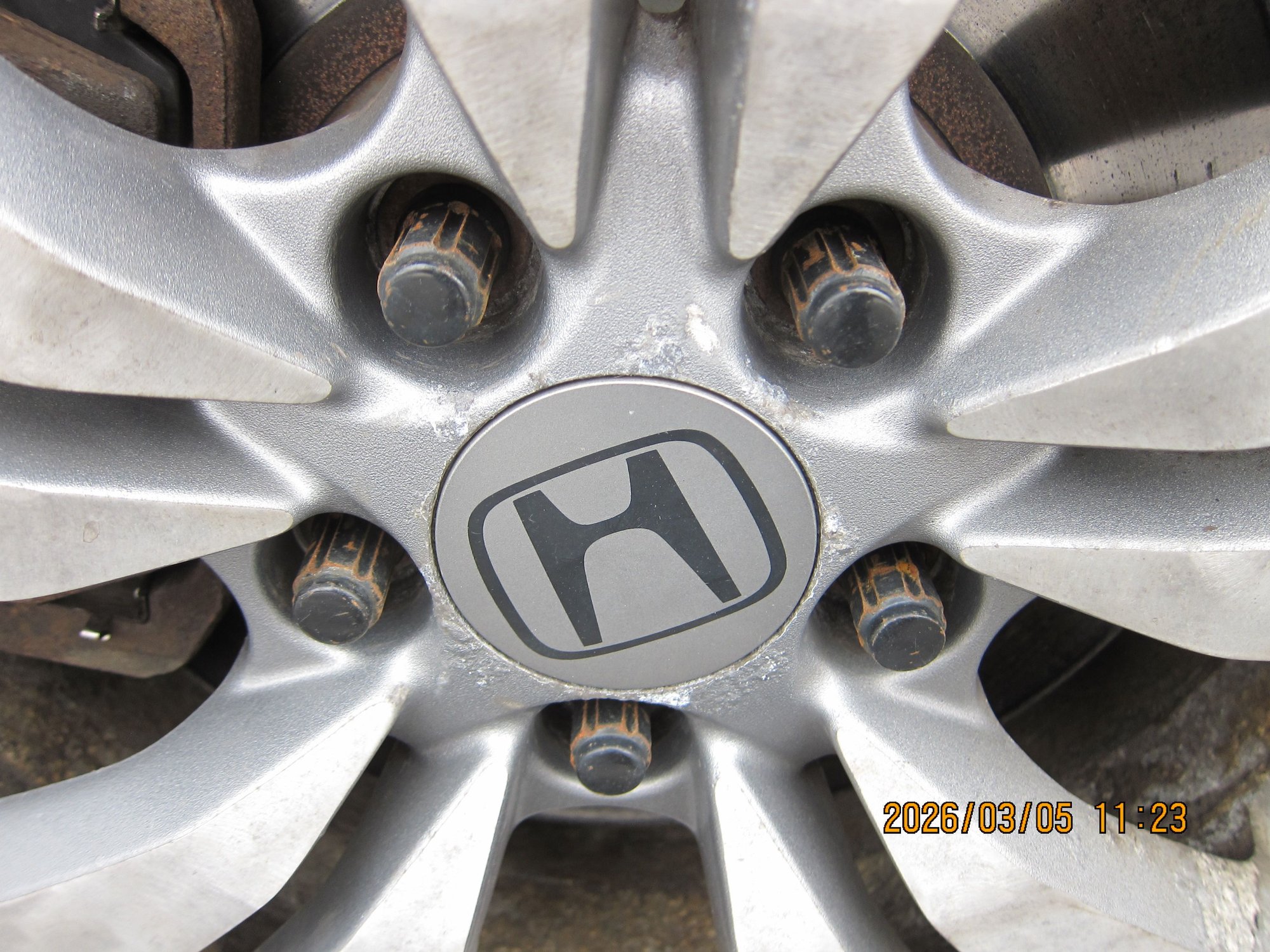

Hi all i have rlx hybrid, and i have very strange, /Unkown Wheel Lug Nut on my car wheels how to remove them? No secret key, and no clue how to remove them we tried several options so far nothing..
Please see attached photo below. how to remove them i have them in all of my wheels... tyre shops in europe and stores for wrenches also doesnt have them i need to figure it out how to remove them.

They look like security lug nuts that needs an unique key to fit over grooves on the lugs to remove. Hopefully, the original owner "might" left the key somewhere in the RLX (glove box, center console, trunk).

Those are called spline lugnuts. I have them on both my cars. There's a tool for them that most parts stores carry.
You can also hammer a 12 point deep socket onto them to get them off. I think 19mm is the size you want for that but can't remember for sure.

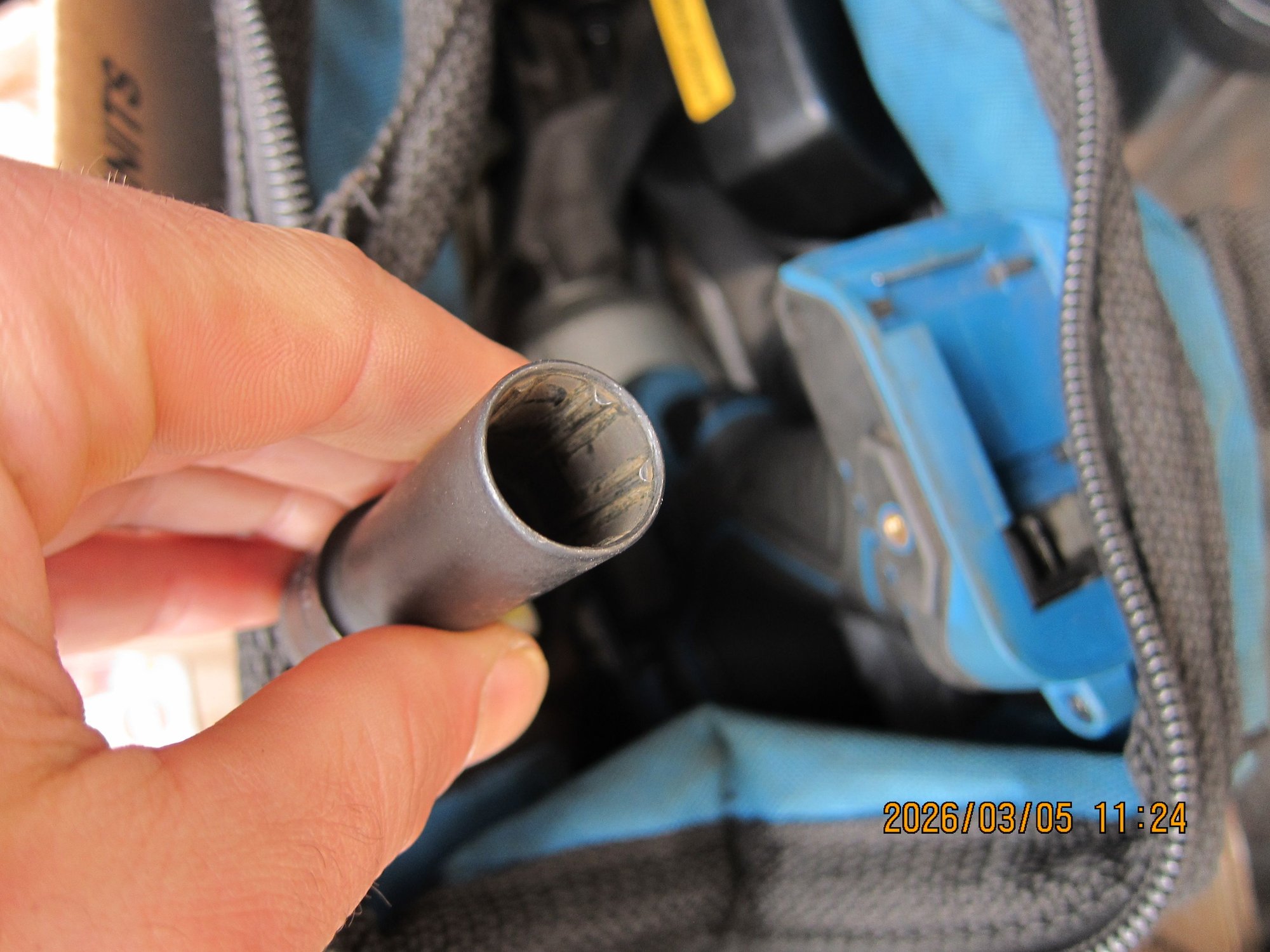

thanks i tried with my toyota genuine lug nut key it doesnt fit its too big. How good are these lug nuts, should i replace them with original genuine one? i have genuine alloy wheels and i dont trust them much i also have already damaged 2 wheel lug nuts are missings and i am also missing bolt wheel where lug nut sits.
