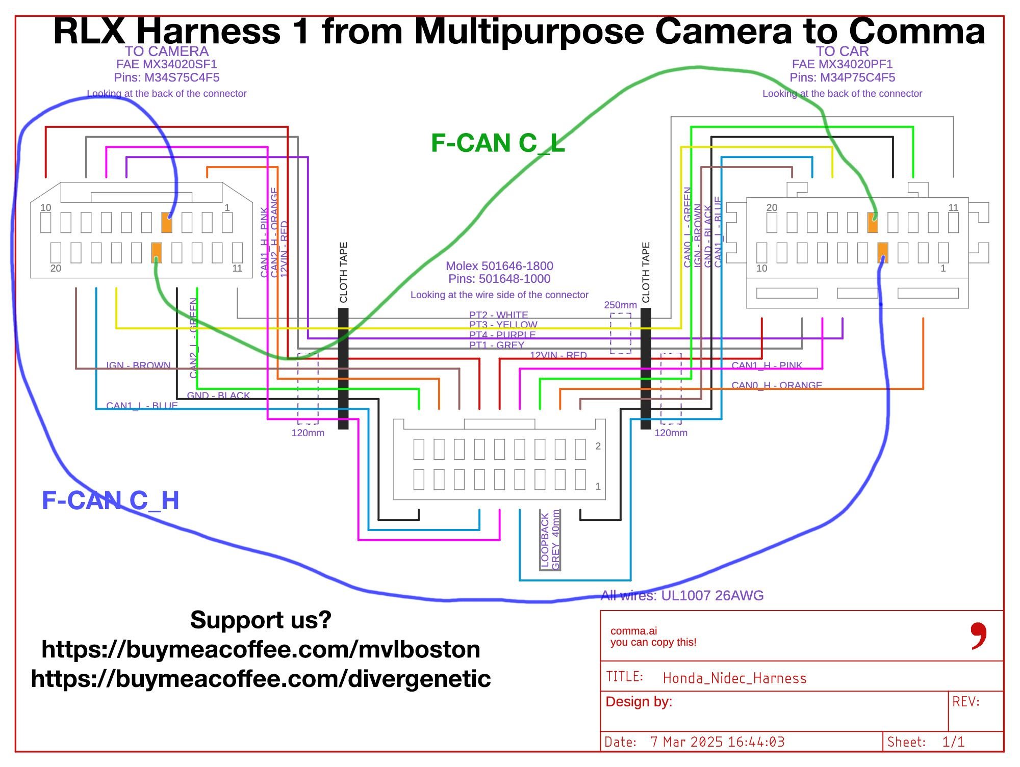

I’m so glad this thread is alive and MVL is here! With his immense knowledge and kindness, my 2016 RLX essentially has highway and traffic autopilot. Lane centering at all speeds, automatic resume from stop, and it can now see when it’s approaching stopped cars and automatically stop. Still perfecting everything, and this is by no means an autonomous system, but it is already incredible. I will make a youtube video eventually on this and will work on a wiring diagram.
In the meantime, it is wired as follows:
You do need two comma nidec harnesses, and one Red Panda. The harness closest to the camera has a passthrough for steering fcan-c high and low, and plugs into comma via usb-c. (The stock Comma Nidec harness does not have wires where that CAN line is and has no way to feed it into the Comma without the Red Panda.)
The second harness plugs into the end of the first and moves the fcan-c high/low lines into CAN 0’s high/low connections and passes through CAN 0 high/low, and plugs into the Red Panda via usb-c. I 3D printed an enclosure since the wiring can be a mess if not well managed, but that is a work in progress. Main goal is to move the FCAN-C high/low lines into a usable input for Comma, and that has to be the slots for Comma’s CAN 0 inputs. Feel free to reach out to me on discord anytime. I’m happy to assist if I can. I’m divergenetic on discord and definitely will get notifications there before I see anything through Acurazine. Please keep in mind: it is possible to damage your car, wiring harness, modules, camera, electronics, create fire hazards, and crash with this stuff. It could be dangerous, so please know the risks. Do this at your own risk. But I love it.

This is the high level diagram we based it off of. But @not_a_doctor can get you the specific pins.
Attached Thumbnails Openpilot / Comma AI Support / Driver Assist Upgrades-rlx_diagram.png
