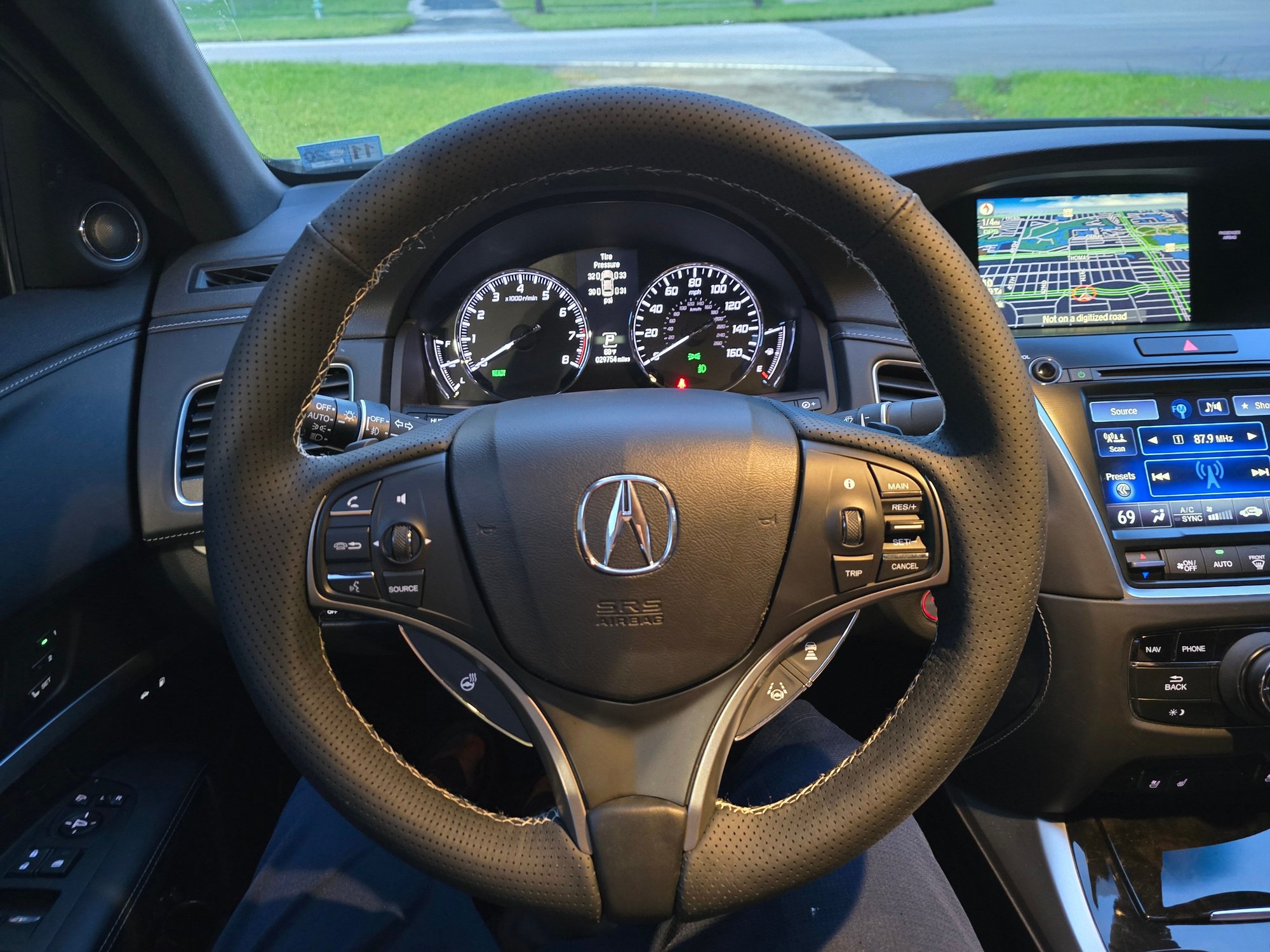

Finally installed the steering wheel
Finally, the genuine perforated leather steering wheel is installed. Heat function still work. Thicker, beefier hold.... Very easy to install, 3 screws (2 holds the airbag, 1 center nuts). No need for steering wheel puller. I did swap all the button controls...
Wow, it looks amazing!!!
How, where, and how much does ti cost?
Is the heating feature "weakened" or is it pretty much the same amount of heat?

I think the heating weaken a bit, but can hardly tell the difference down here in FL. I had the cost listed in my other post when I first got it done. You'll just need to source the part from ebay (MDX and RLX steering wheel, should be between $50 and $200) and take it to a professional steering wheel wrapper (you can ask for different color, material, design, etc). Basically adding an extra layer of leather to the existing one. The heating wiring can be left un-touched.
Old post: https://acurazine.com/forums/3g-rlx-...-guess-997128/

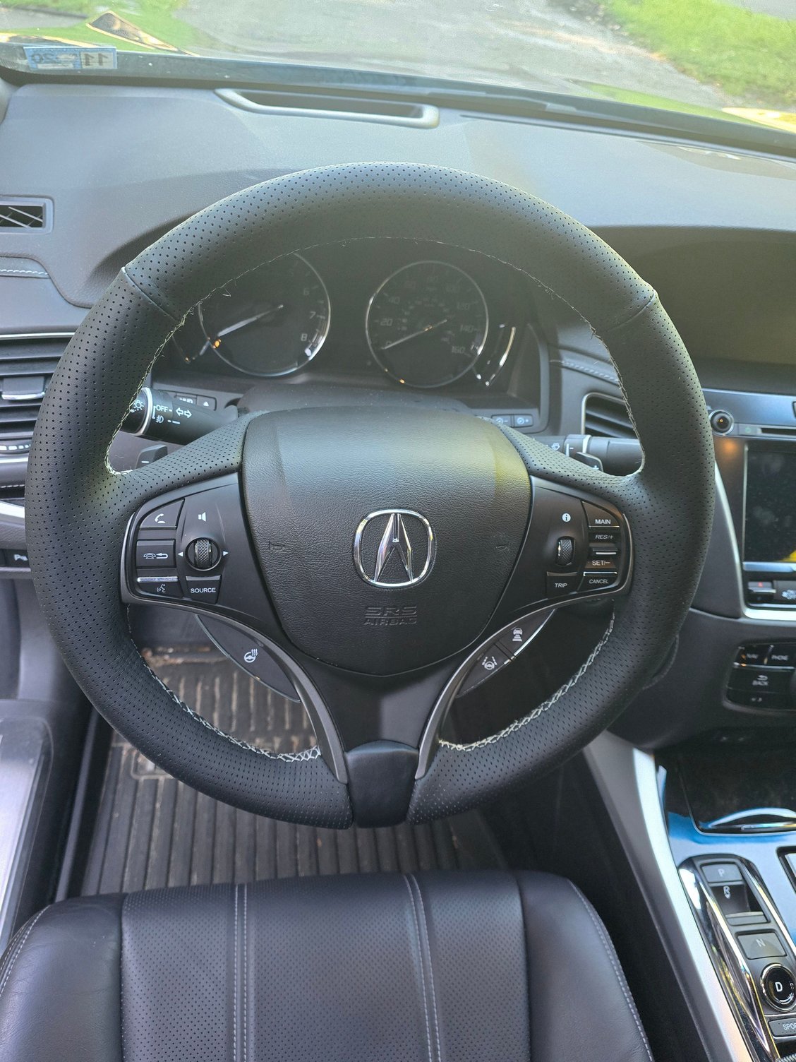

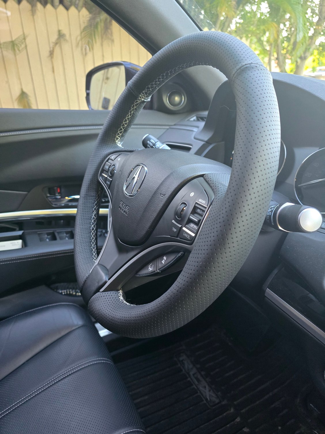

Some more pictures from a different angle
