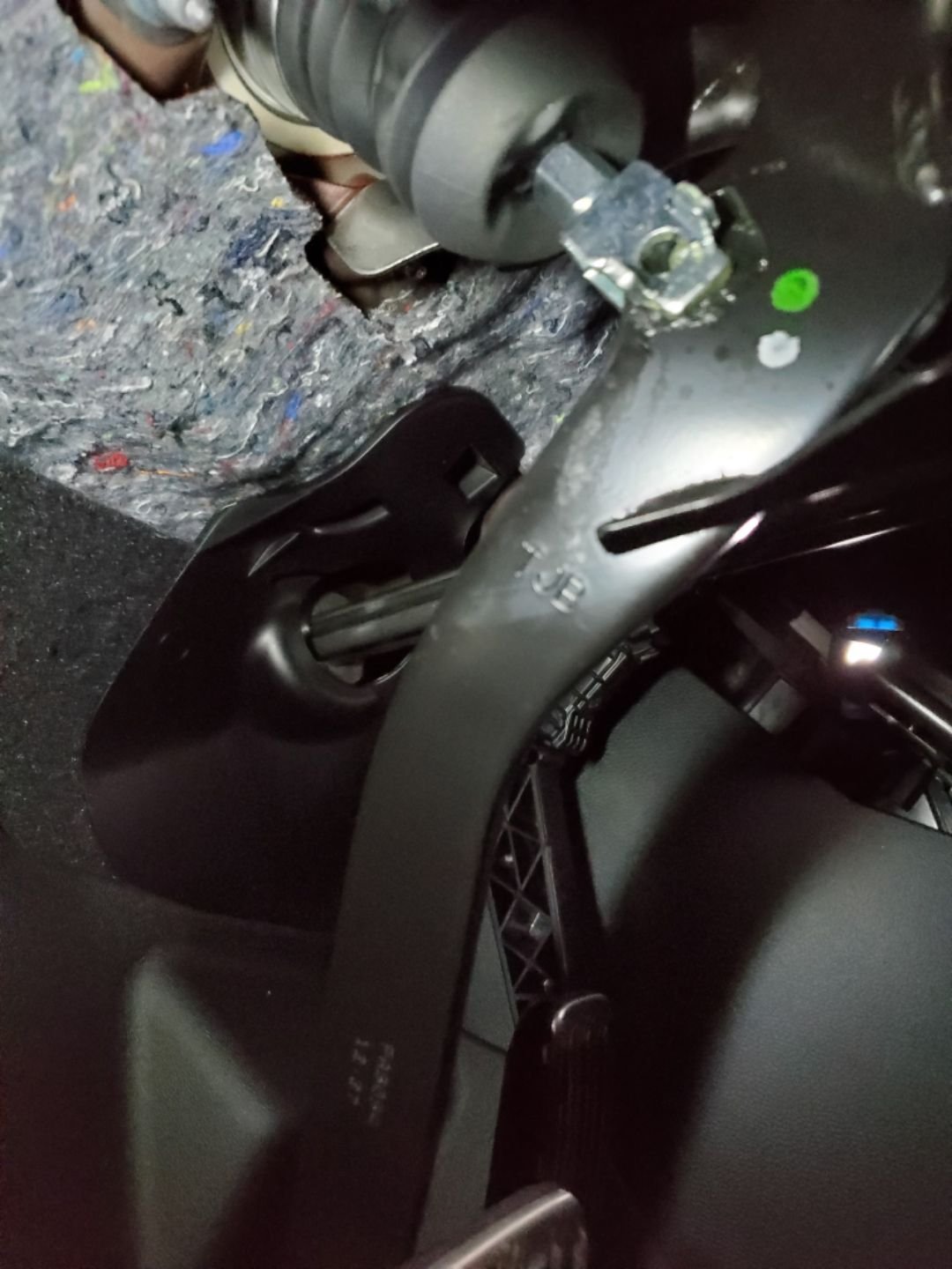

This evening wife came home indicating "something fells apart inside of the car". Car is two weeks old - 2022 RDX A-Spec Advance.
She hands me a clevis bolt without the pin, indicating the brakes felt weird.
From what I can tell it doesn't appear Honda actually inserted the clevis pin into the assembly as there was no broken pin to be found anywhere on the floor mats. Anyone else encounter this "little surprise"?
Fortunately this happens as she was pulling into the driveway.
Before and after MacGyver repair pictures are attached. This will be a very pointed conversation with the dealer tomorrow.

Hopefully they own up to it and don’t claim that you must have pressed down on the brake pedal too hard at an angle while mercury was in retrograde and knocked it out.

I don't see how they could - I would have the broken cotter pin in hand. Even so, this reeks of poor assembly and quality control.
