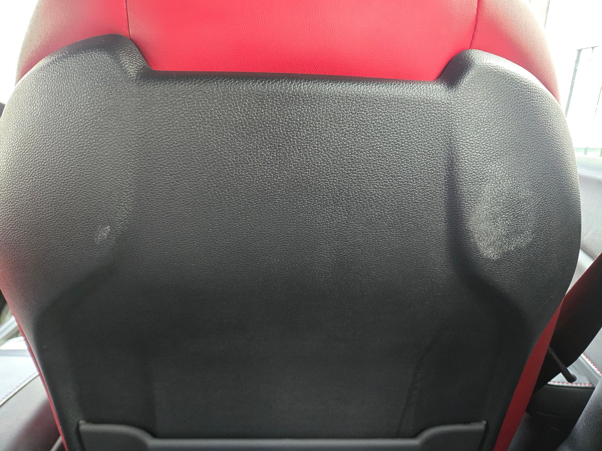

I somehow scuffed up two spots on the back of my passenger seat panel trim, probably from helping someone move. I first thought it was a stain, but soap and water with a microfiber cloth didn’t really do much. Any tips on how I can fix or at least improve the look of it? I’d prefer not to spend around $150 for a replacement, but it’s bothering me.

armor all is trash product, it will ruin your interior, please don't use it. Just get a quality interior cleaner like https://www.griotsgarage.com/interior-detailer/
and a microfiber cloth

x2, do not use armor all on your interior if you want it to last.
I use Optimum No Rinse and a microfiber on the interior. Dilute it to 128:1 or 256:1 with water.

If it is terribly bothersome, one way to adequately 'cover' that abraded plastic is to spray it & the rest of the panel with an aerosol like the one shown below.

Try one of those detailing brushes you can put on a drill or similar, use a good quality detailing spray(CG, Gritos, etc) and see if that works

Also Armor all isn't as bad as mentioned above.
Worst comes to worst, you can spray that Dupli-Color spray onto a piece of carboard or in a cup and spot touch it up with a foam brush too.

Magic Erasers are actually a very fine abrasive. With a light tan vinyl I have had success removing spots using the magic eraser in conjunction with Meguiars Vinyl/Plastic Cleaner/Conditioner. Just don't rub too hard.
