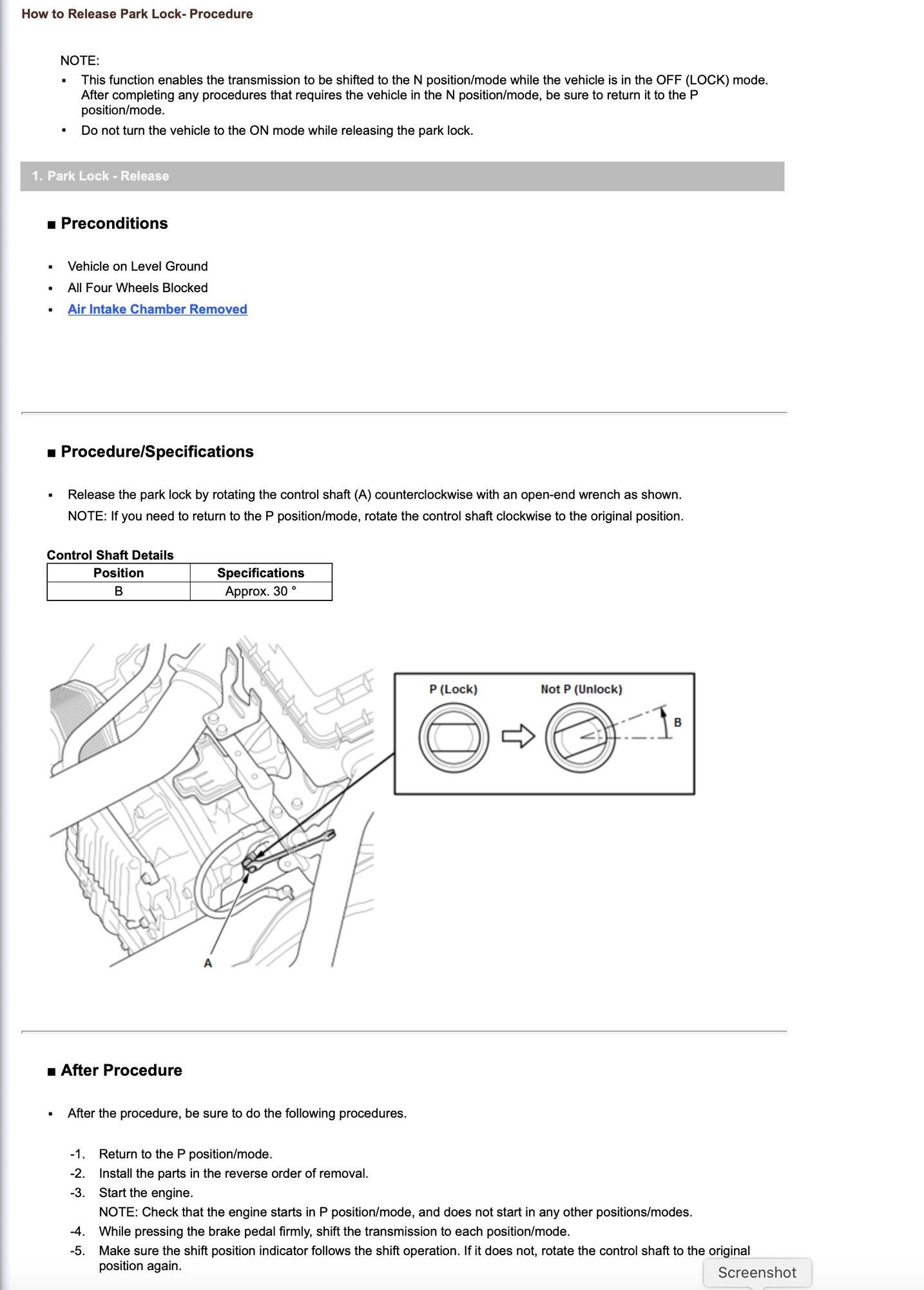

Originally Posted by agent_gru
Towing it was fun because we couldn't put it in Neutral,
Glad you're back on the road.
For future reference, whenever you need towing a 2019+ RDX, use the below instructions to switch to Neutral when battery is completely dead or vehicle cannot start
Yes I know, it is a PITA
