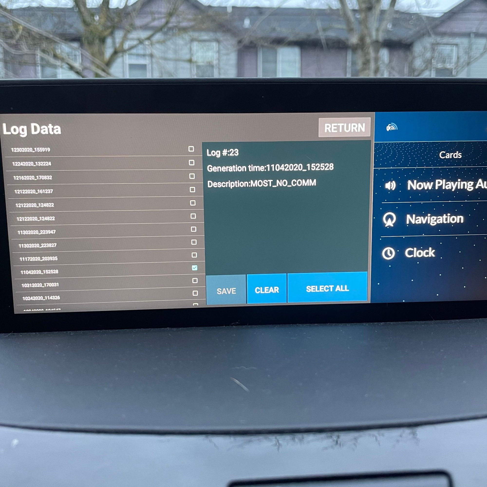

After going to 3 button, you go to self diagnostics, then go to errors. Then they have hardware errors and software errors. I used to have a hardware error when problem happened on 12/29, but it looks like it error log got overrun with some other crazy errors. I guess this thing constantly logs errors.
I only got it documented now in software section, but after it happened it was also logged in hardware error, if I remember correctly it was 57D something error. Need to go this section before shutting down the car after this error, other wise it will clear.
The funny part, you can't go with this stuff to dealer, they would not like you poking around in diagnostics. you might even get blamed for breaking it.

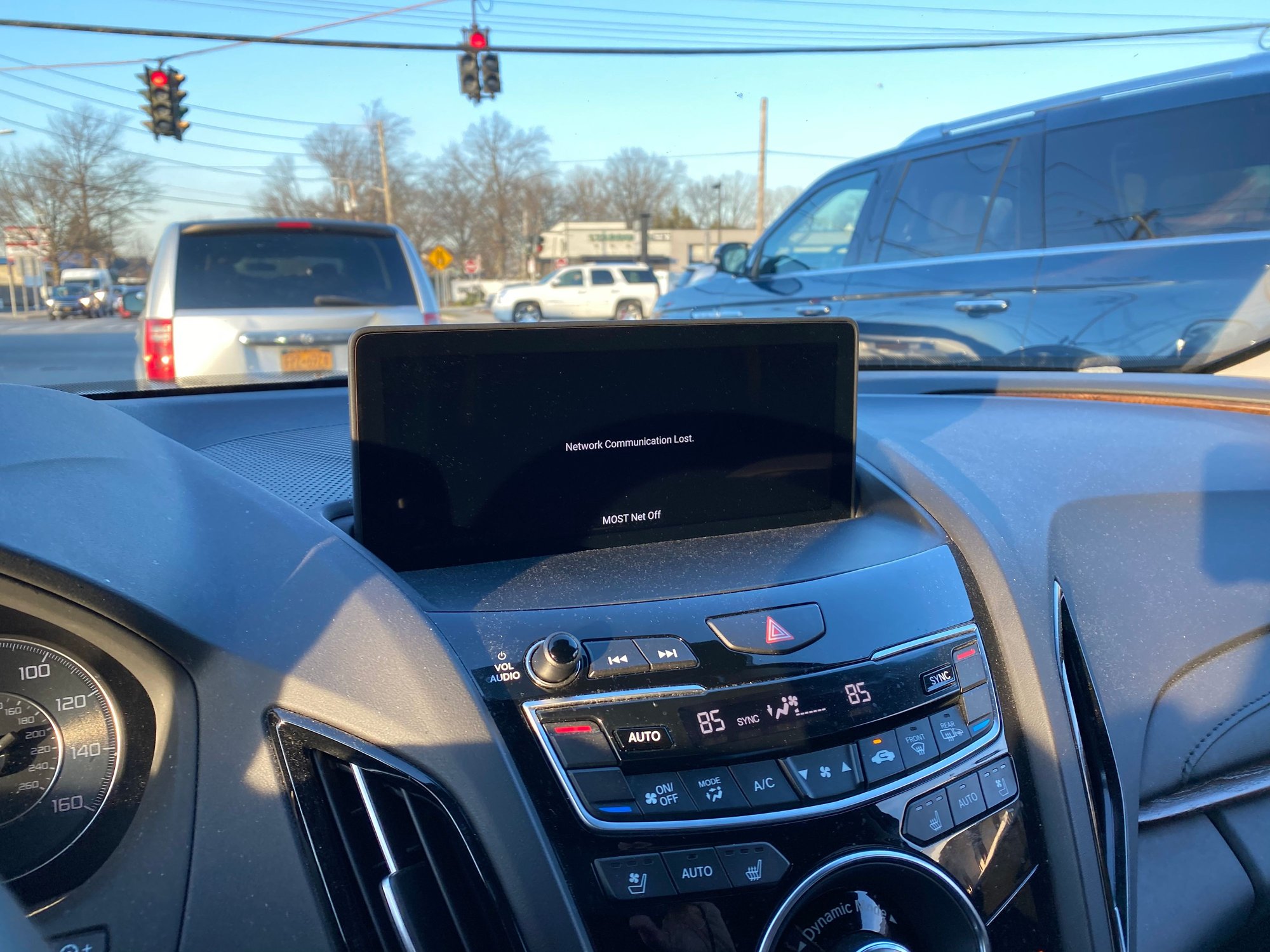

TSB wire replacement did not fix
Having the same issue with my 2020 A-Spec. Have 8800 miles and purchased in May 2020.
I’ve had multiple occurrences of the failed network comms issue. Only was able to get a photo of the second error (before the fix) and the third (20 mins after leaving the dealership with the “fix” in place). Hunted through the logs to find the same error code aligned with my time stamps from my photos. Three instances below plus photos of the issue.
After replacing some wires and then having the issue happen almost immediately after leaving the dealership they tried to give me the run around about it being a software issue tied to using Apple CarPlay and a future fix was coming. Until then they suggested I not use CarPlay.
I politely let the service rep know that I work in the software space as a federal contractor and as such, have a bit of experience with software and application development. I explained that it was deeply concerning that by simply plugging in an iPhone, my vehicle could randomly lose critical vehicle functionality some of which is federally mandated (back up camera). I suggested they take more time to look through the logs as Acura’s engineers surely would want to be aware of such an issue.
After looking at the logs the technician wasn’t able to determine any new information about the issue so the dealer had me come pick up the car.
They’ve let me know the next step is for the technician to speak with several Acura Engineers/Technicians tomorrow on a call and get back to me as to potential next steps.
Im doing my best to be patient but after reading about other’s experience with this issue, I’m concerned about Acura’s ability to fix and the long term impact this may have on the value of my vehicle. This was my first “big purchase” I made for myself having hit some important career milestones at 29 and aside from this and a few other infotainment bugs (resolved with Apple shortcuts and posted on here previously) I deeply love this car.
I am hoping they’ll have a path forward after tomorrow’s call. Otherwise I’m worried I may need to explore Oregon’s Lemon Laws to see what my options may be if a clear path forward and timeline is not presented.

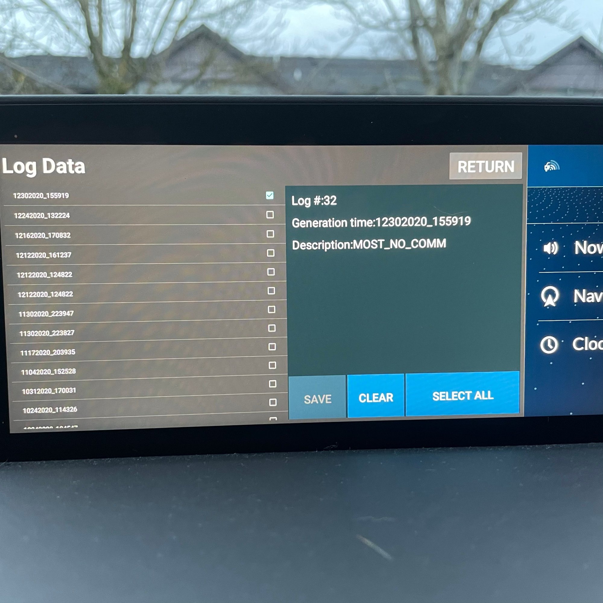

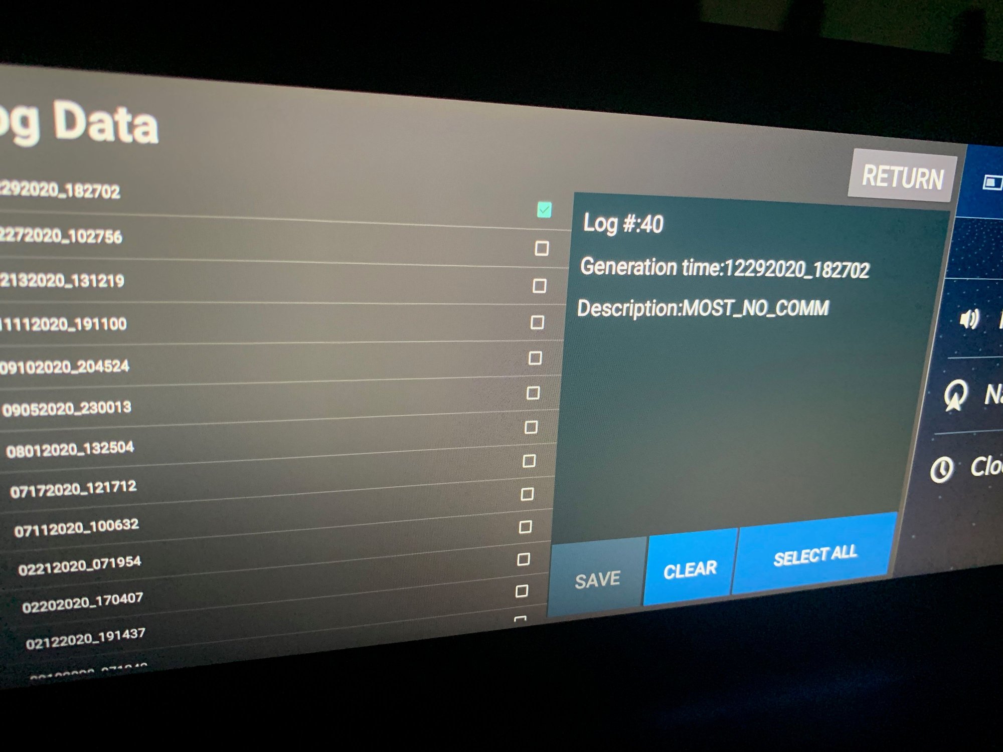

I was able to see error in hardware error logs, it was something with 57D, After I restarted car, it got cleared. I will definitely take picture.
here is how I know its hardware. Not everyone has this problem, and TSB that replaces connectors does make it a lot better (at least for some people).

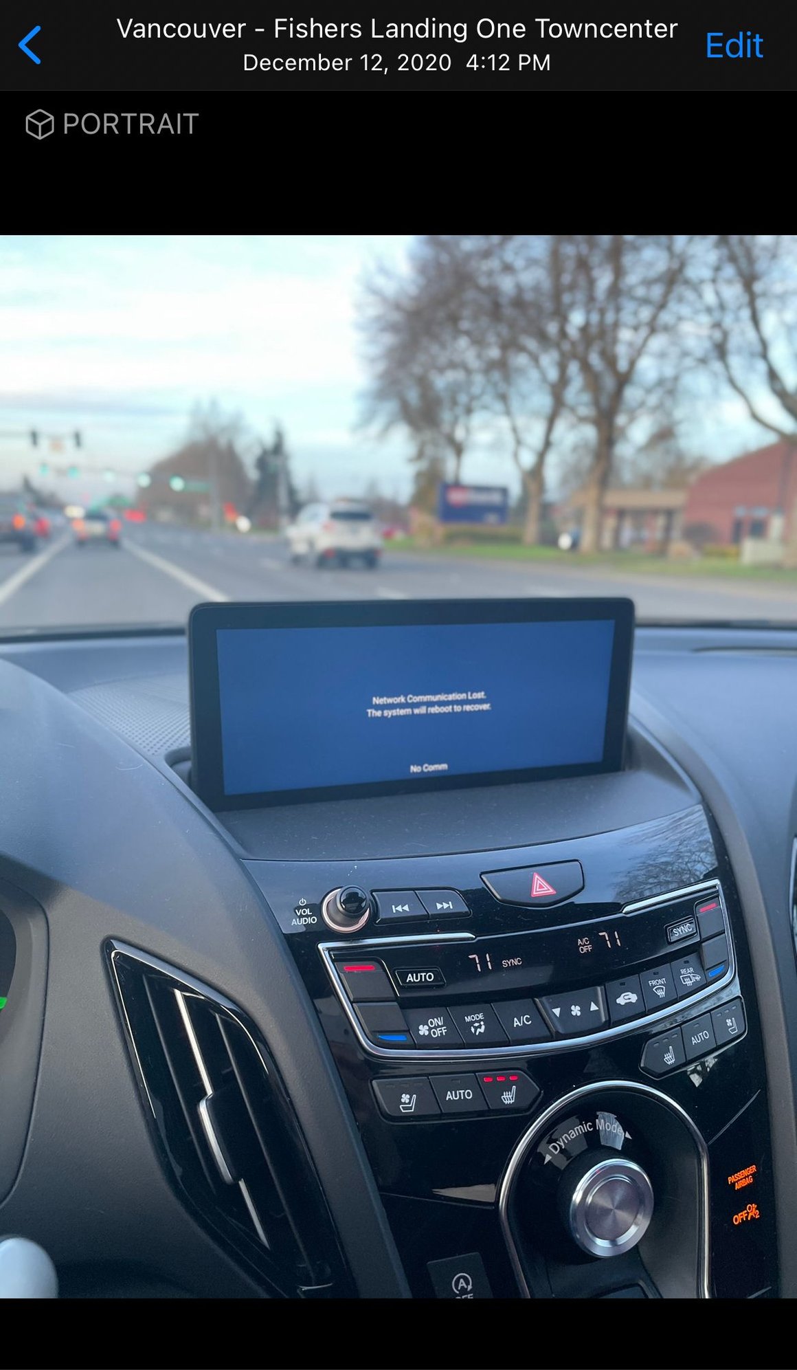

Well sorry to report the most recent software update doesn’t solve infotainment issues. I updated on Monday, drove very briefly Tuesday, not at all yesterday, but today the infotainment system reminded me that my 2019 RDX Advanced is the worst vehicle I have ever owned!! Speaker crackle, sound in and out, “ No audio connection”, “Network Communication Lost”, and then finally complete black screen. It only came back up when I pulled over, turned off the ignition and restated the truck. However even then, my phone was not operable. I had to forget device and then connect new device for it to work. Good times!!!!!

Well, I did the Factory Reset on the infotainment system, reset all my settings and channels, repaired my phone, and went into the house to continue with my day. When I went to use the RDX a few hours later, once the system booted-up, the sound that came through the speakers reminded me of sitting in front of a fireplace and hearing the crackling of the firewood! Who knew that there was such a nice option with this vehicle!!!
Looks like next step is going to the dealership to to see if they will hopefully do the TBS and see if that helps at all.
I was wondering if anyone here, that has had this issue, has taken their vehicle to Island Acura on Long Island for resolution?
Thanks!!

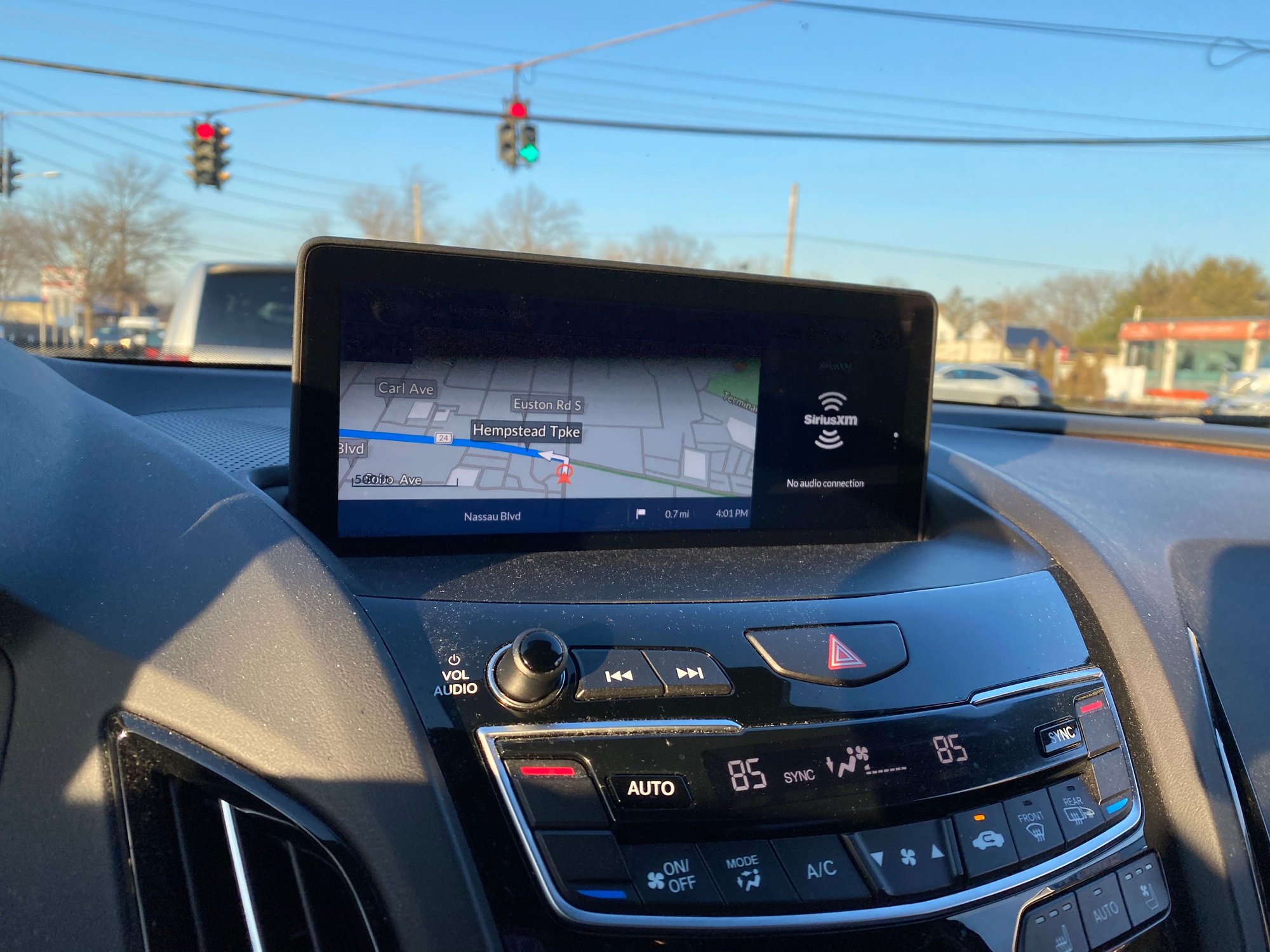

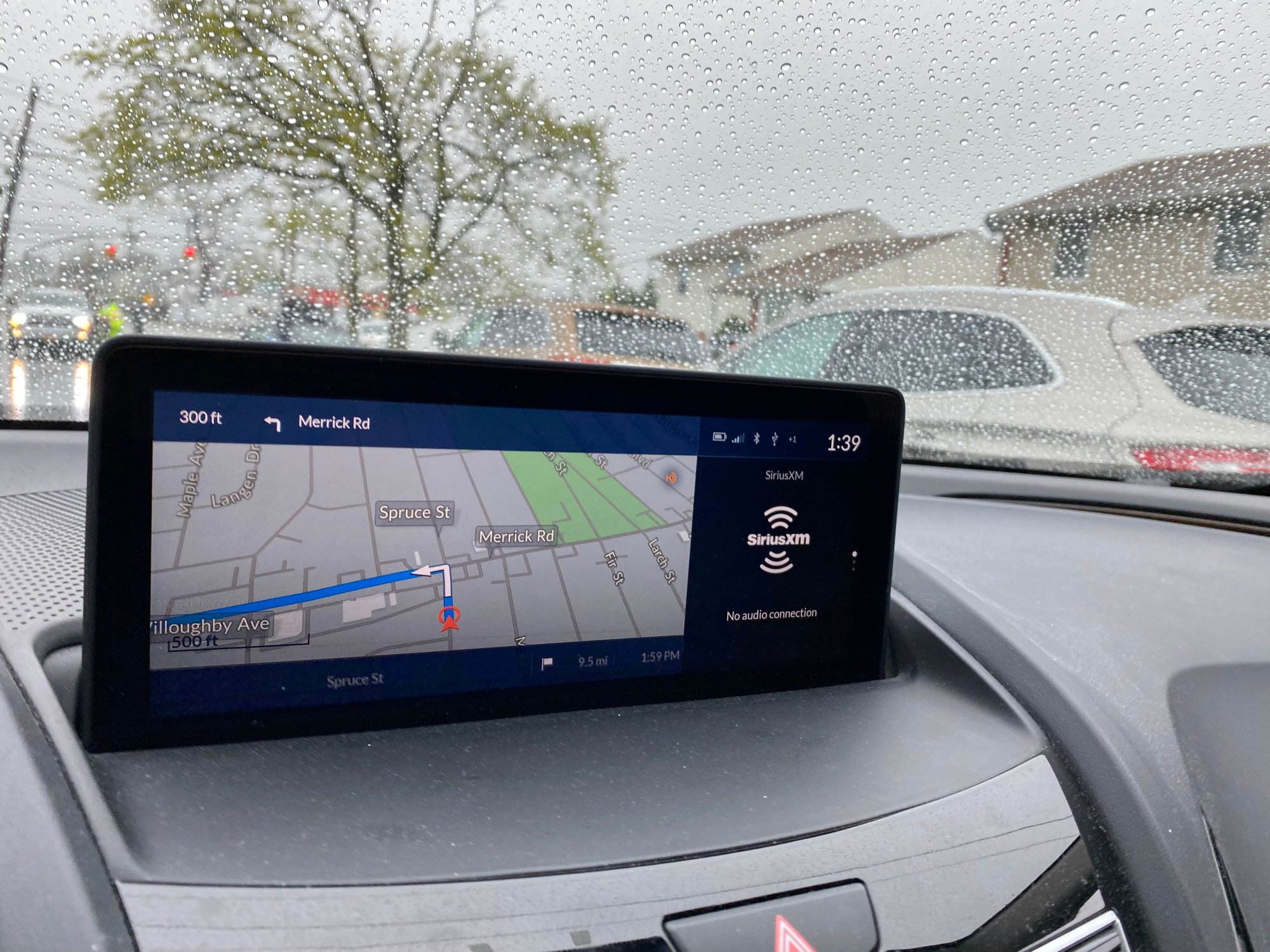

Yes, 2019 Advanced. Had the blue no comms screen one or twice whilst driving. Also had the screen not turn off 2 times after I turned the car off which one time drained the battery and another time, I pulled the fuse in order to get the screen to turn off. I don't drive often, only have 6600 miles in 22 months. Was in for oil change today and they did the TSB when I mentioned the issues. Will see how it goes. Have also had tons of the CarPlay disconnects, usually when I'm in a spot where I don't know where I'm going and really need the nav. For a while, I was putting the address in both the car nav and in the CarPlay (I prefer Waze), so that when CarPlay disconnected, I'd have the car nav as a backup. Crazy. Really wanted to love this car.

So it been two weeks since I brought the car into Acura. Upon arrival the 2 service reps I spoke to did not seem to be surprised at all about the issue. The one that I dealt with was aware of the TSB. The job was done in just over an hour. They replaced “the connectors” as described by the service rep. He said the RDX’s come in “all the time” with this issue and “once we replace the connectors, the issue never returns.”
Well, two weeks later and I have not yet had a single issue at all!! (I’m sure I just jinxed myself) I’m very happy that this seems to have cured my problem. I’m hoping that the rep was right!!

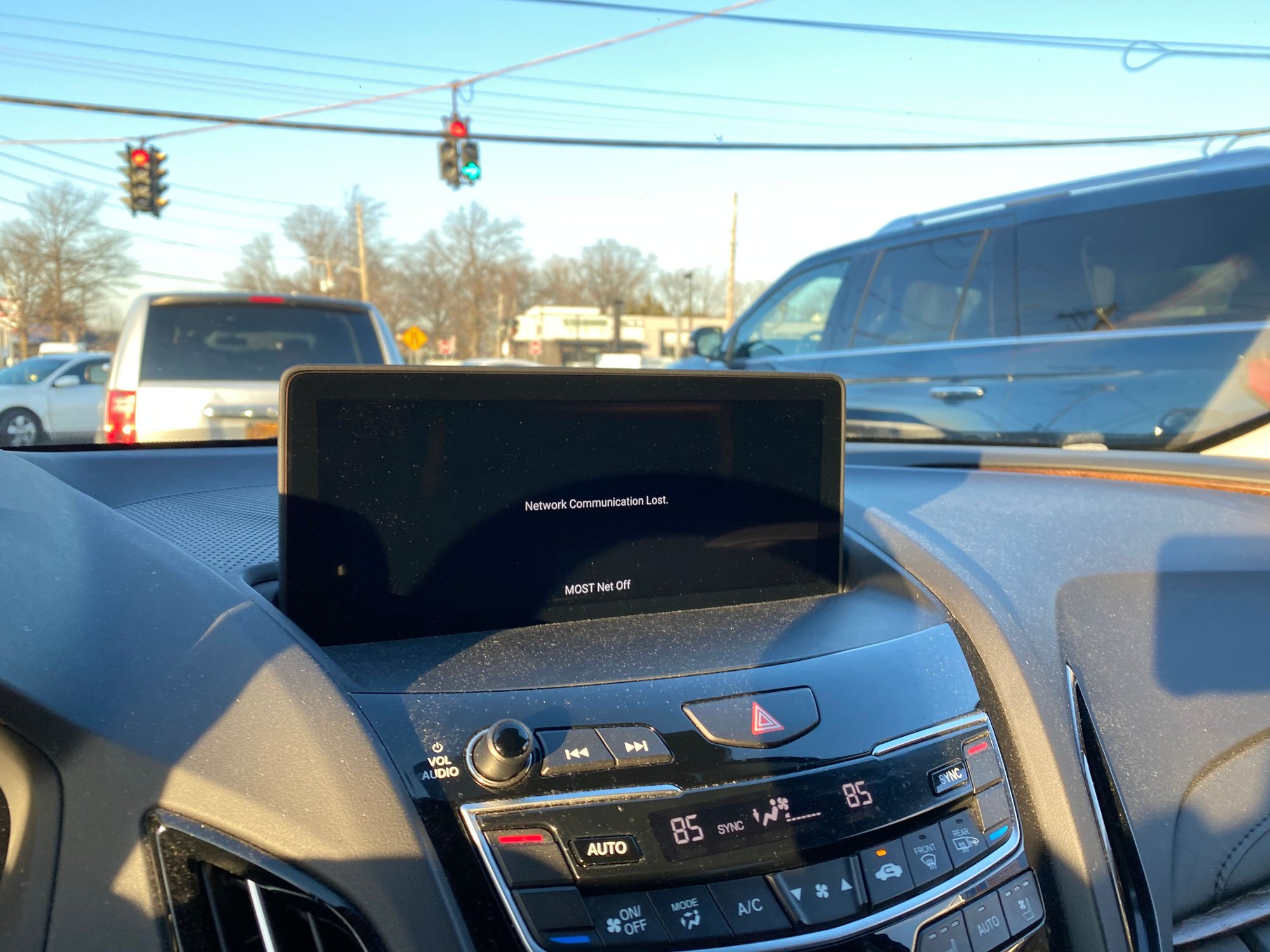

Well, of course I spoke too soon!!!! This was this afternoon!!!!!!!!!!!

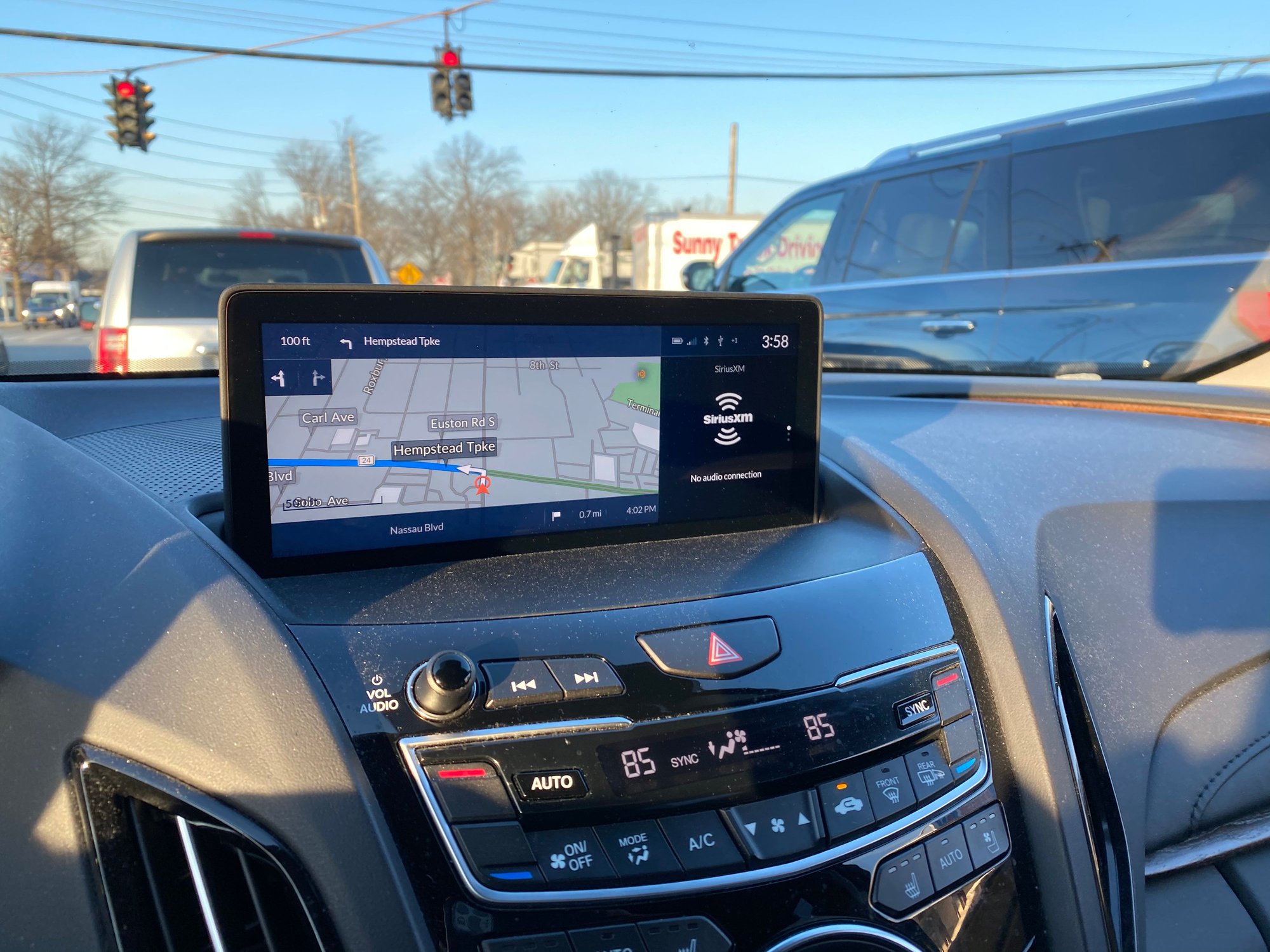

I don't see anything wrong?
Old Apr 16, 2021 | 04:07 PM
  #115
mjcartney's Avatar
3rd Gear
Joined: Apr 2021
Posts: 3
Didn't work for me either.
Old Apr 16, 2021 | 09:00 PM
  #116
tabs31's Avatar
Joined: Jan 2006
Posts: 43
No audio connection.
Old Apr 17, 2021 | 12:02 AM
  #117
sonyfever's Avatar
Joined: Oct 2007
Posts: 1,571
Likes: 552
I don't use SiriusXM, but could it be due to the clouds blocking the satellite signal?
Old Apr 17, 2021 | 06:21 AM
  #118
tabs31's Avatar
Joined: Jan 2006
Posts: 43
Unfortunately no. It crackled as before, audio cut out on every available platform form. Turning radio on and off did not help. I had to resort to the old three finger reboot for the audio to finally return. Bye bye Acura.
