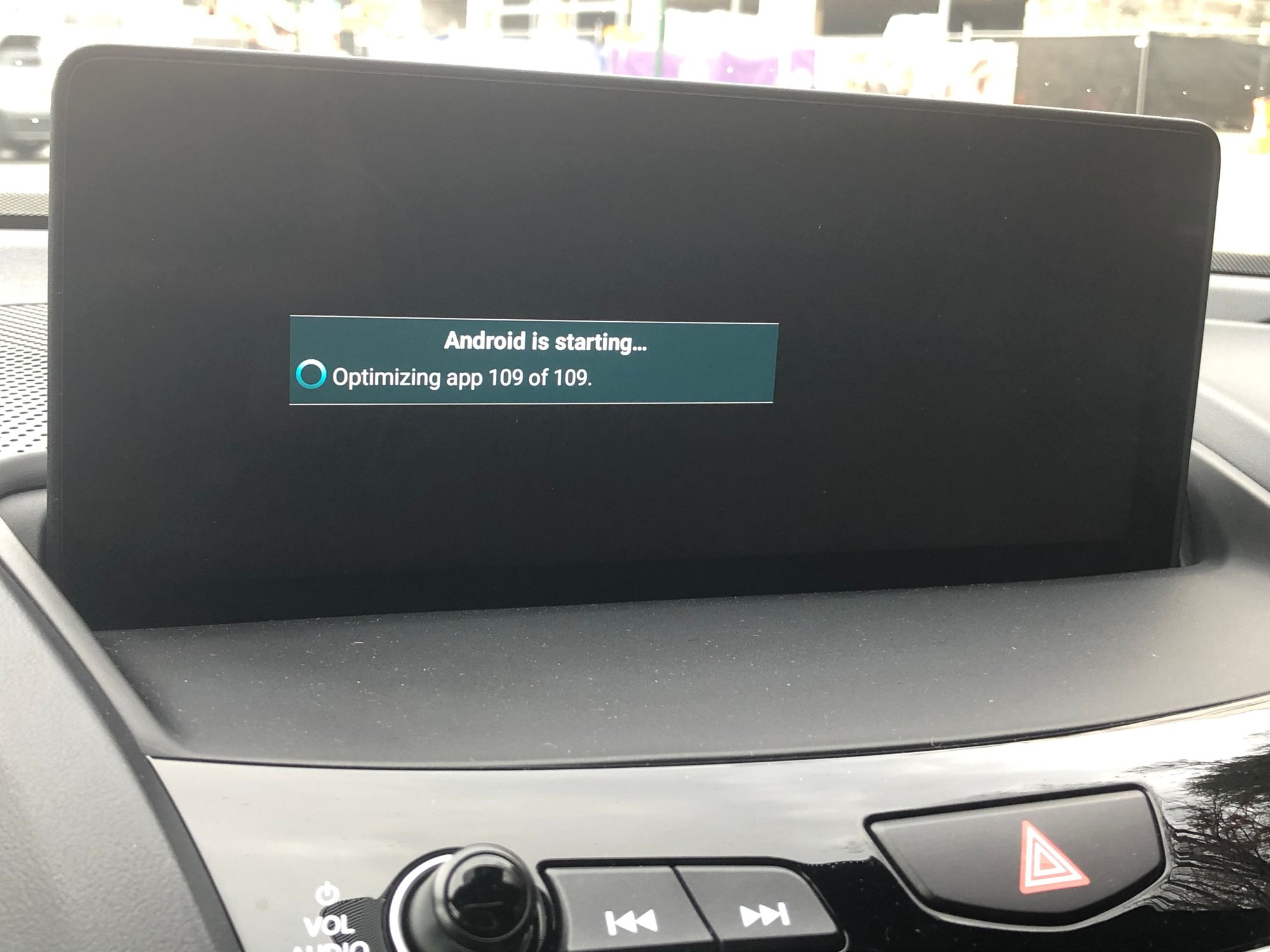

This has happened to me twice now in 2 months on a 2020 A spec. Oddly both times it has happened I’ve been mid-turn, normal driving. Had the annoyingly loud squelch the first time, second time no noise (today). Both times I’ve been connected/listening to music via CarPlay. I guess I’ll have it looked at next time I’m at the dealer, noting the TSB
Also got one of these today (separate drive, see attached). Odd bc I have an iPhone. Took about 5 minutes to load/optimize. I’m guessing I have about 109 apps on my phone(?)
iPhone 8 fwiw
Old Nov 22, 2020 | 07:58 PM
  #54
JB in AZ's Avatar
Joined: Jan 2019
Posts: 2,278
Likes: 805
From: Arizona
iPhone 8 fwiw
The OS in the head unit is Android based.

I never got this screen "Android is starting,..", so I dont know if two problems are related. Get TSB done anyway to rule out stuff. Thats what my dealer told me, they said they dont know if it will help, but before getting any further they need to put it on, and it seems likes its working.
Figured it had something to do with that, but good info to confirm. Thanks.
Good call on the TSB— I plan to get it addressed when I go in for service next... or if the problem starts happening with any regularity. I’m guessing I should delay the install of my newly purchased ignition auto stop disabler for fear of the dealer saying “what the [heck] is this?” No reason to risk them even trying to deny warranty service— I don’t even want there to be a debate.
At least there’s a possible fix for this problem.

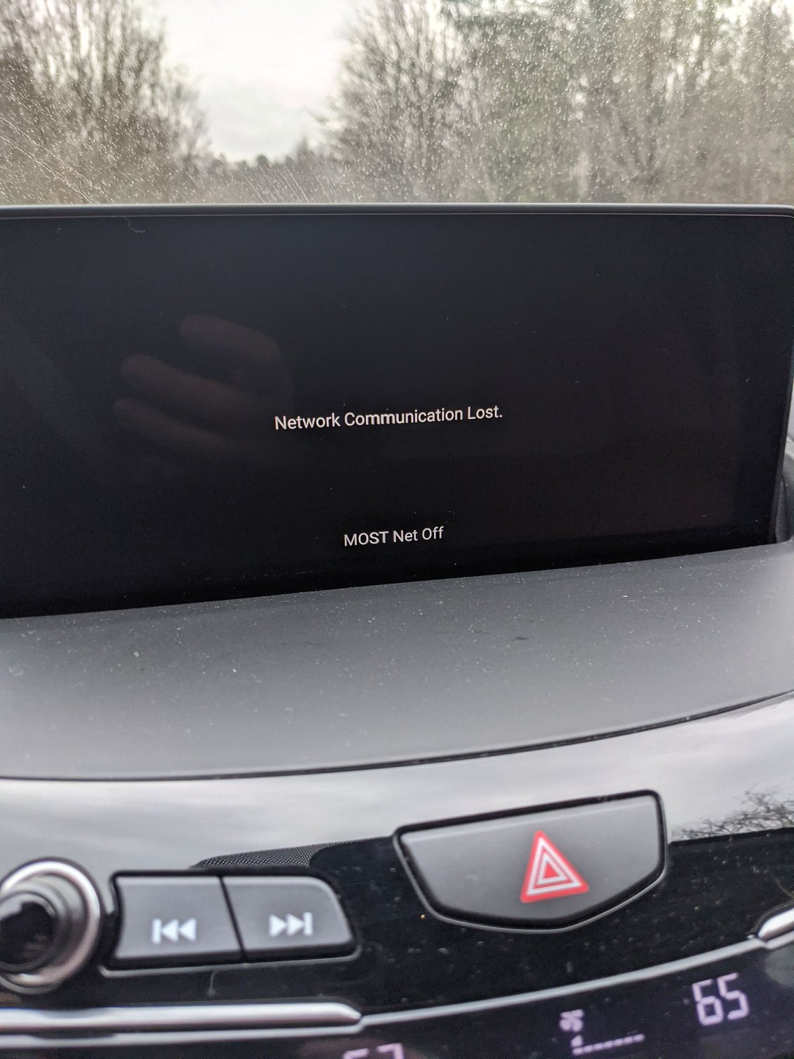

Update on my post from last week. Took my RDX in today. Showed pictures I posted here last week to the service tech. Also brought a copy of the TSB 20-031. Service tech was familiar with the problem. He said it was a pain to diagnose and fix when the '19's came out because they had no idea what exactly was happening, but they've seen it 3-4 times now and know how to fix it. That's what he said anyway.
They ran a diagnostic on it and said the diagnostic did not show it was the TSB 20-031 but a "different one". He said they would have to pull apart the dash and replace some "connectors". It was about 3 hours to do that, change my oil and rotate tires which were due. Had to kind of take their word for it that it's fixed. It has not happened again since it happened on Christmas Eve. I guess time will tell.

I got happy too soon. Today for the first time in 6 month after TSB was done I got the same exact issue while listening music through Apple Car Play. , loud beep, blue screen with "network communication lost" and reboot. Back to normal.
I used to get it couple times a week, so definitely TSB did something as I have not seen it for 6 month. Went into diagnostics, same hardware error code for MOS COM as I was getting back in July.
I wonder if after 6 month those connectors deteriorated again, or got louse. Will see if I keeps happening again,
Are these connectors made from glass? The most bus issue is not unique to RDX, also appears on a few Honda products. The bus is digital, so if the connection is unstable the issue should appear rather frequently.
Old Jan 3, 2021 | 08:10 AM
  #79
russianDude's Avatar
Joined: Jun 2001
Posts: 6,921
Likes: 848
I thought it would only happen on bumpy road, but I am not so sure anymore. It seems random. When it happened last time I was on smooth road. Has not happened again, even on bumpy roads.
there is a hardware error code logged for communication lost, but dealers never check for it, they only look for shutdown reason which is none. Will visit dealer if happens again, want to see how often it happens
Old Jan 3, 2021 | 08:27 AM
  #80
kboo74656's Avatar
Joined: Dec 2018
Posts: 701
Likes: 202
From: Hampton Roads Area, VA
Could you take a pic of the hardware error code and post it??
