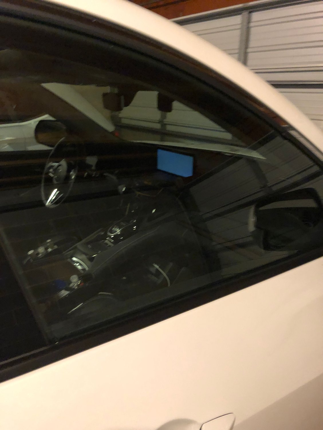

I recently acquired a 2022 Advance, nice car so far.
That said, has anyone experienced the following issue where the display screen turns on/backlights ever so slightly when you open any of the doors? Mind you, car is not on, only recently unlocked.
I’ve had to run out to the car twice to grab something out of the glove box, open the passenger door, display lights up. And when I shut the door and lock it, the screen stays backlit. Turning the car on and off fixes it and it shuts it off.
